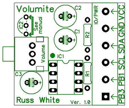

I was enquiring about the footprint of the "cool little gizmo" that implements the digital volume control.
I'd appreciate an answer before I start drilling and punching the chassis.
Thanks.
The board itself is tiny with an onboard pot, which provides the mounting mechanism, so you just need a front-panel hole for the pot. This is the pot we are planning on using (metal bushing version): http://www.panasonic.com/industrial/components/pdf/aok0000ce4.pdf
Would there be any problems with air-wiring the pot? I don't think I have even 1.3" at the front of my case......

Beefy said:Would there be any problems with air-wiring the pot? I don't think I have even 1.3" at the front of my case......
Oh, and any hints when the SPDIF MUX manual and/or boards will be available?
You certainly can air wire the pot. Should not hurt a bit. You could then mount the board to your case with double side tape or something
