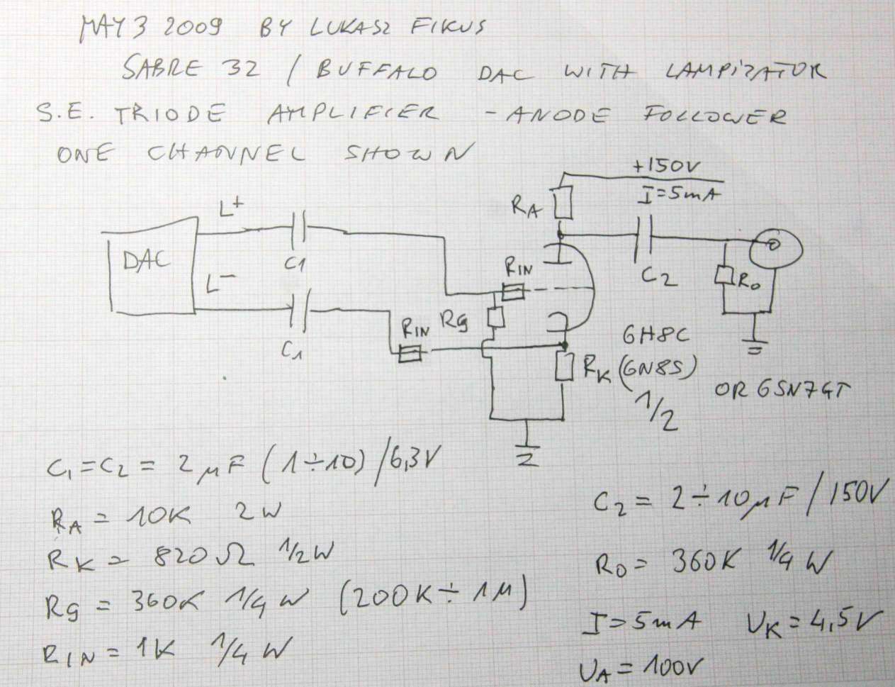

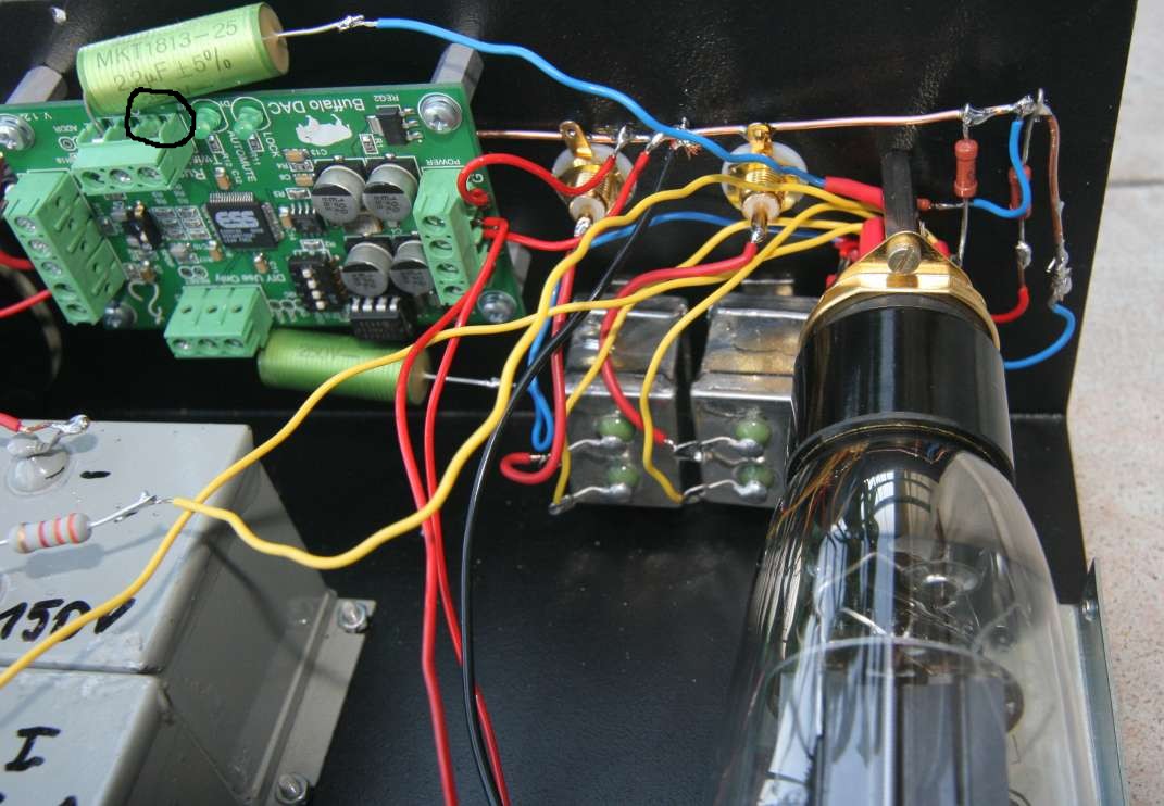

I just purchased the Buffalo DAC board and is expecting it by Sep. I am also very interested in the Lampizator output stage but I have some questions: -
The circuit shows two 2.2uF connecting to the tube on each channel but if you look at his picture, it only shows 1 cap connecting from the DAC +ve output to the tube output stage. I cannot see the -ve connection.
Do I need to connect the ground from DAC board to the ground of the output stage?
Did anyone tried the Buffalo DAC with Erno's 437 I/V stage? How does this sound?

I just received an answer from Lampizator regarding his tube stage for Buffalo II - take away the output from -ve completely.

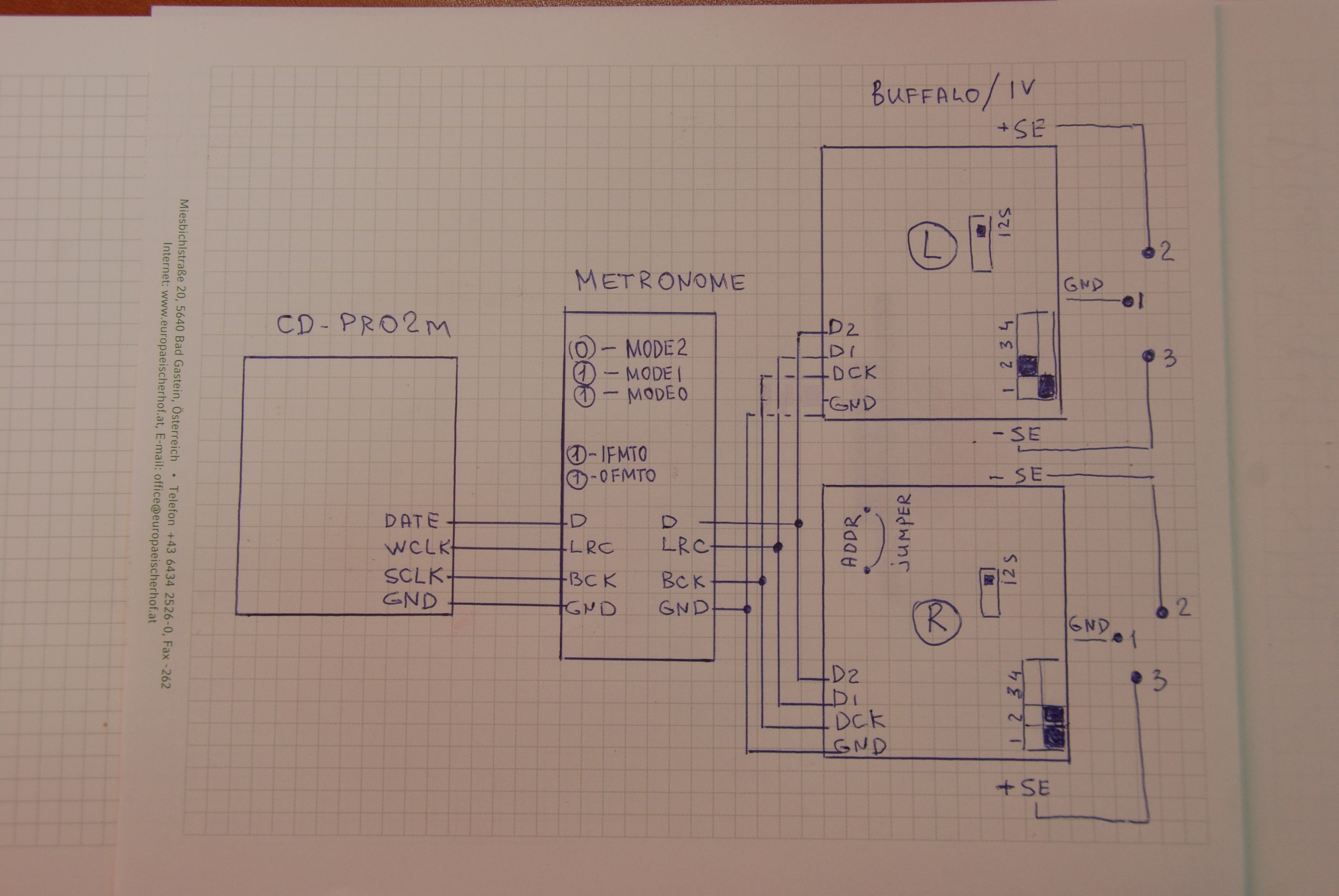

We finished with Buffalo II Dual-mono variant CDPRO2m I2S.
Connections we made after as it is in the picture.
But I signal distortions ...
Stereo version I tried (one DAC) but everything is distorted.
I haven't use Volumite , we used a Aleph P1,7 as preamplifier.
I tried SPIDF version and everything is OK, but I have problems with I2S: 🙂 (
If using Volimite, must remove both chips?
I mean, one of Buffalo PCB (Left) and another from Buffalo PCB (Right)?
Please help me very much 🙂🙂

1. Yes, remove both firmware chips
2. Did you receive the new firmware from Brian? The old one will not work properly for the right channel.
3. I had the same problem, try stereo mode and switch the IVY modules between the DACs. With me it turned out the opamps weren't soldered correctly to the PCB on one IVY (propably transport damage), but it's a pain in the ... to get that right after building it. I eventually ordered a new module, still waiting for it.

Here is something you folks with volumite or any other I2C controller for the Buffalo(or Buffalo II etc).
You can never connect two devices with the same address to one single bus master(controller). You must either give both devices different addresses, or use two separate controllers as bus masters.
I am sure Brian will get the firmware out to you folks that need it. Please be patient with us. Brian has been swamped.
