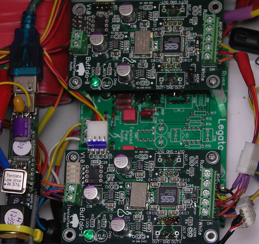

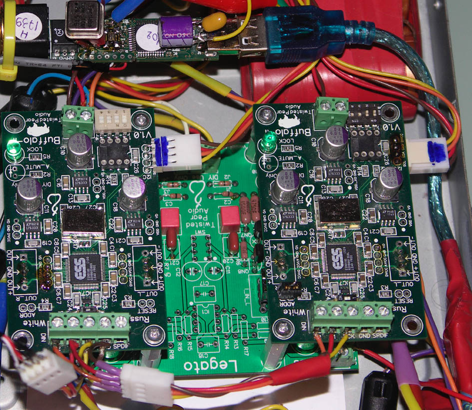

Buffallo Dual Mono 1 Legato
Hi
I haven't seen this configuration beffore so I decidet to post this one
Reading Russ posts in Legato vs Ivy thread, he mention that this kind of configuration can be done.... so ...Yes He was right....
Dual Mono Buffalo with single Legato ....😀
And of cause all 16 DAC are working in 1 chanell ....
I do not have 2 Legato to make any comparisions but this is definetely better than Stereo Buffalo-Legato setup....
So this is the best Buffalo I have heard..now...😎
Just to make things clear, output from Legato goes to Lundahl Trafos..so no OPAMP mounted.
And there is HiFace with TentLabs Clock .... 😛 and I2S taped to Buffalo.
I hope some folks will find this setup interesting ....

Legato power supply: jumpers are soldered there, so only one power supply for both channels, right?
How have you connected both current output legs of each buffalo pcb to one of the legato inputs legs?
Is it just a jumper wire from one buffalo output to the other buffalo output?

Hi
This is dual mono configuration .... each DAC work for one chanell, but instead using 2 x IVY or 2 x Legato, I'm using 1 Legato and this requires of cause summing up each DAC Right and Left currents/outputs into one Legato Chanell.
Using TP duall mono Volumite firmware L and R DAC chanels are oposite phases so all You need to do is just connect Buffalo L and R outputs but in oposite phases ie : L"+" with R"-" and L"-" with R "+". And this goes into one Legato chanell.
This is the way to get 3dB extra DNR from gooing duall mono...and reach 135dB DNR ..or something close to that ..😎..
And for better chanell separation of cause separate Power Suplly for L and R Legato chanells would be welcome..

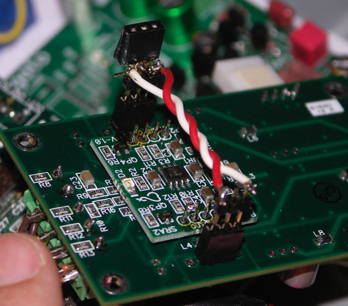

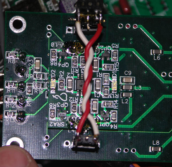

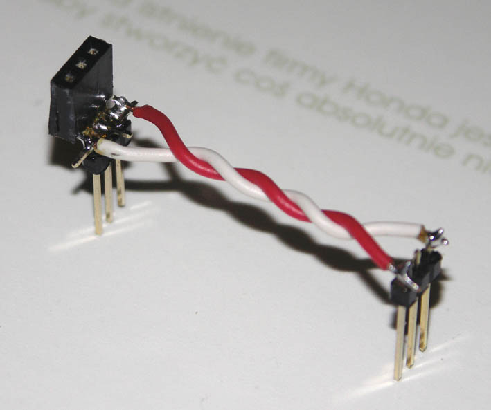

Hi
As for drawing this could take bit time but I'm sure that my pictueres will explain everything.
As I've try to explain this is wery easy and straightforward connection. With my "Dual Mono Special Connector" ... I can use oryginall Legato-Bufallo mounting hols and connectors, so no soldering at boards required...😎
This is very nice and simple solution and it works very well no doubt about this. The only question is if this is better that 2 Bufallo and 2 Legato...
Actualy this is Russ idea so some input from his side would be nice...
One remark if someone is going to try this, Please first check that DAC are really working in duall mono before making output connections...😎
And to my Polish connections at other side of Atlantic... Anand bardzo dziękuję za miłe przyjęcie ..🙂.
If drawing is still needed let me know...
Rosendorfer

Thanks, Rosendorfer. Those are very enlightening pictures. No need for drawings.

Rosendorfer,
Thanks for the pictures. I had to review your first picture on this thread to understand what you have done. I am going to try to explain it in words.
Okay, the assumption is we have two Buffalo II modules and one stereo Legato module.
With the first Buffalo II module, locate the OUT_L outputs. From here connect a wire from the negative pole (-) of the OUT_L output to the positive pole (+) of the OUT_R output. Do the same with the positive (+) pole of the OUT_L output to the negative pole (-) of the OUT_R output. Ideally these two wires should be twisted.
With the second Buffalo II module, locate the OUT_R outputs. From here connect a wire from the negative pole (-) of the OUT_R output to the positive pole (+) of the OUT_L output. Do the same with the positive (+) pole of the OUT_R output and connect a wire to the negative pole (-) of the OUT_L output.
Next, on the Legato board locate the I_IN_L and I_IN_R input holes. You will see there are corresponding holes marked positive (+) and negative (-).
Next, use a 3 terminal connector as shown in Rosendorfer's previous posts so that the OUT_R_OUT+ connects to the corresponding Legato board where it is labelled I_IN_L positive (+) hole. Do the same with the OUT_R_OUT- connects to the corresponding part in the Legato board where it is labelled I_IN_L negative (-) hole.
Do the same thing with the other Buffalo board as above.

As for the grounds they are of cause needed and used.
At Buffalo DAC PCB there is one Ground plane, the same for Left and Right output chanell so there is enought to connect 2 wires between Bufalo outputs. Like on my connector, ground is already at Buffalo PCB. But at connection to Legato You have to use 3 Pin connector with Out+ Out- and Ground in the midle. Exactly as in normall stereo connection.
Hope this is clear.
