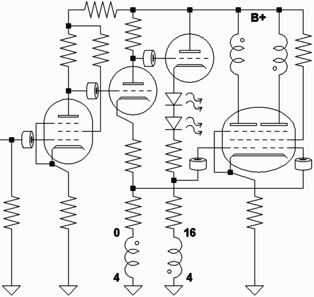

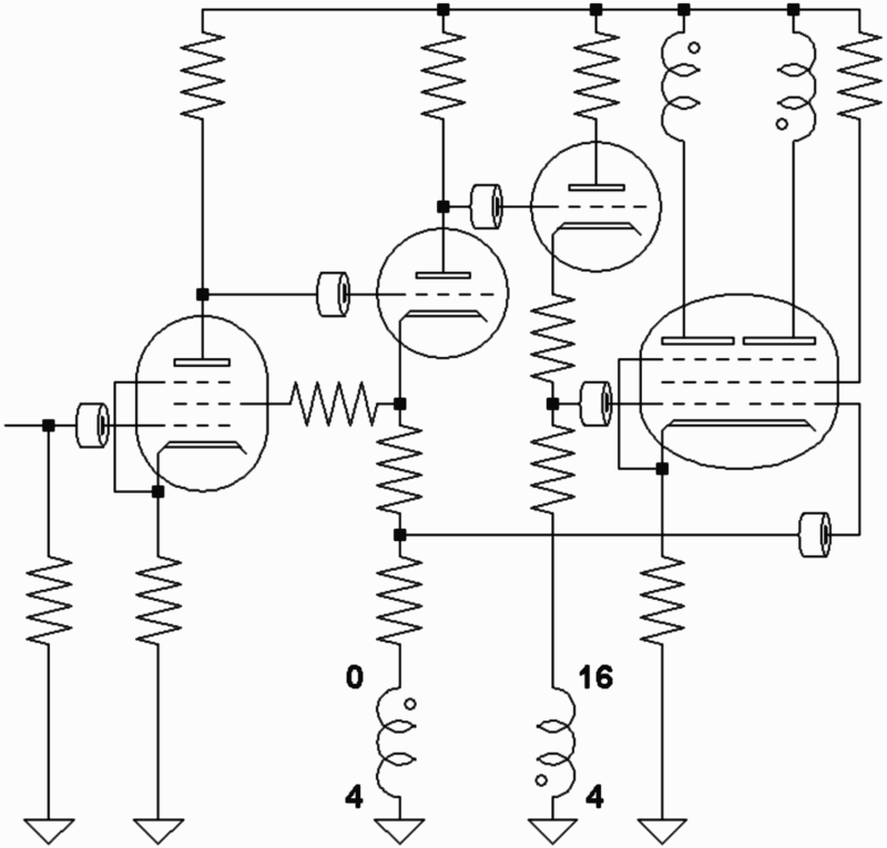

Here is a more classical construction using 2x6L6 in the output, 2xECF80 in the front end - this could be directly adapted:
http://www.dissident-audio.com/PP_6L6/Sch-V21.gif
Throw a couple of local feedbacks at the
basic concept without changing too much.
Cathode resistor for the input Pentode.
Followed back with Cathode to Screen.
If strong feedback from the cathode kills
too much gain, you could tap the middle
of 2nd triode's plate resistor instead...
Schade's "plate to grid" for both G1's by
way of transformer secondaries... Which
might also help to linearize the iron.
And the common output cathode resistor
helps balance out any difference in drive
strengths, which is also a form of local
feedback. Though not truly "negative".
2nd Cathodyne drives from a higher DC.
Might need some diodes or whatever to
drop it down equal...
