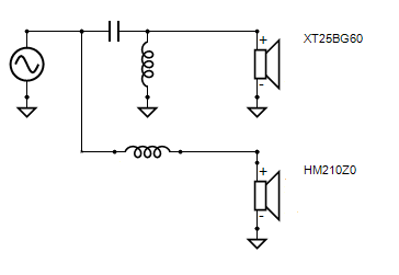

I refer to post 131. Re my audax project: Awell respected diy hifi dealer in France proposed me a 2way Audax HM210Z0 coupled with Vifa XT25BG60 crossed at 2200Khz in a folded horn using the attached xover ( keeping the components values secret) .
Also in a 1996 french magazine Le Hautparleur proposed then a kit Audax HM210Z0 + Vifa HT270 (now Peerless D27TG-35-06) with the woofer hooked 1st order with 0.68mH inductor and tweeter using 3rd order. What do you think about the tweeters matching and which one is better for this project and if the 2200kHz crossing ok?
Here is the xover schematics for the first project.

If you want opinions about the Audax driver, you should start a specific thread, here you may not get many opinions.
For any 8” driver I’d cross lower, simply for directivity reasons. For best results I’d opt for a sub 2KHz crossover.
