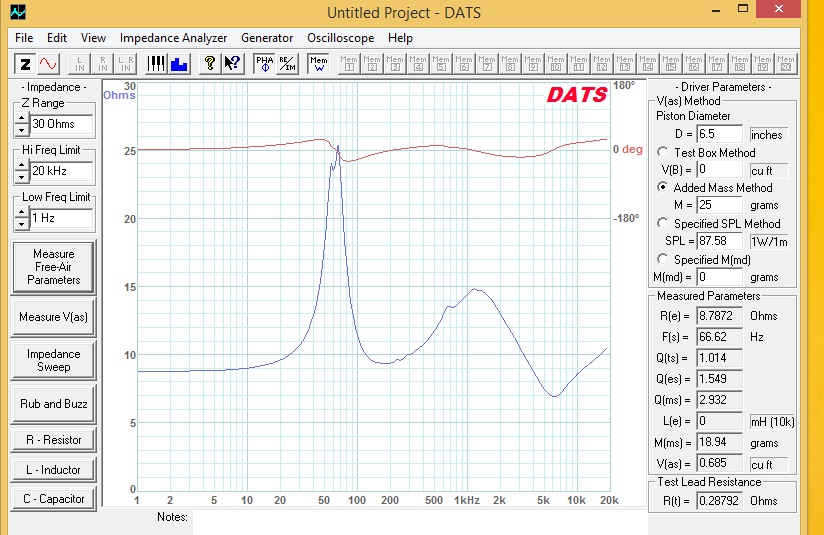

These do play pretty loud and stay ~ clean.
I surmise it's the cone material ?
