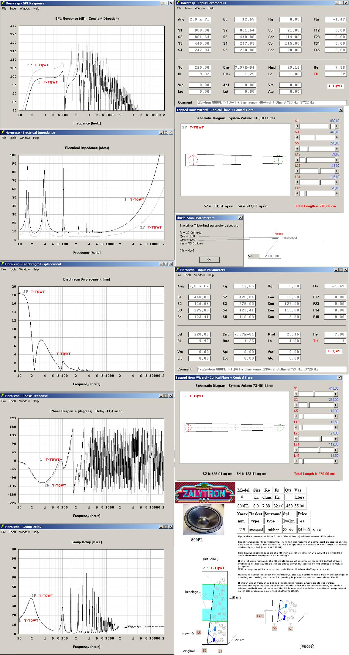

FYI, It looks like the Zalytron drivers perform well in a T-TQWT too, if my T/S parameters is ok, of course.

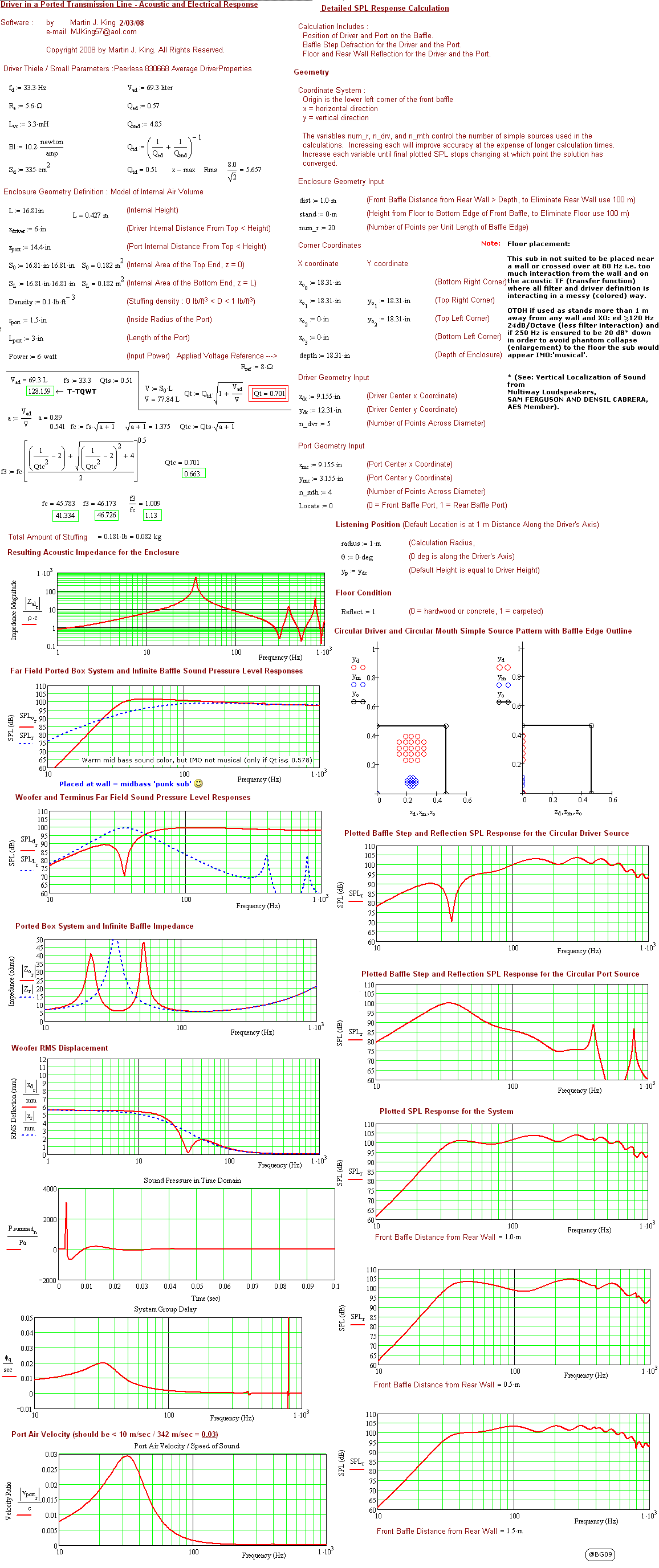

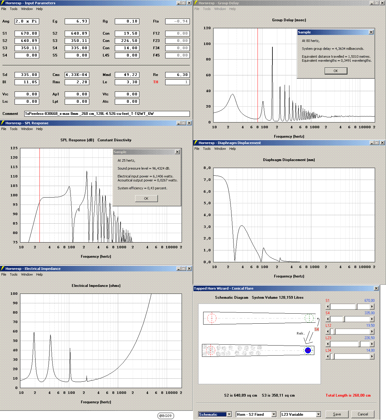

IMO, You are pointing at a driver not well suited for a ported box unless the driver seen Qt is less than about 0.65 or if an aperiodic box is designed.
Here is a T-TQWT design I believe is ‘musical’ if properly stuffed and if placed next to a wall: See the first picture.
If Peerless 830668 is put into about 2.75 cubic feet ported box: See the second picture.
