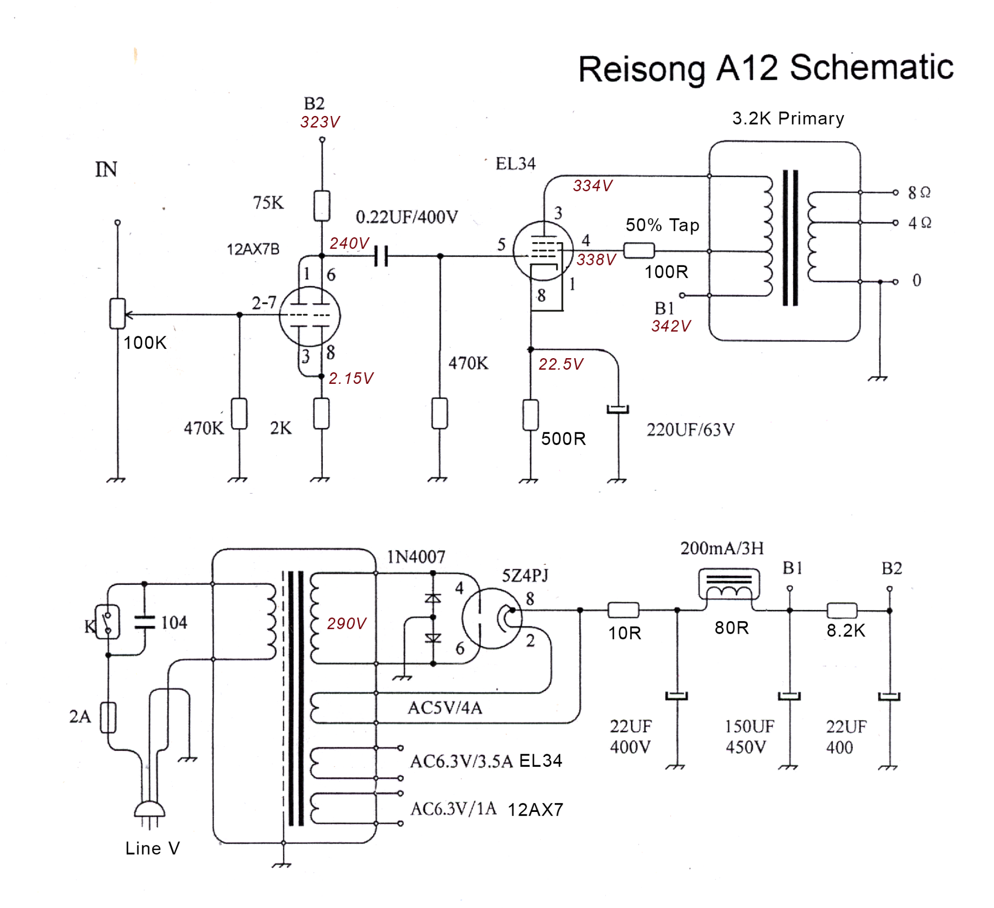

I have no clue about global negative feedback and would need to learn more to be able to answer from the schematic.

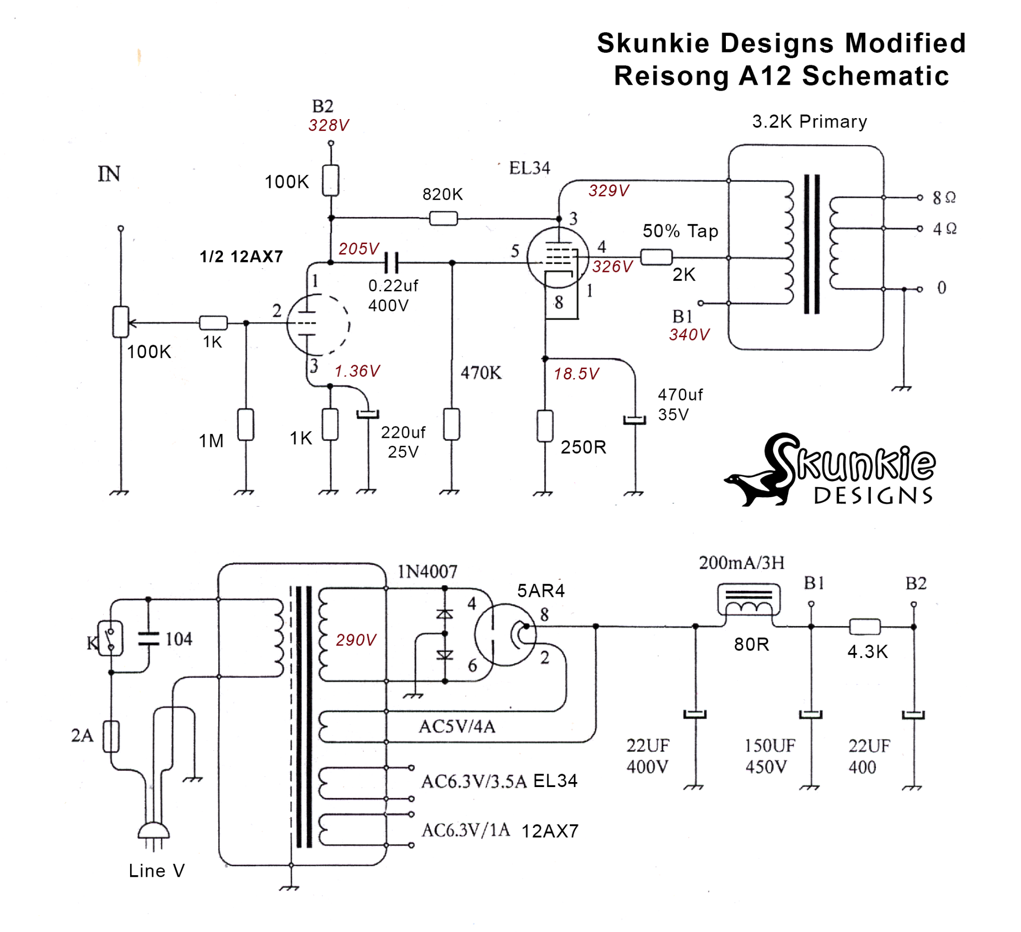

In an attempt to educate myself I've been reading the past couple of hours and have at least come across some answers to y'alls questions.
This thread has a more granular description of the mods I was speaking of before by the person who posted the youtube videos I saw. It's a long read and I don't expect anyone to actually read it, but it's been interesting as a complete novice with this stuff.
There is apparently no negative global feedback. Skunkie was nice enough to include before and after schematics of all the mods. I obviously don't (yet) understand the theory behind them, but I do trust the measurements presented in the videos and the thread. As far as speaker selection I'm still in the weeds but it will get sorted. I havent mentioned yet but I broke my heel bone a couple weeks ago, so I have much more time to read/research than I'm normally used to 🤣

First thing i notice in the maps posted was the loss of the paralleled ECC83, my next step would be swap it with somwthing beefier,
Replacing at least the last capo in the PS w a poly also

In the original amplifier, the biasing is completely screwed up - one should follow the operation point recommended by data sheet, which the designer didn't do. That's why the amp has terrible distortions and low power output. Skunkie corrected the op. point - this should bring real improvement.
The amp doesn't have global NFB. UL connection provides some local feedback, which gives damping factor of about 2, not good from standpoint of electric damping. Skunkie adds another local feedback, a resistor from EL34 plate to 12AX7 plate. This is called Schade feedback. Together with UL, it will bring DF to something like 4-6. In enclosure design, real Qe will be a little more than in data sheet.
Skunkie mod or alike is a must for this amp to have acceptable performance.
