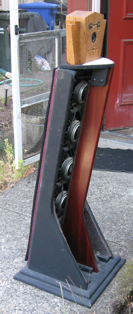

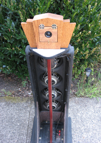

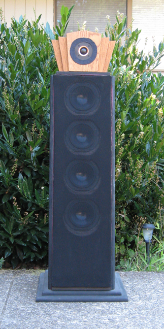

You might want to consider an arrangement that has the mids and ribbon side by side. Since both are dipole, this will take some thinking. I started with a Newform Research R645v3 and replaced the bottom cabinet (2 scan speaker 6.5 inch drivers) with a short array - 6 x 6.5 inch drivers - of about equal height placed right next to the ribbon driver. This was definitely an improvement. You seem concerned about integrating the mids with ribbon...doing an over / under arrangement might work against you here.
A vertical array of 6 inch drivers would be more directional on the vertical axis. In that way, it would merge better with the vertical ribbon, than if it were a single driver. If the 6 inchers are baffled open-back, be careful not to build a baffle that will have significant "cavity effect" on the back side. It can be a little tricky. Many OB's out there screwed this part up. Side panels shouldn't be more than 3-4 inches deep.
I'll attach a photo of how I did my OB's, which have four 5 inch drivers on each side doing 100HZ - 1.4kHZ. My front panel is 1.5 inches thick of MDF, with successive routering on the backside so the driver air can get out easier. Solid oak is recommended for side panels, even though I used MDF. I also angled the baffle by 10 degrees to further reduce floor bounce, and align the driver diaphrams relative to the listeners ears (somewhat), so phase is less of an issue. Notice the corner braces on the back side, in the corners. They are there to help the rear energy get dispersed with minimal cavity effect on the back side. I added that rear "fin" or what I call a waveguide, to diffuse the rear emission better, so angle of placement isn't so critical.
My side baffles will be 1" - 2" max deep. I am thinking of adding a seperation baffle between the ribbon and the midwoofers. This could be around 3" - 4" deep, but will have carpetfelt on it to reduce reflections.
I like your speakers. They look really cool. 🙂 As far as the corner braces go, I have been thinking of putting something like 1/4-rounds in there, or maybe something similar. Maybe just triangular fill in pieces, but something to break up the corners. I also want to damp a lot of the rear panel with carpetfelt to reduce reflections as much as possible. And I really like your fin idea. 🙂
