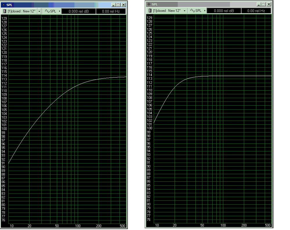

You obviously know a lot more on this subject than I do... as you say, one way of looking at the effect of a LT circuit is that it modifies the driver Qts and Fs.
Another way of looking at it is that it is an EQ circuit that applies a gain pattern to the input signal tailored that a specific driver.
You said that as the drivers are low Qts they will need EQ to bring up the bottom end.
If I find an EQ circuit that happens to provide the gain pattern that I need then why should I not use it?
As I said, you know more about this than I do so perhaps the only reason is that it is hard to get a LT circuit right and a simple EQ is easier.

In the 9 yrs we've been running the IB forum several hundred people have built IBs, to date none have felt the need for an LT circuit.
Once you get your IB operational, run a set of measured frequency response plots, then you can decide whether or not you need an LT circuit.

I did some sims, and for 32 of the 10" s above had about the same max output as two 15" tempests and about the same cost. The main difference was in efficiency, so > 10x amp power is required!
Your comments about distortion levels make sense to me, I think I can live with the lower efficiency. Fewer drivers make for an easier install too. I'll check out the peerless drivers you mentioned when I get the time... who sells them here?
