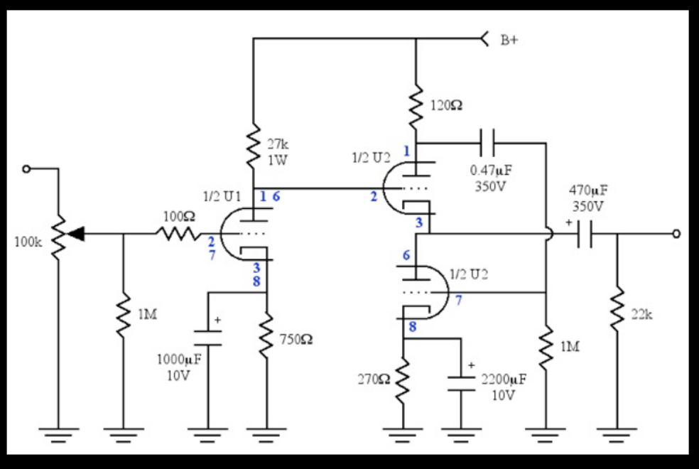

I really like Pete's "Starving Student" design

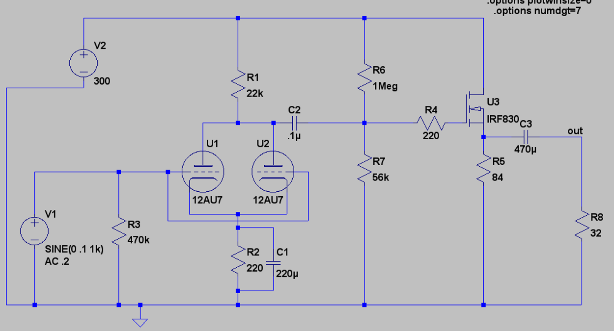

I will draw up some different topologies including an SRPP before I set anything in stone. The SRPP will likely have an output impedance of around 3k using a 12AU7, not good enough, maybe with feedback it will be lowered but I doubt I will get below 3 ohms without an OP transformer. Besides, looking at Pete Millets SRPP headphone amp using Sowter output transformers and B+ of 300, the Starving student amp gets lower distortion figures with a B+ of 48V😎 This is why I am leaning towards the Starving Student design.
Here is the revised edition of what I have so far. I only have some IRF830's on hand so I modeled them. *Note: The 84R source resistor is the series 12AU7 heater elements.

My 'Improved Tube Headphones Amp' is the Pete Millet design with NFB. From the cicuit you posted it would appear that the starving student gets lower distortion figures simply because it has a semiconducotr output stage.

I simulated this the other night. The output R is indeed close to 3K because with a 32 ohm load the output drops by 20dB. The distortion is around 10% at one volt rms output which is par for the course for the 12AU7. With a CC first stage the overall gain is close to unity so there's not enough open loop gain to add NFB. To make it work would probably need the cascode first stage but even with 20dB of NFB the distortion would still be around 1%. You really need a valve with a lower anode resistance.
