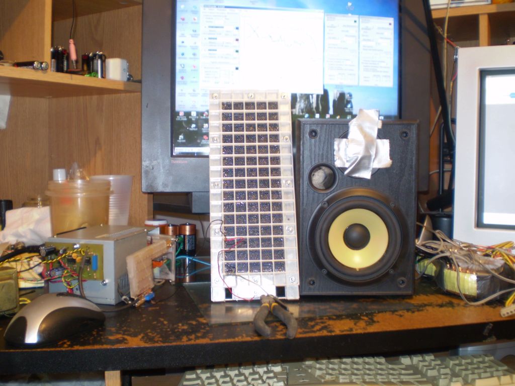

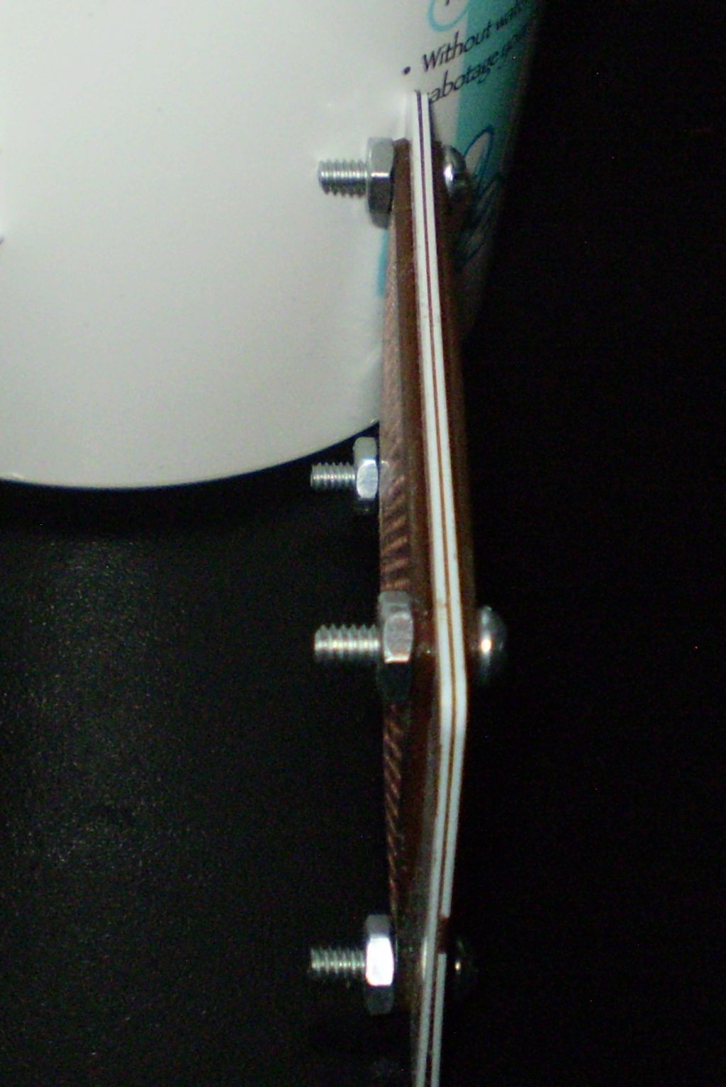

Looks good I think that you should be able to get down to around 300hz to 400hz maybe a little lower.
This is considering it is mounted in a frame with a 1" wide border.
My only concern is what are you going to drive it with?
Your area is about 10% less than 3 of my little panels.
It took all three panels to closely match the efficiency of my 5.25" woofer.
The details are a little vague as it was two years ago but some were documented in one of the threads.
I will try do some tests to get some exact figures for you.
I do know that I was possiblily using turns ratio of around 1:200 or higher and a Bias voltage of 5Kv or so to get there.
This was about 150pf of panel capacitance + about 600 pf (average) of transformer and a 1:100 ratio will present a 1 ohm load to the amplifier at 20Khz.
According to Bolserst if you used the Antek transformers,their capacitance is a bit on the high side of 1000pf although they have been used with great success with larger panels.
As an example your panel will have around 150pf and the antek's will have around 1:74 ratio,So with the added capacitance this come out to a 1.26 ohm impedance that the amp will see at 20khz.

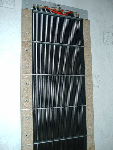

If you doubled to length to 36" this increases the efficiency of the panel by 3db.
And yes this doubles the panels capacitance but only drops the impedance by a small margin due to the high capapcitance of the transformer to 1.117 ohms at 20khz.
But,since you have an increase of 3db in the panel efficiency the amp has to produce only 70.7% of the voltage ( or half the power) to produce the same SPL as that of a panel half its size.
A lot to gain for such a small decrease in impedance this makes it much easier on the amp although you still need to have an amp that can supply that kind of current should you want to crank it up once in a while.
Now for example you were to increase the area by another factor of 4 this would give you a total increase of +9db from where you started with your original size.
Let's say this is +10db increase and that is the difference between 1watt and 100watts of driving power for the same amount of SPL.
Lets see what happened to the impedance,
Our capacitance would now be 2200pf and this equates to .66 ohms at 20khz but if you include a series resistor of 1 ohm, this is now 1.66ohms that the amplifier see as a load.
But with the 10db( or 9db in our example) increase in panel efficiency the amp only has to work 1/10 as hard and has plenty of room to make up the difference of the added resistance should it be used.
This why surface area is so important.

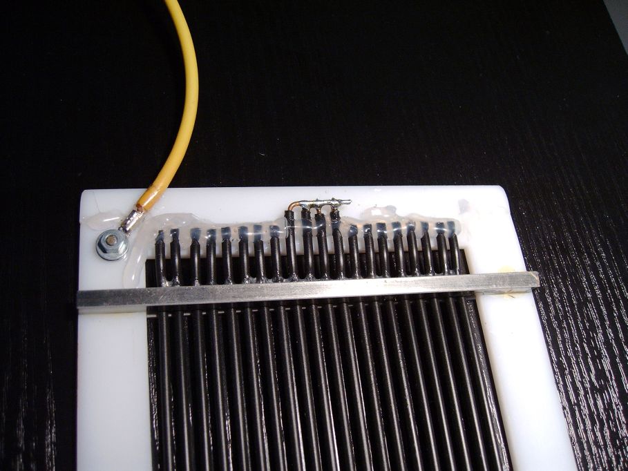

If you plan on pursuing the winding of your own transformer then this can greatly reduce the transformer capacitance making it much more efficient to drive smaller panels.
This is where I am at right now.
So I am sorry to say that I don't have recipe to go by as of yet to build one.
But it is something that I will be working on more.

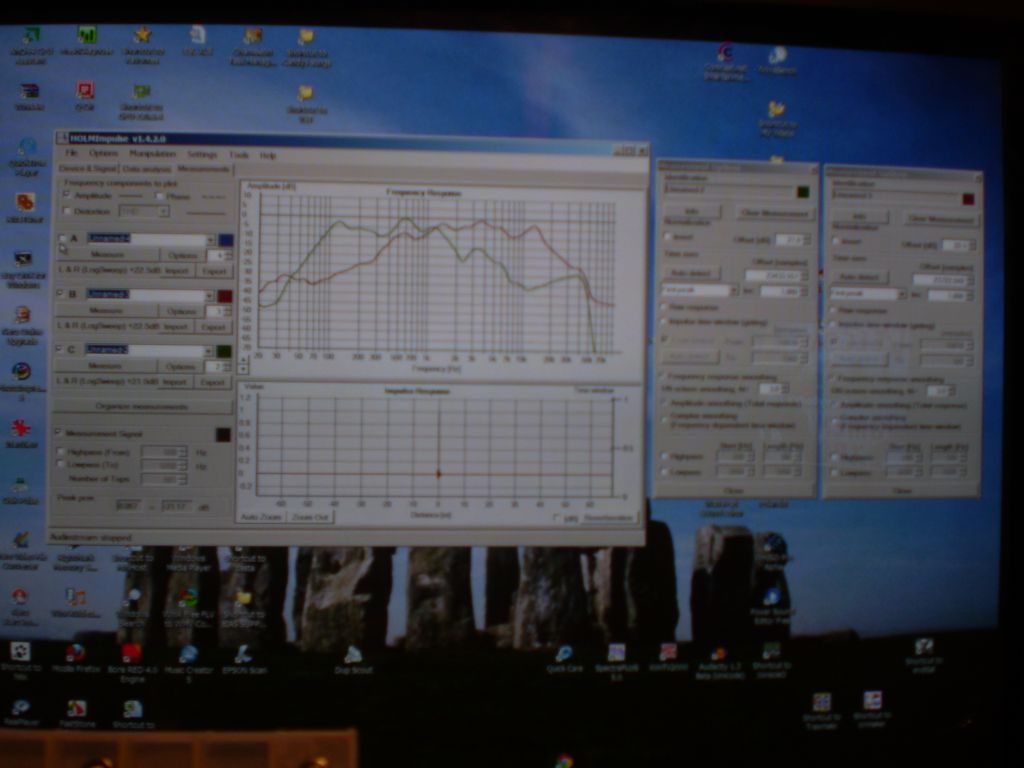

P.S. This is where I'm at just to give you in idea,
http://www.diyaudio.com/forums/plan...p-up-measurements-part-1-2-a.html#post2864507
The most my little amp would do with music is about 2Vrms to 4Vrms max and about 10v peak, with a 500 hz to 2khz steady test tone at 10v peak with a 1:330 ratio and no resistor,this was 1ohm(and 100watts)at 2Khz and about 98db at .5 meter,as this was the very First quick test.
