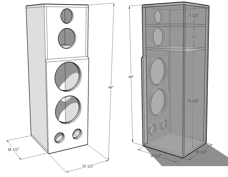

Recently, a friend of mine in my dorm gave me a set of old busted up speakers. He said to take 'em for free because they were old and probably didn't sound too good. Little did I know (about 2 weeks later after just having them sit around) that they were JBL century L100 speakers, which are right now going for a good 2-300 a pair on ebay. I cranked these guys up and I realized that for my dorm next year, I need serious sound. Seriously BIG sound. Sound that only large drivers in large cabinets can make (ala L100 speakers). So, in honor of the free speakers, here is my next endeavor. Critique it as much as possible, as this is far from anything I've done yet.
The drivers are as follows (you'll see where they all go 😀 ):
Dayton DVC 10" subwoofer
Alesis 6.5" carbon fiber mid/woofer
Hi-Vi SD1 1" tweeter
Attached are a preliminary 3D look:
Before I ask my questions, here's some other facts. I am not making my own x-overs for these speakers; they would just be too expensive. Rather, I'm going to use one of the Dayton 3-way filters they've got on PE, the one with the 375 lowpass. So, onto the questions:
1. Efficiency, efficiency, efficiency! Do you think that I could push these guys with a receiver to decent output levels, or would I have to run them through an amplifier to get enough power? Remember, these need to have high output levels, but buying dedicated equipment will defeat the purpose of low-cost, so let me know what you think on that.
2. The bottom chamber is 3.87 cubes tuned to 36.5hz, which should be sufficient to pick up any and all low end that these have to offer :bigeyes:. Point being, do you think that a tuning this low, with the edge of the passband rolling off around 350hz would cause blending issues with my midrange? The tweeter and mid should be fairly seamless, and I know bass is omnidirectional, but I do not want boomy bass if I'm not trying to throw a party. Yes, I will have other hi-fi equipment in the room, but I want to know just the same.
3. Now for the most and also the least important bit: grilles. Should I use grills on these or not? Here's the necessary and unnecessary reasoning: people like to play with speaker cones. For some reason they just like touching the, pushing in dustcaps or fondling phase plugs. I'm not worried too much about the sub, but some ******* might get curious about what textile tweeters are and might start playing around with it. A grille, although weak, almost always prevents people from touching the cones unless they are a speaker enthusiast. I don't want any accidents either. Now, with that said, they would be really unnecessary as putting grilles on two 10" subwoofers in a cabinet is next to an insult, as they'll just blow them off anyway. Also, I forgot to show that the subs and drivers will all be flush mounted (that's the purpose of the second baffle on the sub part, the angle at the top is for aesthetics only 😀 ), so they won't actually come in contact with the grilles. None the less, I would use a magnetic grill guide if I did decide to do that, which also defeats the purpose of the grill as I would need two separate ones for each cabinet (different baffle heights).
Lots of info here, but just wanna ask y'all before I do anything...stupid. :scratch:

First, I think you have a good basic concept for these speakers, just one small problem. Unless things have greatly changed since I was in college, a college dorm room, especially a shared dorm room, is pretty small; two beds, two desks, a sink, and a closet. Are you absolutely sure there will be enough room in the room for speakers this big?

3.) I suggest removable grilles. Life in the dorms can be pretty rough and tumble. People aren't really noted for being kind or considerate to other people's property. You want to protect all your speaker because, as you readily admit yourself, people can't resist poking at speaker cones.

First, the tweeter does not need a separate enclosure. You are wasting space and creating an empty cavity to resonate
2nd, the bracing in the box is wholly inadequate
3rd, with 2 woofers a push-push arrangement would gain you a huge amount in terms of performance.
4th, the use of any crossover not specifically designed for the box and the exact drivers is almost a 100% garantee that you will not get anywhere near the potential of the design. You cite expense. You'd do much better to only use 1 bass driver and spend the extra cash on building a proper XO (even better idea -- see below -- is to toss the passive XO completely
And while we are on the XO. XOs are the hardest and arguably the most important part of any multiway speaker. If this is your very 1st diy effort i would highly recommend something way simplier to execute.

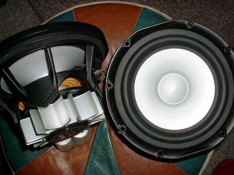

i completely agree with dave,
although i still doubt how loud these TBs can play 🙂
actually i have similar ideas for this,
using j6t from markaudio(jxr6hd clone) by jordan that specs as tweeter, add 1 midbass for the bass-fill, actually there's couple candidates, either using oem martin logan 8 inch alum woofer, or using magnat latest midwoofer which had the alum sink in the magnets, which quite beautiful 🙂
with simplicity of using active xo or might be pllxo that dave recommend

Thanks guys for all the replies. No, this isn't my first DIY effort in the least, i've been fooling around since 2004, which is why I put a special emphasis on the x-over part as it's the first time I've not made my own filter. I have never gone active, however, so I would need help in learning about how that even works.
Yep, I do know that they'll fit in the dorm as I've already looked in it and saw there's ample room. The L100s are going to stay until I find the time and/or money to restore them, and then I'll most likely give them to my father who owned 4 L100Ts back in the early 80s.
Now, onto the actual design. The bracing isn't shown in the enclosure yet as I just made that as a preliminary mock up, but yes I know it needs more. Secondly, I am assuming that is the TB 871s that you showed me as I'm using two of them for full range hi-fi duty in my dorm right now with a simple notch filter to clean them up. Do you think that would be a good way to go for the mid/tweeter range and spend the rest of the money on plate amps? My only concern is that they would instead just be a full range speaker that has a subwoofer attached to it, which I already essentially have (using a dayton RS12 sub with the tb's in my room). And yes, it would be a 3-way xover (two subs, one mid/woof, one tweet). 🙂
I was trying to keep my example within his budget. If i was to do this, i'd likely use FE166 or FE167 to get the volume capabilities & efficiency up.
