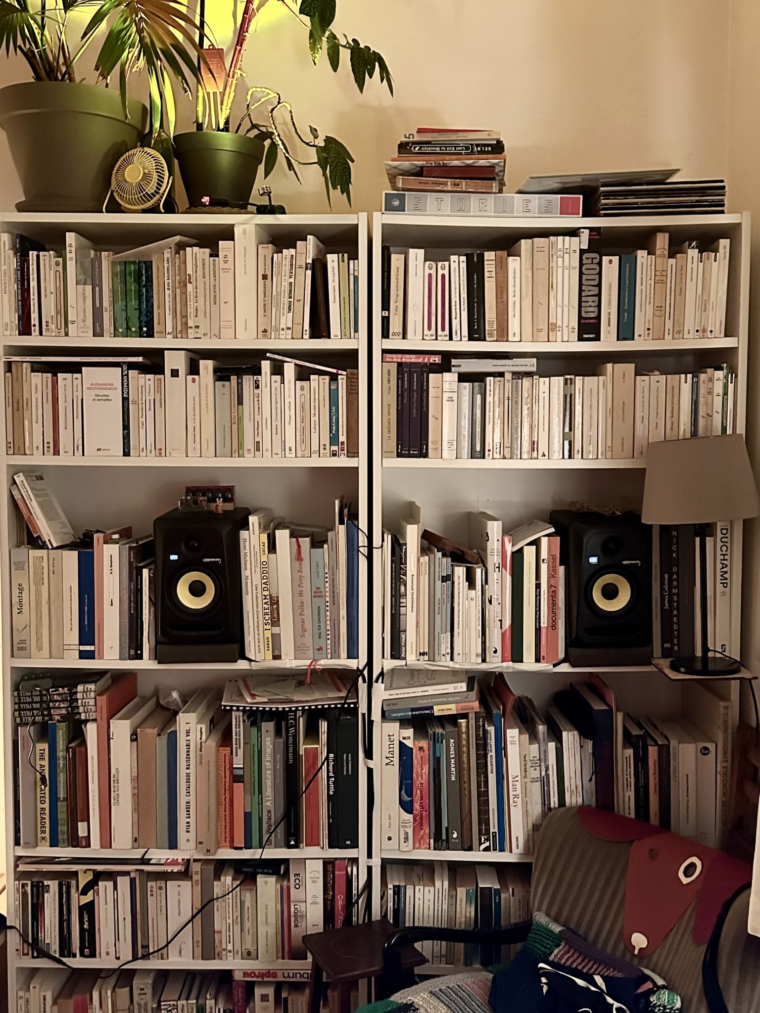

First time posting here. I have owned and used a pair of KRK Rokit Classic 5s for close to 8 years now. I always really enjoyed their sounds, not knowing any better. It has 'good enough bass extension' and sounds alright.

I'm somewhat on a tight-ish budget, and wanted to explore my options. The speakers would be placed in a room that is about 14/16 square meters, on bookshelves.

Thanks for all your recommendations. I took the plunge and paid 60€s to get the plan for the Cinetor Evos.
If I'm being honest, looks are really important, and these look really close to the Buckhardt speaker I wish I could afford.
The room they'll be installed in is small. Listening distance will never be more than about 2/3 meters. I'll be listening to them at nearfield levels.
The cabinet build is extremely straightforward and I have a friend who's going to build them for me. The rest should be within my capabilities. I do lots of soldering and have all the equipment required, and I'm a (fine arts) painter. I've used lots of veneer in the past as well.
I ended up deciding against putting them on my bookshelves and will build some nice stands for them.
I already own a proper DAC, and was planning on buying a Loxjie A30 to drive the speakers while I save up for something better further down the road.
Depending on how they sound, I'll consider adding a sub eventually. But they will never ever need to play at 'rock the house' levels anyway. My room is very easy to fill with sounds already.

Yes, that was the initial plan. Just as the KRKs are installed now. But I'll build some stands. I need more space for books anyway.
