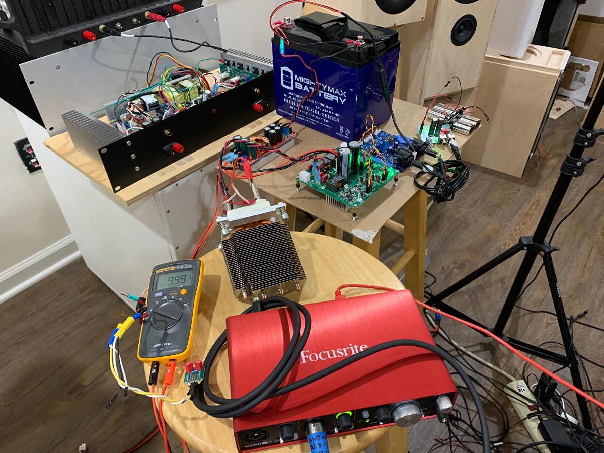

This was a lot of work, but in the end - worth it to prove to myself that the BTSB is a superb buffer. I setup the TPA3255 to be powered from a 12v lead acid battery driving an 800w DC-DC converter (51v). The battery also provides the 12v to power the BTSB DC input. The 1kHz low noise Victor's oscillator is also powered by 4x9v batteries. Laptop (HP Core i7 Pavillion) was powered by its own battery and laptop USB powers the Focusrite. This was the best way to get myself off the dirty nasty grid around my house. Just touching the ground/earth mains gives ugly noise in the measurement. Here is a photo of the setup:

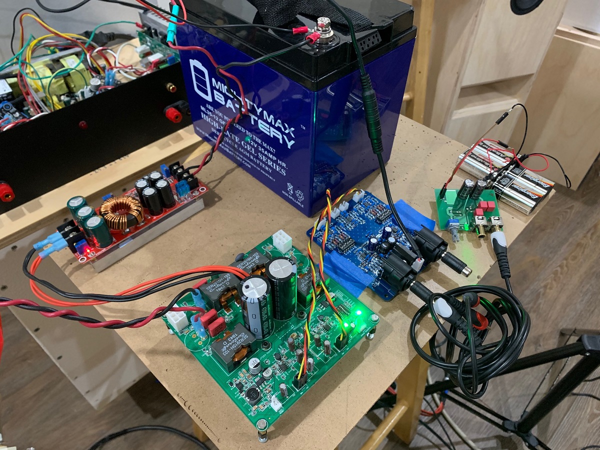

A closeup of the BTSB, amp and DCDC:

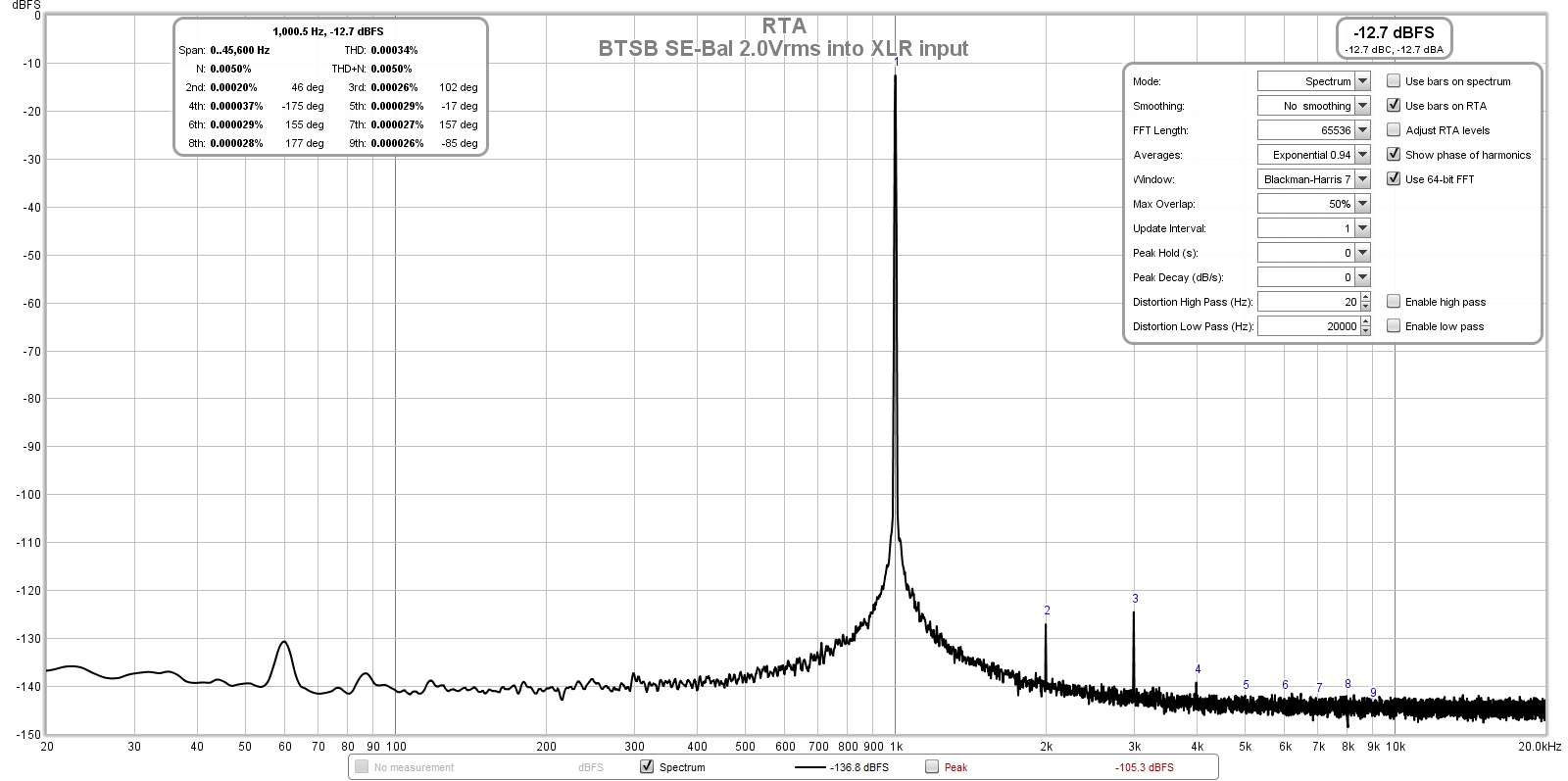

Here is the FFT for BTSB connected to the Focusrite's XLR input (instrument mode impedance - high impedance) and the BTSB was set to 20dB gain and putting out 2.0Vrms. The level of disortion here (0.00034%THD) is probably the Focusrite's internal distortion as we are already below the device's published ratings:

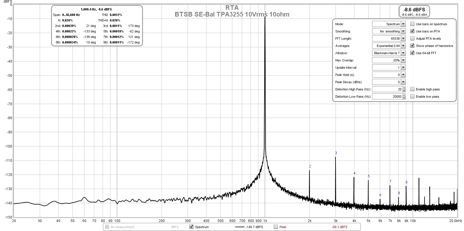

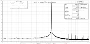

Here is the FFT for the BTSB in SE to Bal driving the TPA3255 with PFFB and at the reference 10Vrms into 10ohm condition. It is getting 0.0012% THD, well below the TI factory spec for the same reference condition with their own PFFB implementation. It is about the same as the previous 0.0011% THD that I measured using the THAT1646 SE to Bal converter. However, the noise profile now is cleaner with less HF "grass". The amps are different units so there is some variability to be expected. The previous one tested has been sold:

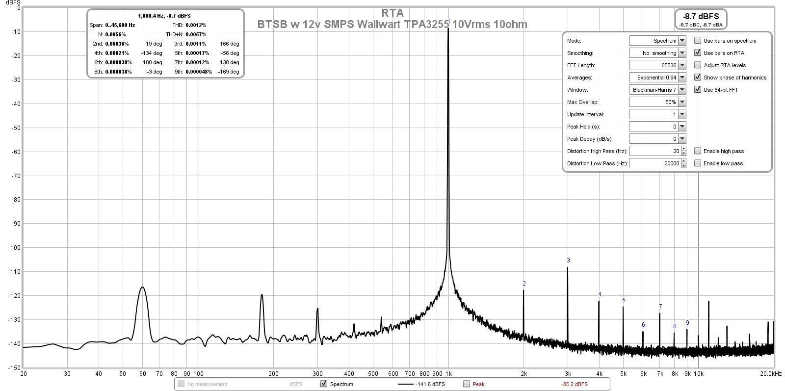

For completeness, here is what the BTSB powered with a cheap 12v 1A SMPS wallwart - it adds a little more noise at 60/120/180Hz, but still a respectable noise floor and THD and harmonic profile stays the same:
So I think we can see that this design is excellent and does what it is supposedd to do - not add any noise or distortion to the signal.

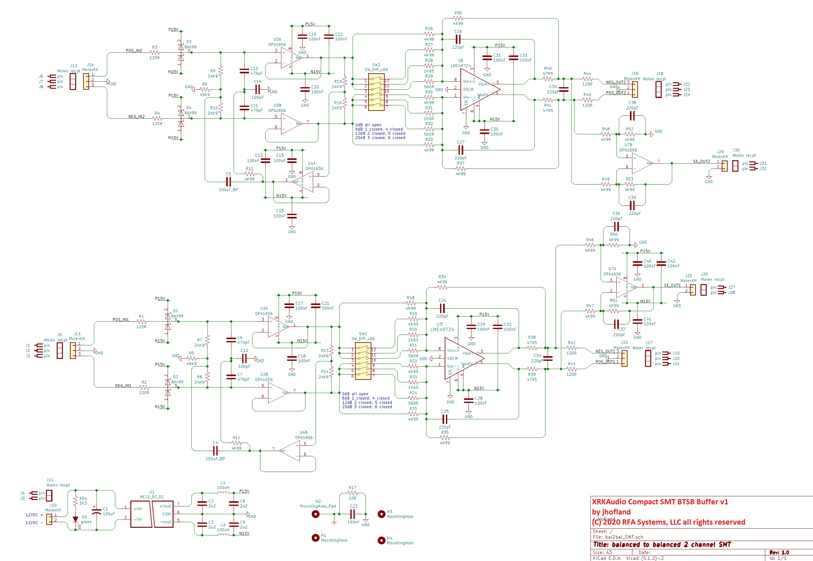

For the SMT version, the schematic below still needs to be updated to have R28/31/20/23 changed from 1.64k ohm to 1.24k ohm in order to have the same 14dB gain as the TH board. With the values shown on schematic, it is 12dB.
