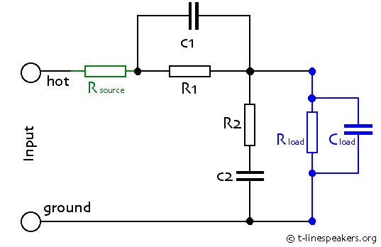

This is the final filter based upon the sound-au site, after building a prototype and playing with component values:
The filter is adjusted through a 4 position slide-switch (not shown on the diagram). From (roughly) 3dB to 6dB cut.
C1 provides the midrange roll-off... -3dB at 530Hz - but I found the top-end was very dull. So, I added C2 which alters the filter from low pass to band-cut. After playing with the values in the spice simulation and the real world, I settled upon 4.7nF... HF restored!
Here's the final simulated filter behaviour showing the output at the -3, -4, -5 and -6dB taps from the resistor ladder:
You can see that the -3dB point (7.07 volts) is pretty close to 530Hz in the lower switch positions which is the suggested -dB point for a 215mm baffle.

Hadn’t seen the Sound.au PLLBSC, but did publish one Paul Joppa came up with.
Passive Line Level Baffle Diffraction Step Compensation
The blanket statement that FRs need BSC is not true. Of all the FR boxes we have built (100s) only 1 ever had a BSC circuit.
Baffle step can be a can of worms, every dB you increas ethe on-axis up towards flat, you also increas eth eroom response above ideal by a dB. A careful balance is required.
BSC is often well liked because many people enjoy exagereated bass.
The FE167 has some natural tendency to have HF artifacts independent of baffle step that can cause issues.
The illlustartion of what need sdoing in a balanced circuit is good, one would do the same to make the SE XOs at the diyAudio store into balanced units.
dave
Reactions: maty tinman
Thanks for the clarification, Dave.
I had read Paul's page on this while I was researching the issue.
Agreed I was incorrect with that blanket statement and you're right to pull me up on that!
It all comes down to the listening. My system, in my room, appreciates this filter. I guess that the rule of thumb could be that if your full-range system sounds shouty and lacking in bass (subjective, of course!) then BSC *could* offer a solution to bring it back into balance. BTW, I'm not a fan of exaggerated bass... this is providing a very balanced sound indeed. I wish you could pop over and listen to a couple of sides... you might like it🙂
