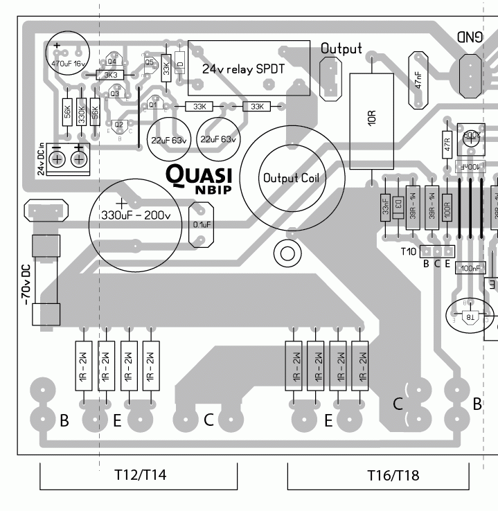

PCB advice needed
Okay, I need some advice. I'm not quite sure how best to handle this part...
The Quasi NBIP PCB's I'm laying out will fit a Bryston 4B chassis, as a drop-in replacement for the Bryston PCB's (along with appropriate output device replacements of course). But here's the problem. I'm making single-sided boards. Brystons were double-sided and the TO-3 sockets mounted on the inside of heatsink soldered directly to the PCB. On my boards, that would end up being the component-side of the board, so no solder pads there.
Should I ...
a) put pads on the solder-side for attaching the TO-3 sockets, and learn to solder around corners;
b) put pads on the edge of the PCB to feed leads behind for soldering directly to the sockets;
c) Get rid of the sockets and solder leads to the output device pins;
d) some other idea you tell me about;
Thanks!
..Todd

RE PCB problem

Thanks Con! Very good ideas.
After having thought about it more, I think I will just put pads near one edge and run short leads behind to the sockets, which are fairly close. The main reason is simply to avoid the track routing restrictions imposed by those TO-3 transistor pad locations -- which are VERY inconvenient for a single-sided board. Trying to layout tracks around them caused me much gnashing of hair and pulling of teeth. With those pads out of the way, I'm free to use the space more effectively.
Here's another question... How did you mount T8 onto the output heatsink? It's a TO-92 package isn't it? Would longer leads affect its operation?

Okay, here's the [current] fruit of my labour. What do you think Mr. Q? Does it get the Quasi seal of approval? Or did I commit some heinous PCB layout faux pas?
http://members.shaw.ca/toddj/Quasi/nbip-4B-PCB-layout.pdf
By the way, I changed the footprint of many of the film caps to suit my taste for polypropylene, of which I seem to have amassed a considerable collection.
..Todd

And here's the tracks alone, naked.
http://members.shaw.ca/toddj/Quasi/nbip-4B-PCB-tracks.pdf

And here's a diagram of how it would ultimately fit into the 4B chassis. I think I read somewhere that a BD139 would work for T8, if that's the case, it will fit nicely into the location shown on the diagram, connected by leads to the back of the PCB, as all the output devices are.
http://members.shaw.ca/toddj/Quasi/BRYSTON HEATSINK.pdf
..Todd

Hi Todd,
I like the layout and I also like the placing inside the case. There are 3 maybe 4 errors though.
1. The two 470r resistors are shorted out. These should have seperate feeds to the emitters of T2 & T3.
2. Similarly the emitters of T2 & T3 are also shorted.
3. The collector of T8 should go to the collector of T6. At the moment it doesn't go anywhere.
Maybe 4. It looks as though you have a bolt inside the speaker output coil. This is a no-no particularly if it is a steel bolt. You should either remove it, shift the coil or use a brass one (make sure it's really brass).
Otherwise nice work and well thought out.
Cheers
Q
