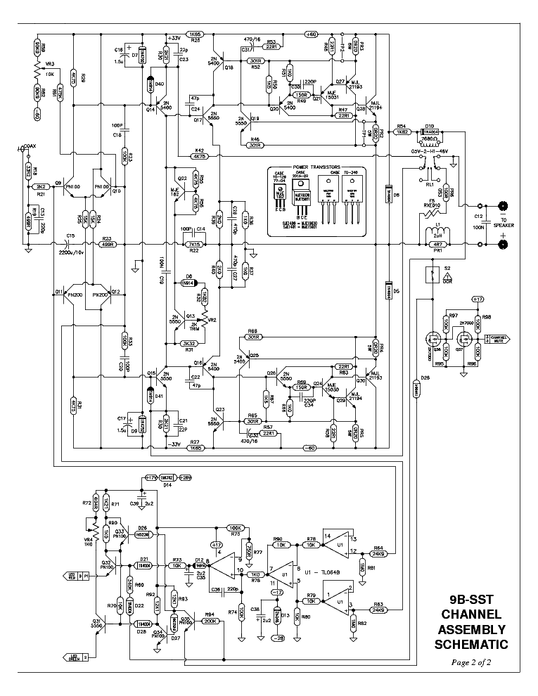

Hi.

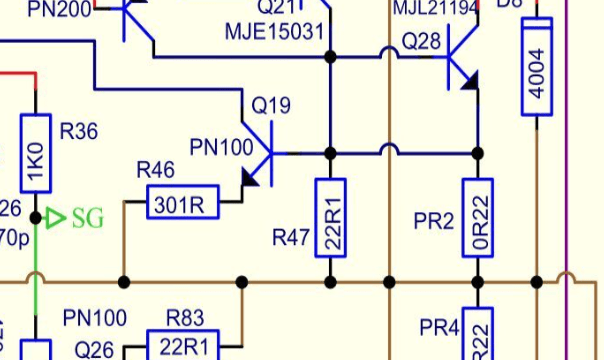

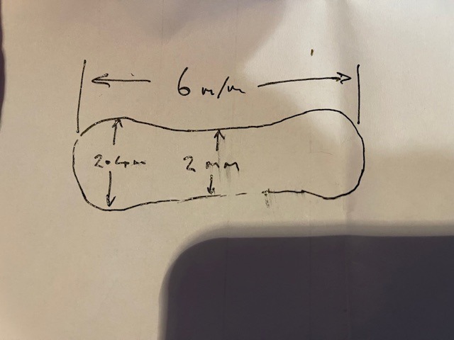

The resistor R47 - 22R1 has failed in one of my channels. Would anyone know its wattage rating? I can only go of its size, which is 6mm long, 2.4mm wide on the ends, and 2mm wide in the centre.

Looks like a quarter watt.
With vishay etc rating resistor wattage these days at a temperature high enough to burn the board material, I would buy metal film or carbon film resistor of at least 2 watt. Nothing shorter than the original, which might make it 3 watt or higher. It is the driver leg to speaker which carries significant current.

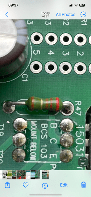

Yep, red-red-brown-gold-brown. 22R 1% is what I thought. So I've replaced the resistor with a .22ohm 1%, hooked the power amp back up, and when I start turning the gain up the sound starts to distort?
I should add, the sound is fine at lower volumes, it's only when I raise it. Could the resistor be causing this issue, or?
R47 is clearly 22r1 whereas pr2 is 0r22 . Bryston is using R as the decimal point. R47 as 0.22 could prevent Q21 from driving Q28 adequately.

Thanks again. From your initial advice, I placed an order for a, Vishay 22ohm 2W 1%, however this is on back order. So in the meantime I ordered, what I thought was a 22ohm 1/4W 1%, but accidentally ordered .22ohm. I only realised this was wrong after fixing it to the board. When I placed the order again for the correct ohm, I was sent .22ohm again from the supplier, who said this is what I needed. So I just wanted to check I wasn’t going mad.

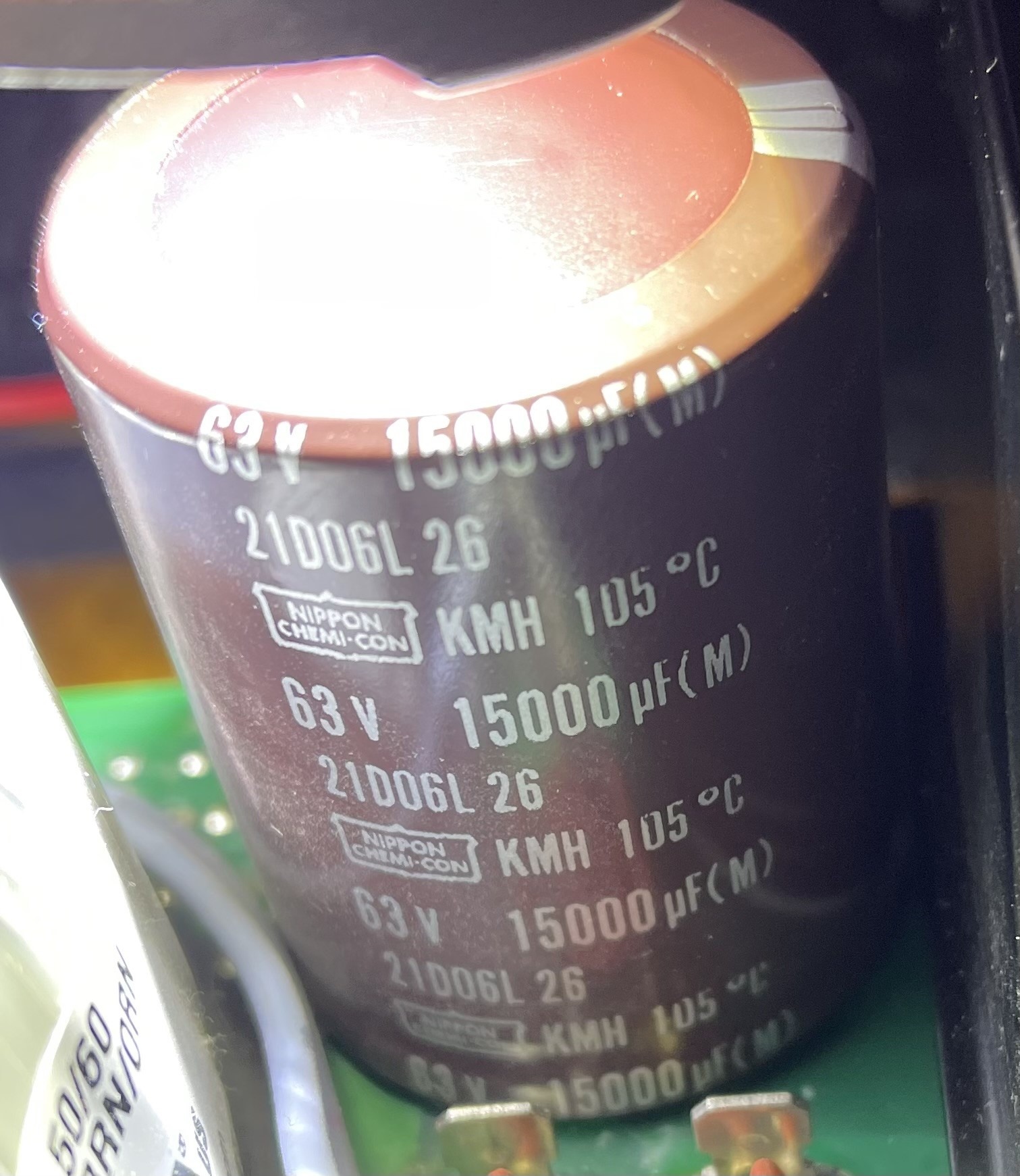

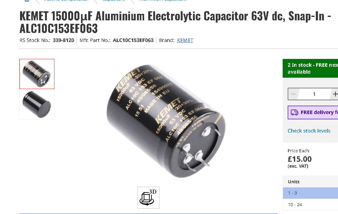

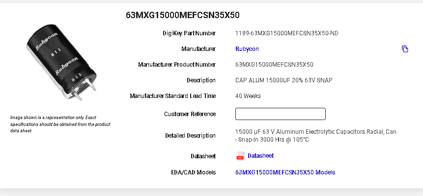

How close do I need to match the cap's. The original power supply ones are: '5 pin - KMH -105 degrees C - 63V - 15000uF (21D06L 26)'. I've found something a similar one on the RS components site, but they are only rated at 85 degrees C.

I do not know the thermal design of a Bryston 9b. If you decide to never run the amp at full power for more than a few minutes, perhaps you could risk an inferior part.
15000 uF is kind of an obsolete size. Manufacturers have started using the EIA preferred size series. Perhaps you would have an easier time finding a 14000 uf or 16000 uf capacitor in stock.
The number of pins is not important in the day of effective glues. Multiple pins were used to resist the shock of transport by bar bands that set up & tore down every gig. Now we can use silicon seal or wallboard adhesive to glue the capacitor down to the pcb.
Reactions: wull

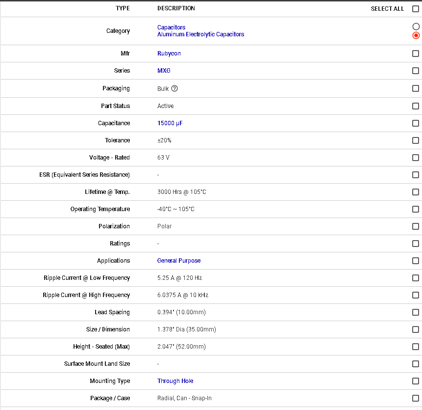

So, it not been as simple as I expected finding a cap to replace the, KMH -105 degrees C - 63V - 15000uF (21D06L 26). However, I have been told that the, 63MXG15000MEFCSN35X50 is a suitable replacement. I have another couple more inquires I am going to make before going ahead with this overhaul.
