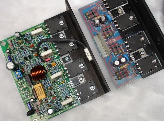

I did most of the machining of the heatsinks this week, and will be assembling one of the amp board sections fairly soon. I still haven't been able to get reliable info on how to bias the 4B ST, (even emailed bryston). Anyone have a service manual for these amps, or have any experience with how it's supposed to be set? Any info would be greatly appreciated. Thanks in advance!

I know a long time has passed since this last posting, but I was wondering how this went afterwards.
Did you ever finish it?
Did you finally find the info to bias it properly?
If it worked, how did the thermal stability turn out?
Yup, one was completed. Determined the bias values, using the 4B SST service manual as a starting point and adjusting with a scope + distortion meter. Would have to go back into my notes to find the current values I finally settled on.
I'm extremely happy with the performance, clean, detailed and tonnes of headroom. Been running as the L/R in a home theatre for 2 years, no issues with thermal stability have appeared yet.

I suspect about 60-65mA per device might be about right.
I've been simulating those and that works well. Plus I think they do mention something like 65mA in their service manuals.
But that's set in more than one step, first at cold room temperature with a lower setting, then let it get warm and correct it again.

It may be stable and yet the bias may still have changed somewhat with heat, so perhaps when it's hot the bias could be different from what it was set at first.
This would be interesting to find out. By taking a measurement when it's warm and compare that with the initial setting.
Was the pcb made by copying an original amp? Or was it more loosely based on one but with personal choice and differences?
How are the devices thermally coupled? All on the same sink? What about the 2 sensing devices in the bias spreader? Are they all put together on the same sink? Or is there a separate tracking for drivers and outputs?

Ys, although not the one Bryston uses in their production amps. It's a simpler DC protection circuit used in other hobby builds.
I'd have to go dig it up, those schematics are all old hand drawings. Bryston does have DC protection, I just didn't use their design. If I remember correctly theirs li on a separate board that also drives the front panel LEDs.
