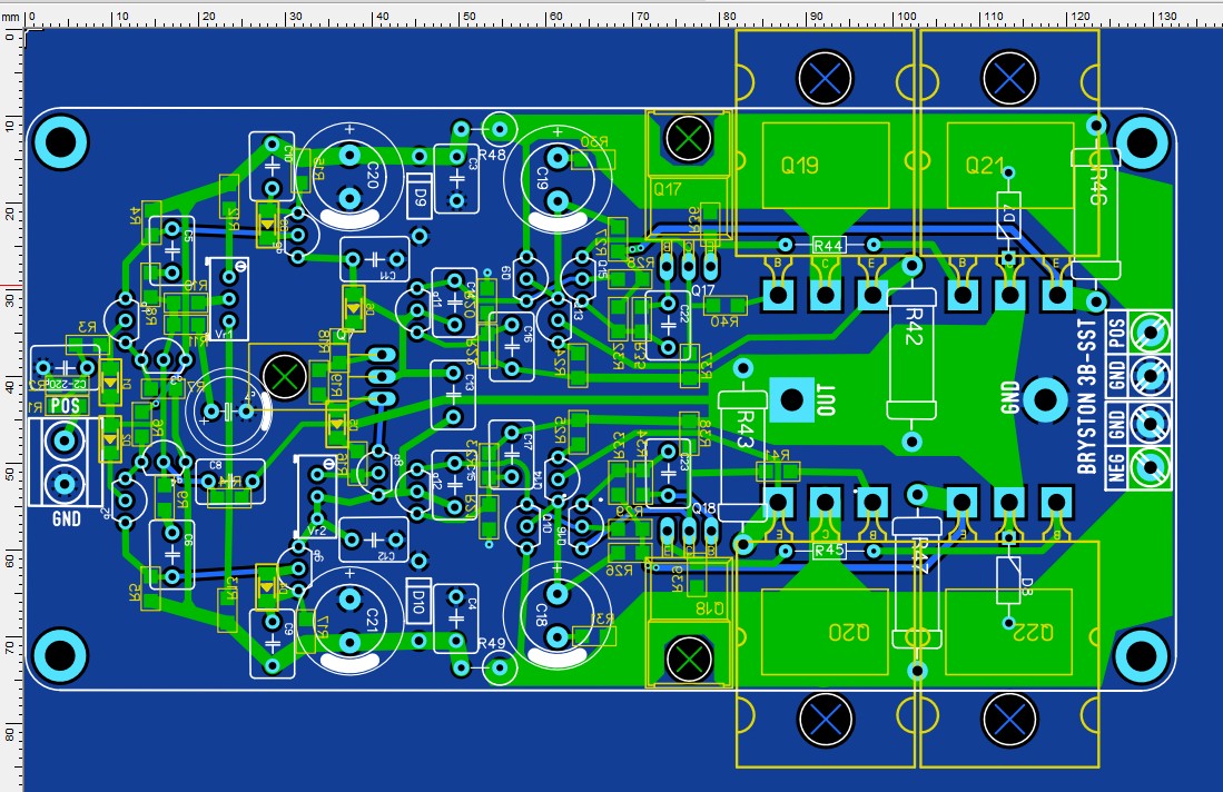

I'd pay more attention to output transistor matching rather than using 6 band resistors
I'll also pay attention to transistors. Thank you

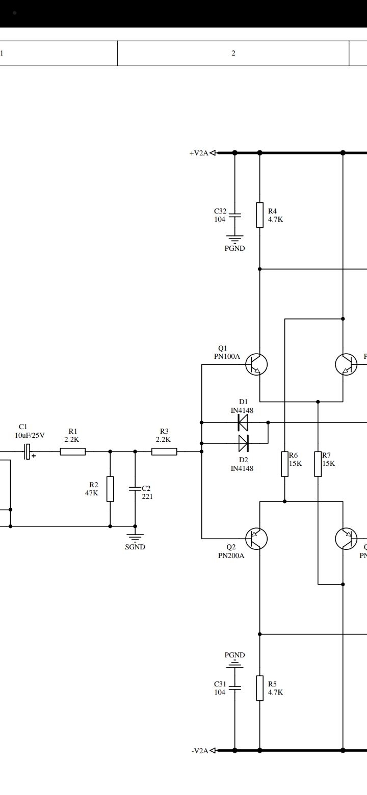

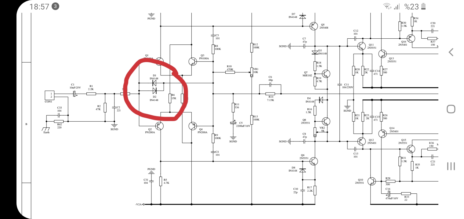

I'm not sure, I'm on a tablet away from home, it's long time ago I build it, what's does the bom list say? 33v?
D1 and D2 are small signal silicon diodes, not zener diodes.
1s954 small signal diode 50v

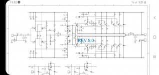

the lastest available version
4B v5.0 just add two 100n cap
The 1n4148 is such a cheap part, 100 for a few bucks, no hassle, I'd stick with the intended, otherwise compare spec sheets, by eye they look similar apart from voltage
thank you I have 1s955 75 v 200ma small signal diodes I use them

at the entrance 2 pcs 1n4148 unused in rev 5
- Bryston 4B SST clone
