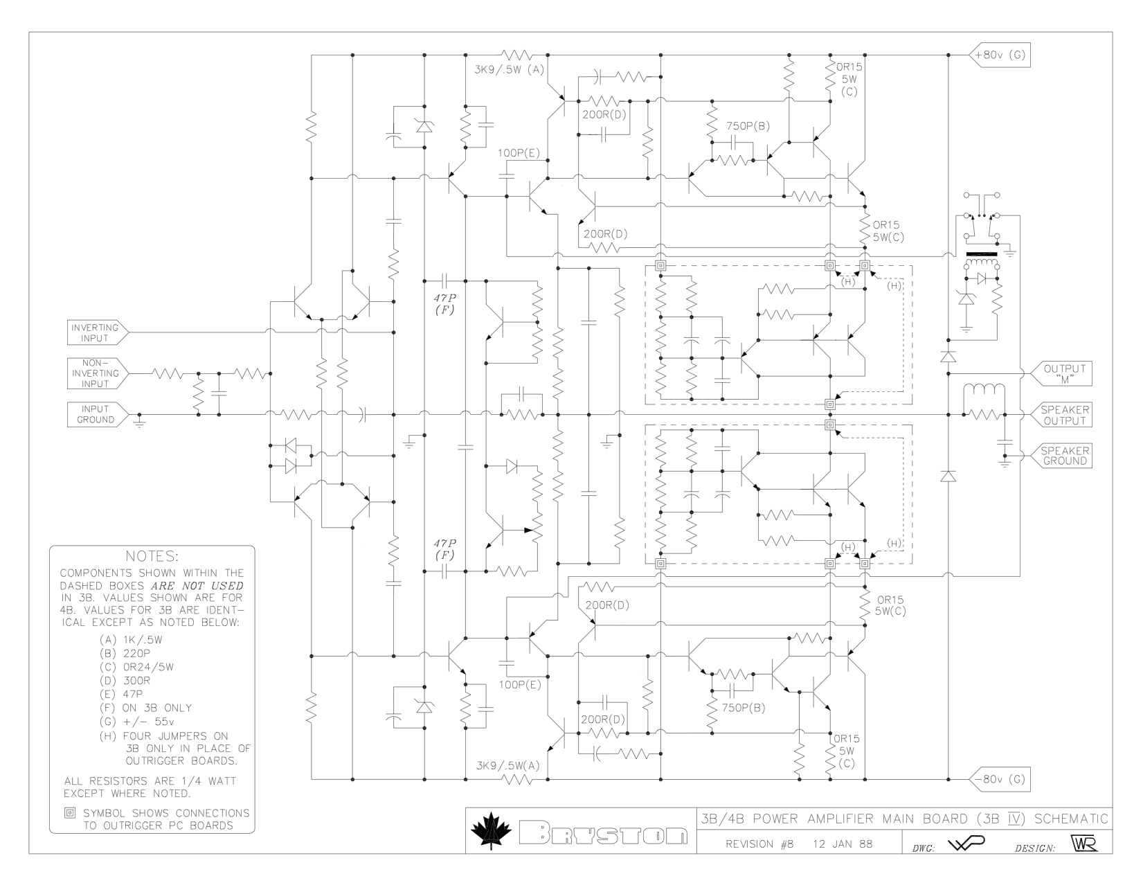

The circuits are very similar, yet I have seen many comments on the superiority of the 4B from the sonics point of view. In looking at the differences (attached schematic, hope this is OK, see below) they should be quite similar in sound. The diagram has been stripped of all component values and device types, excepting the 3B / 4B differences as noted on the schematic. I addition the schematic is freely available from Bryston here:

Aside from differences (A) (C) (D) (G) (H) which seem to be specific to the higher rails and greater power capability, the most likely sonic differences would originate from differences (B) (E) (F) which appear to be the amplifier's compensations. Any thoughts on this?
So then the next logical question is can one make the 3B sound more like the 4B by compensating the 3B the same as the 4B, assuming there is no issue with stability?
