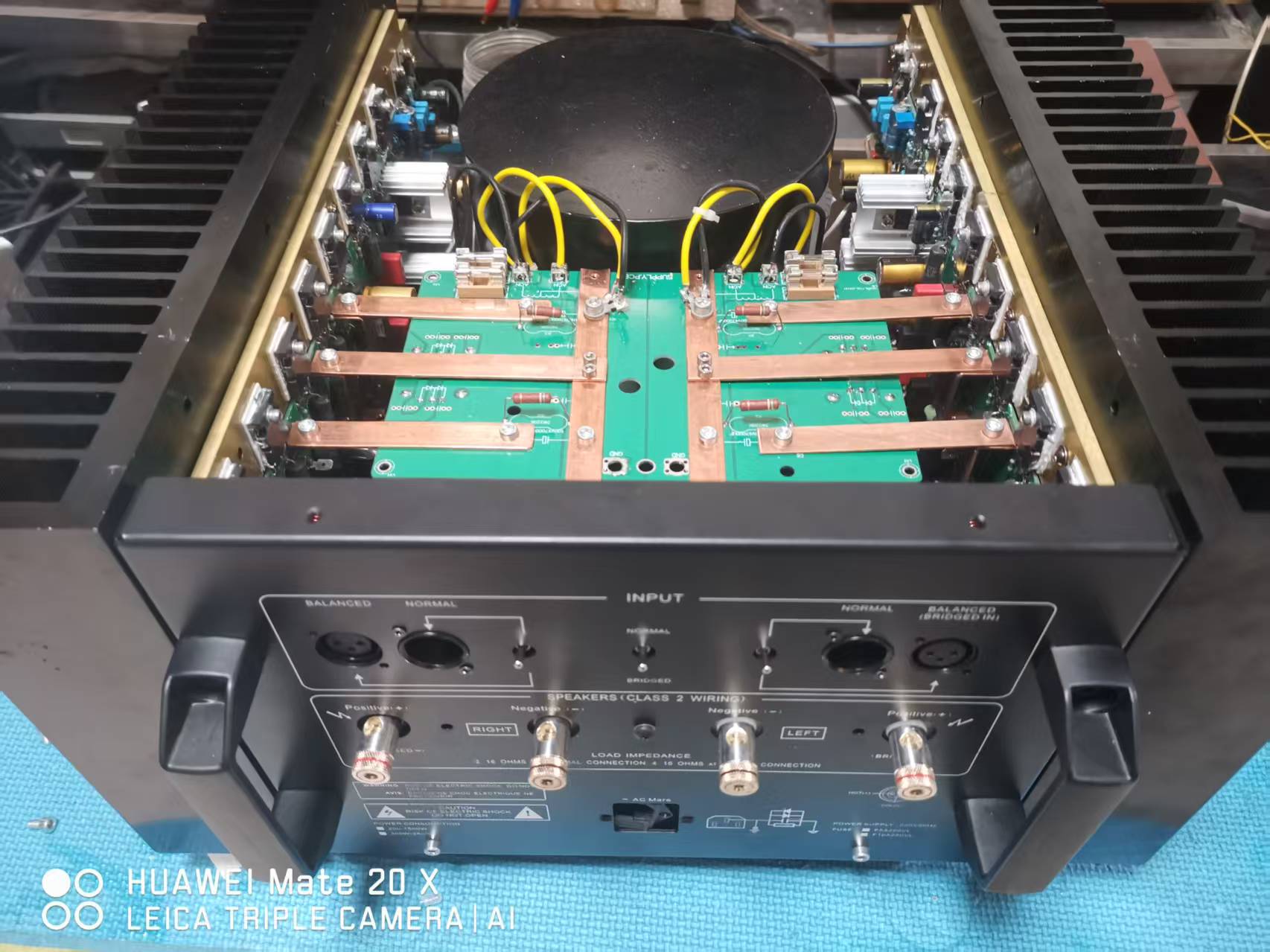

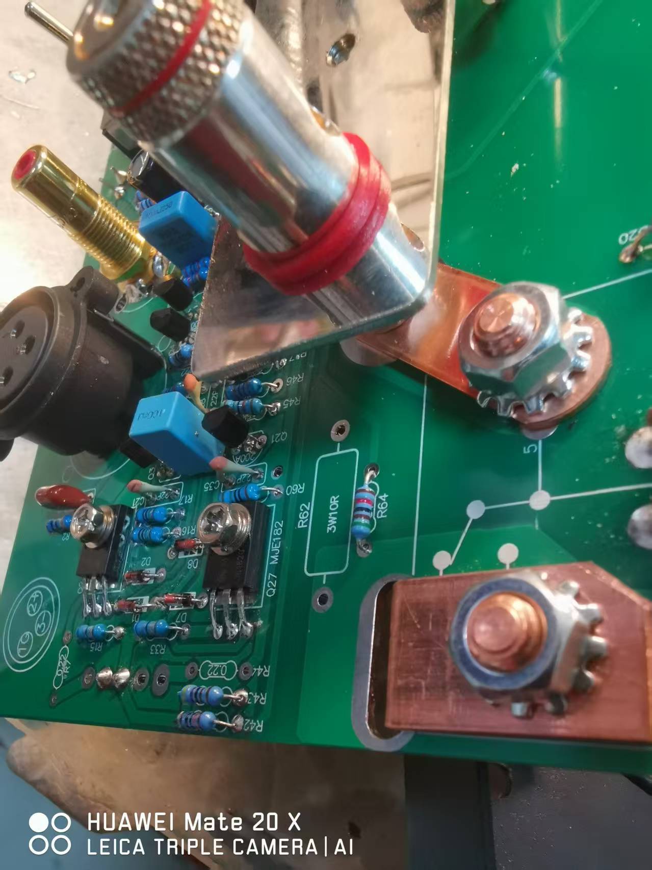

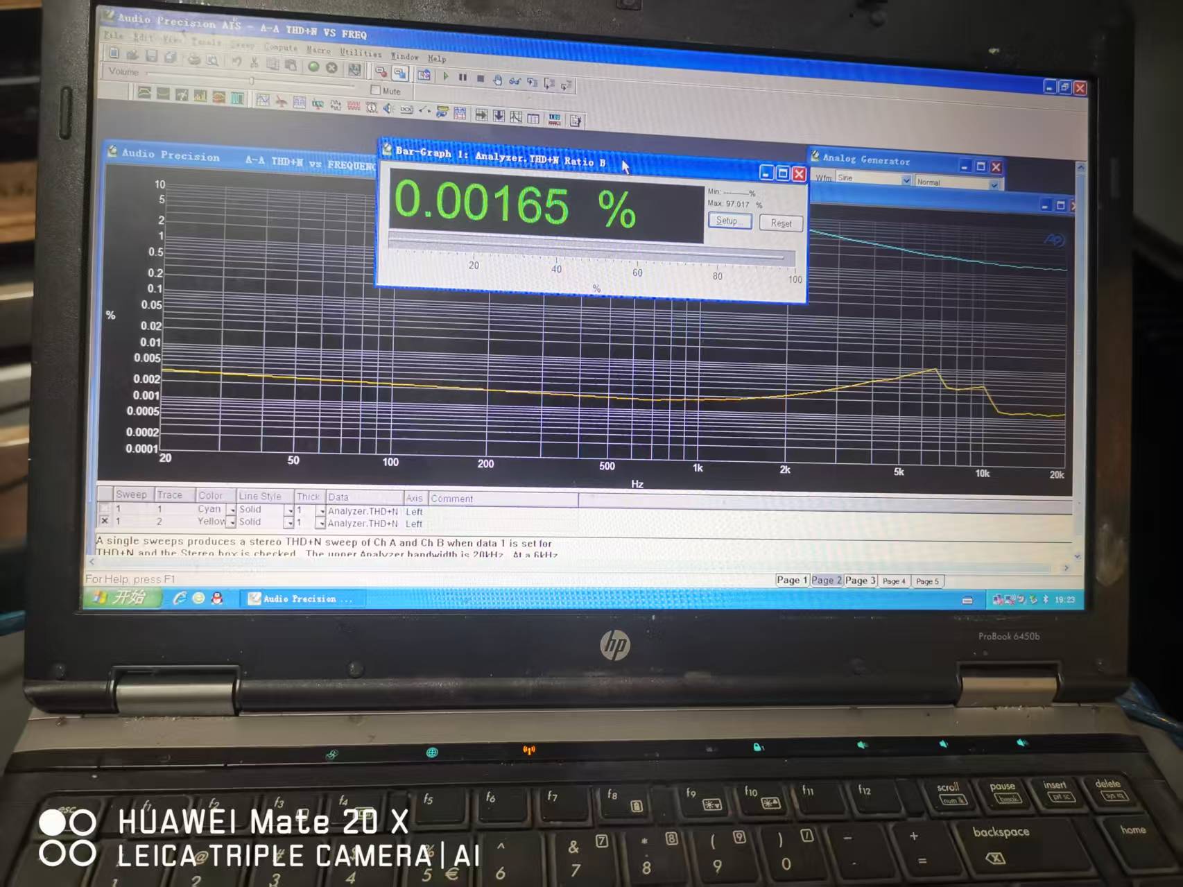

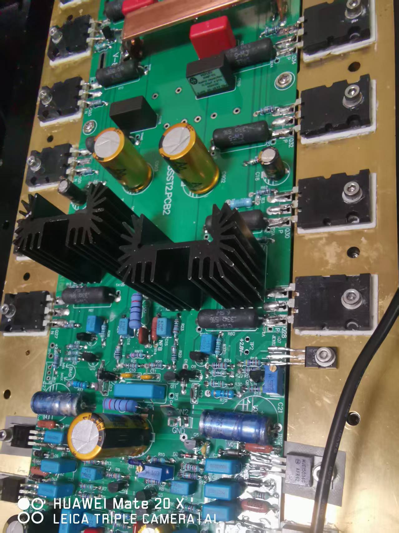

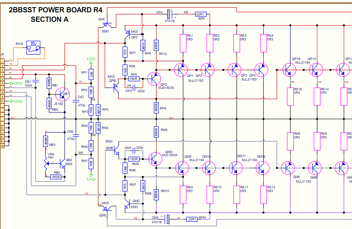

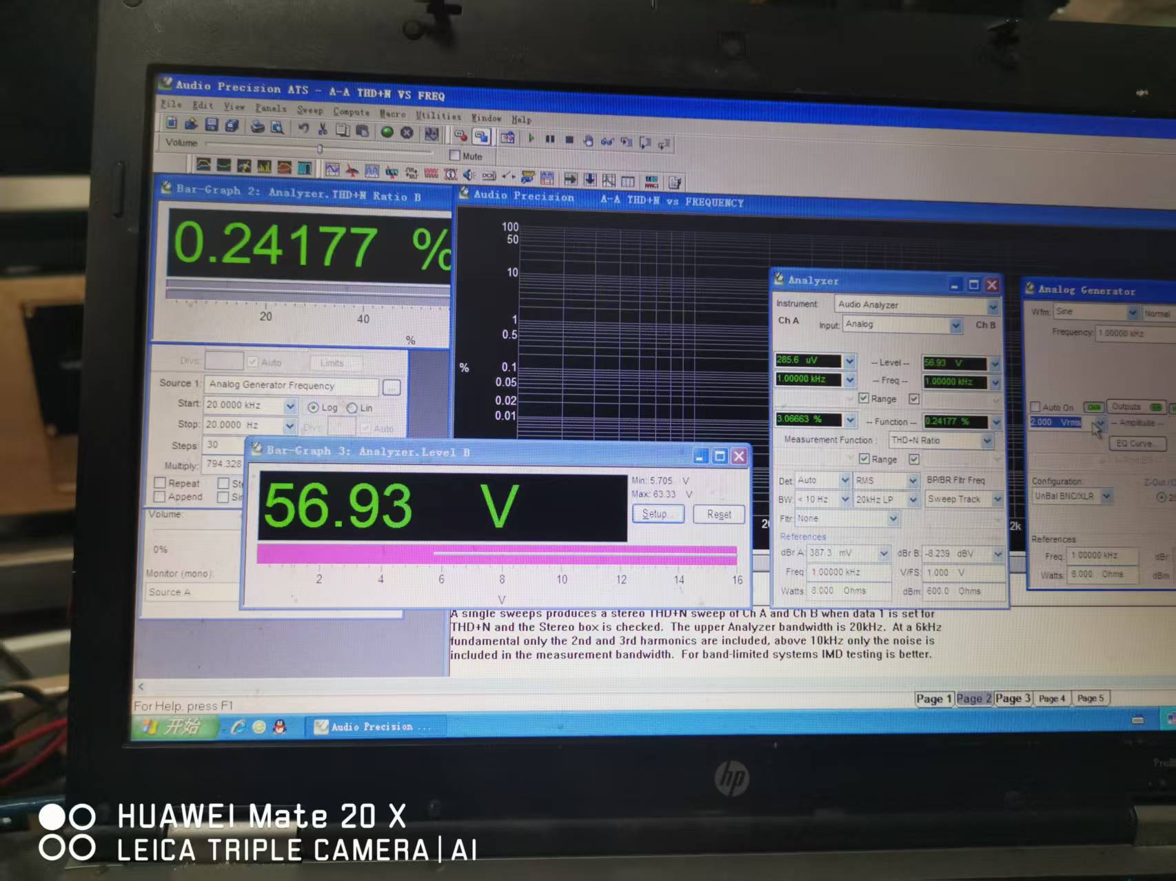

A atisa188 Member Joined 2023 2025-01-21 4:51 pm #1 2025-01-21 4:51 pm #1 BRYSTON 28B SST Attachments 28b-3.jpg 252.3 KB · Views: 92 28b-2.jpg 240.8 KB · Views: 89 28b-1.jpg 175.9 KB · Views: 87 Last edited: 2025-01-25 11:46 am A atisa188 Member Joined 2023 2025-01-21 5:05 pm #2 2025-01-21 5:05 pm #2 During the production process, it was discovered that the power tube would be burned。 The reason is that the main radiator heats up the QMD QPD, QMD QPD must have an independent radiator Attachments 28B-6.png 157.2 KB · Views: 107 28B-5.jpg 230.9 KB · Views: 102 28B-4.jpg 211.2 KB · Views: 103 A atisa188 Member Joined 2023 2025-01-25 11:46 am #3 2025-01-25 11:46 am #3 OUTPUT 8OHM 400w Attachments 28b-7.jpg 238.6 KB · Views: 36 28b-8.jpg 207.4 KB · Views: 38 You must log in or register to reply here. Share: Facebook X (Twitter) LinkedIn Reddit Pinterest Tumblr WhatsApp Email Link
