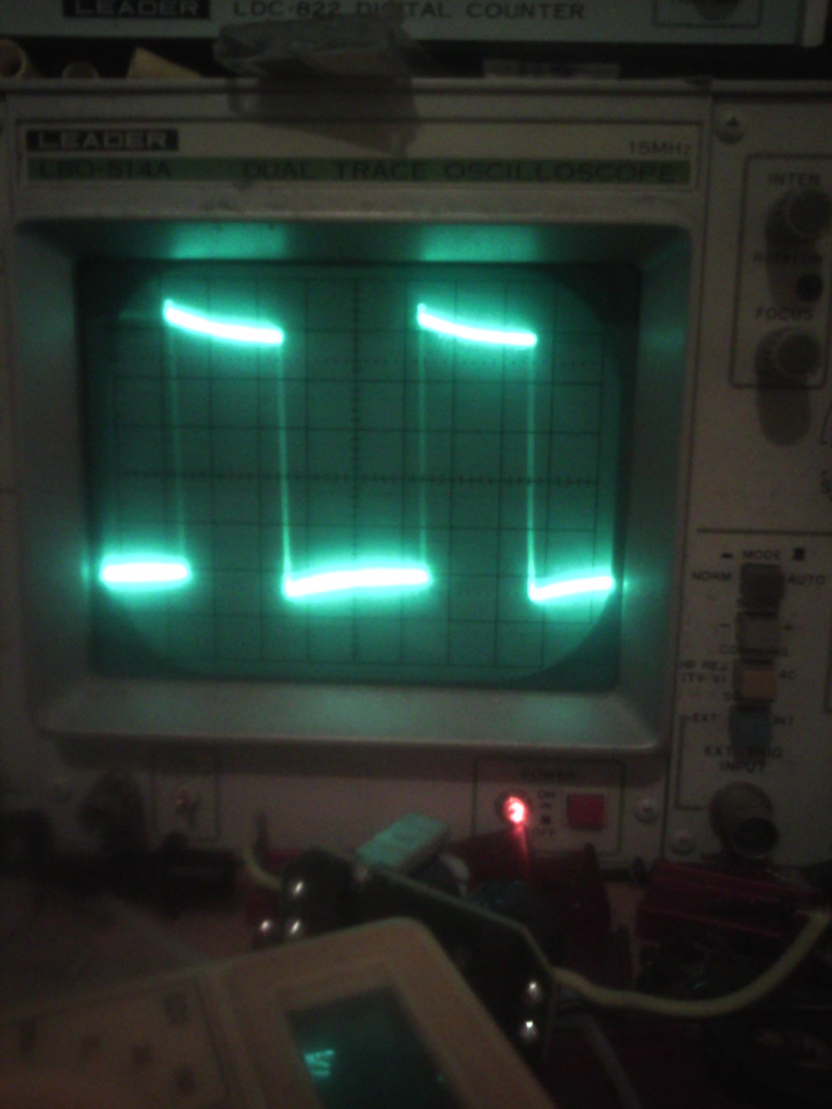

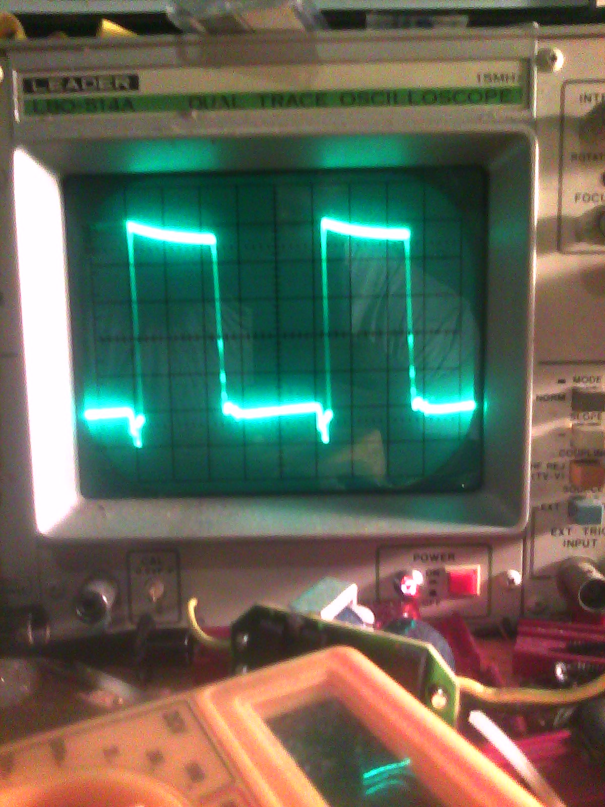

Are the FETs in the circuit? There should be switching transients/glitches on the rising and falling edges of the waveform. They were there before. Grounding the probe at a different point shouldn't have eliminated them.
i put 2 in for each bunch.now only one group is getting hot i checked the signal its different from the rest. should i pull that drive transistor?
