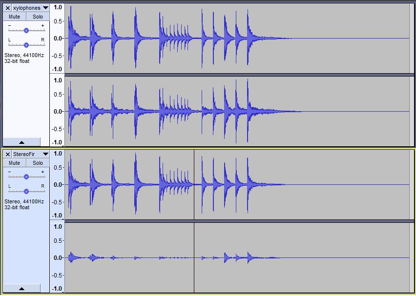

I gave it a try and its close, but was generating pipe and file errors on my RPI so I went looking for a solution. This works for stereo FIR convolution. Used on sox v14.4.1.
Code:
 sox -M -t sox "|sox xylophones.wav -p remix 1,1 fir HP1Kfir.txt" "|sox xylophones.wav -p remix 2,1 fir LP1Kfir.txt" outstereo.wav
It's not obvious from the manual but I got some more hints from command line - SoX pipe operations and data loss - Super User I tested with a 16K tap LP FIR@1Khz applied to one channel and a HP FIR@1Khz applied to the other channel. The test file (xylophones) and filters are in a zip file at the end. The xylophone file is mp3 but can be converted (bloated) to the required wav file with "mpg123 -w xylophones.wav xylophones.mp3". The top 2 waveforms are originals and the bottom 2 are post filtered.

Got it!
Thanks to DonVK and scott wurcer!
REM sox.exe stereo_IN.wav mono_1.wav remix 1,1 fir filter1.txt
REM sox.exe stereo_IN.wav mono_2.wav remix 2,1 fir filter2.txt
REM sox.exe -M mono_1.wav mono_2.wav stereo_out.wav
could be reduced to a single line like this one:
sox −M "|sox.exe stereo_IN.wav -t wav -c 1 - remix 1,1 fir filter1.txt" "|sox.exe stereo_IN.wav -t wav -c 1 - remix 2,1 fir filter2.txt" out.wav
It works, just have to test how long does it takes to produce the first audio using long files (latency), but it works.
