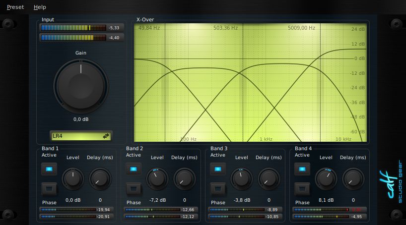

Like Loafmeat, I want to use plugins with a GUI, these CALF plugins offer a decent interface and nice set of parameters and are easily tied together with Jack. I have had multichannel working with my ubuntu laptop and it is great, modifying parameters on the fly by dragging your mouse. Very much like for instance a minidsp or hypex device. I had it working with two-channel on the pi, so it should be down to getting access to those multichannel outputs of the HDMI.
Some of the calf plugins:
Regarding jack:
