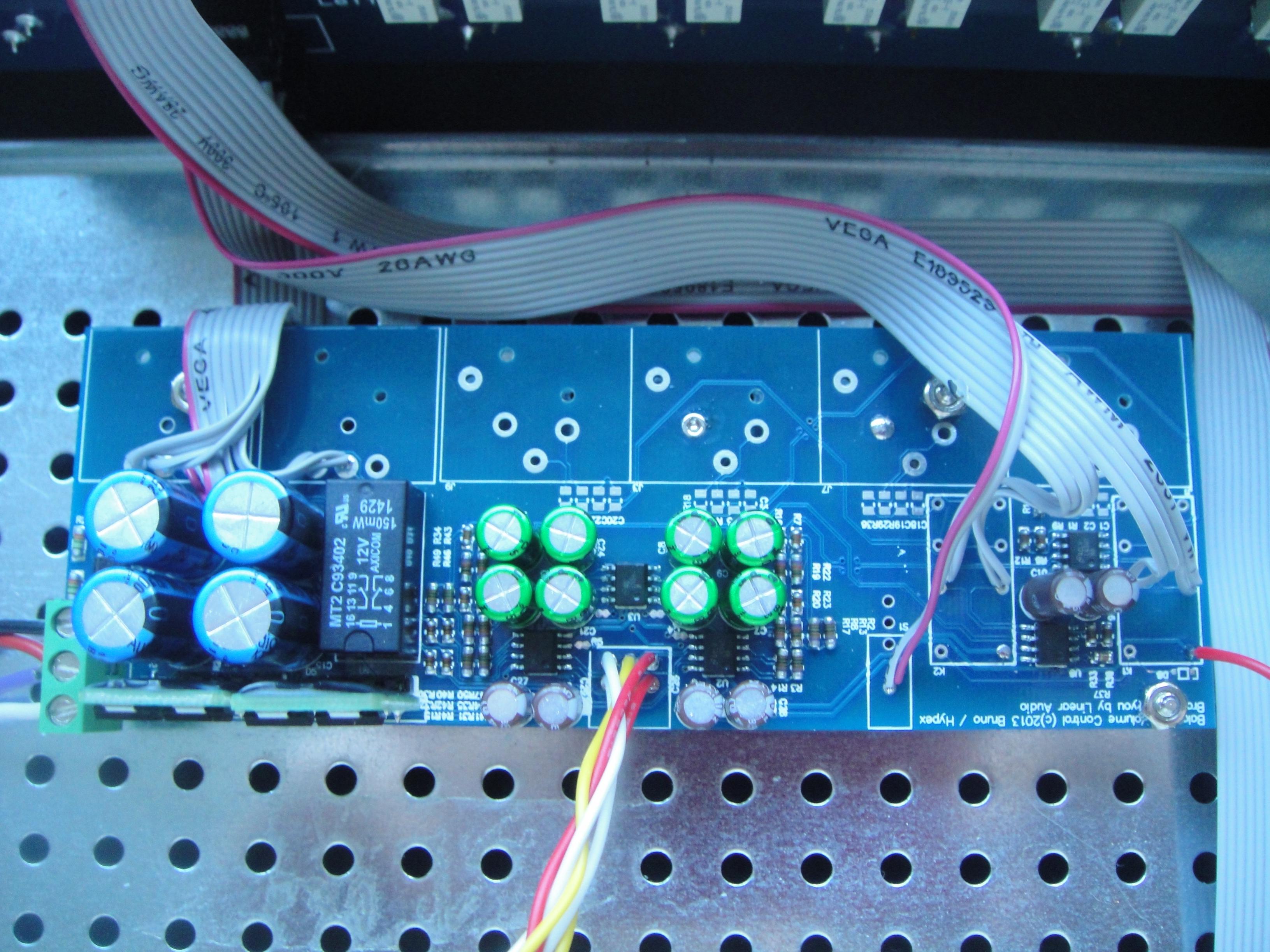

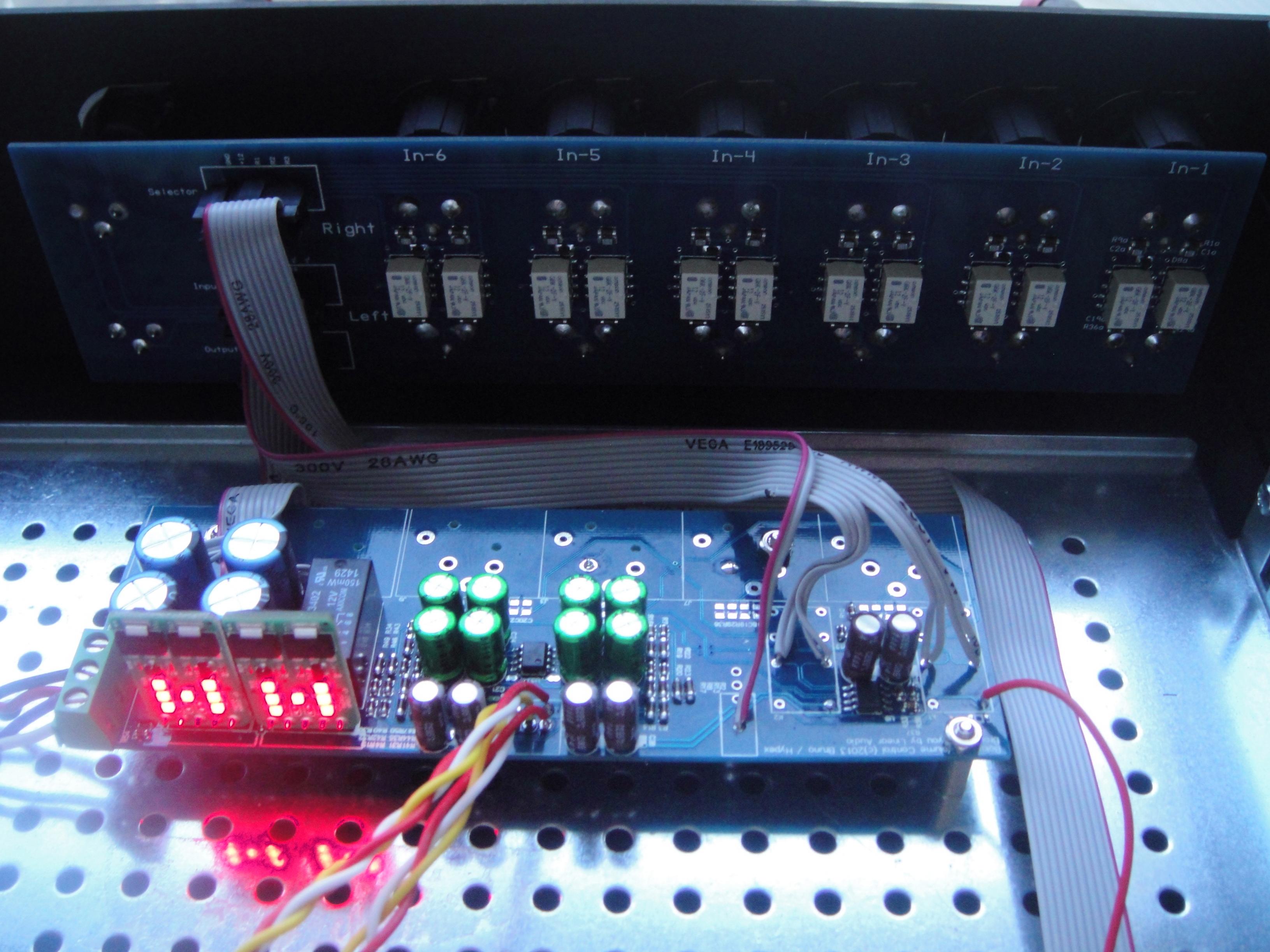

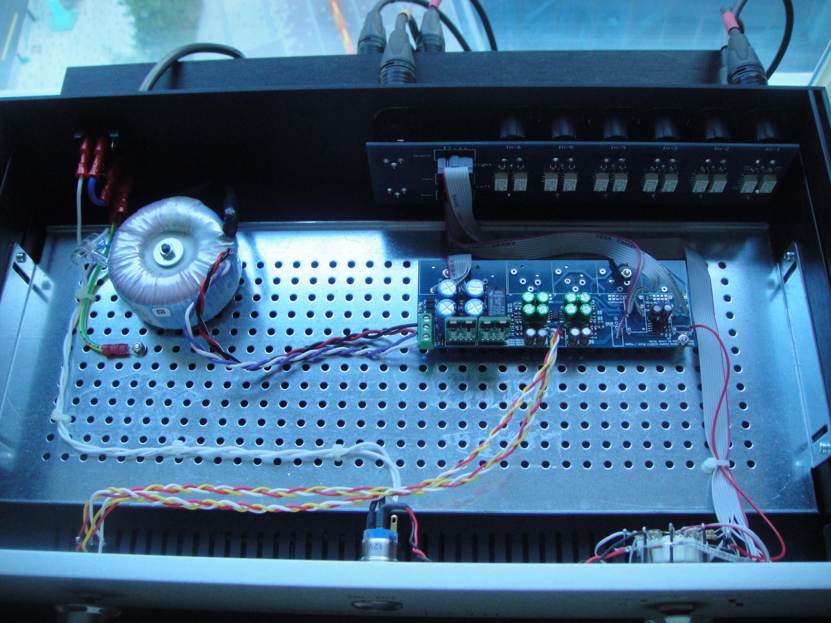

Hi Robert,
I am sorry to jump in your GB but look like there is no more interest and that’s is really pity… the Bruno preampli is an amazing design and deserve in my opinion much more attention.
I downloaded the gerber files that Linear Audio kindly make available and I realized the board as it is. Because I need more than 2 inputs I designed an additional board for the back panel that allow up to 6 balanced input.
Unfortunately I “blindly” place the order on Mouser for the parts based on the BOM published in the thread. There is more than one mistake:

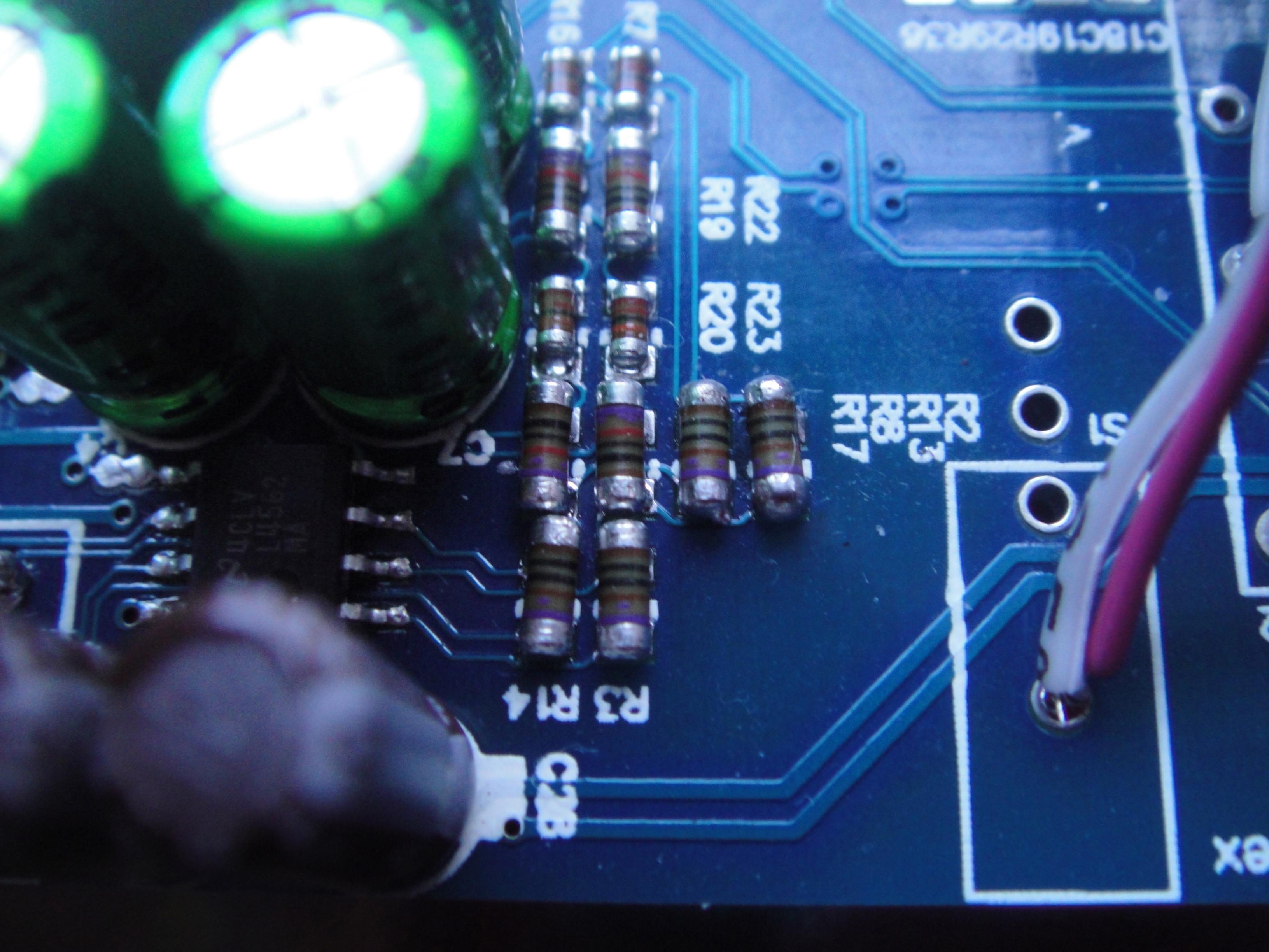

- The expensive SMD resistors R2, R3, R13, R14, R30, R31, R40, R41, R8, R17, R35, R44, R19, R22, R46 and R49 are wrong.
The size of the 0207 serie resistors proposed in the BOM cannot fit in the pcb. The only available size with the same characteristic is the serie 0204 that is a little bigger than the other resistors but (being really careful) can fit the footprint
- The C10, C16, C26, C27, C28, C29 can’t fit in the pcb. Changed on ELNA SilmicII RFS-25V220ME3#5
- The C12, C13, C14, C15 can’t fit in the pcb. Changed on Nichicon UKT1E102MPD
For the C4, C7, C8, C9, C21, C23, C24, C25 I choose Nichicon UES1V100MEM
Anyway the preampli is playing since few days now and I am really impressed. Frankly I didn’t expect a so incredible result. This preamplifier really deserve to be realized. The bass are tight and controlled, the voices are incredible and the high tone are really nice and smooth. The 3D image is impressive and there is a correct space and position for all the instruments.
Thanks Robert to introduce to us this simple but amazing design and thanks to Bruno Putzeys to share with all of us his design.

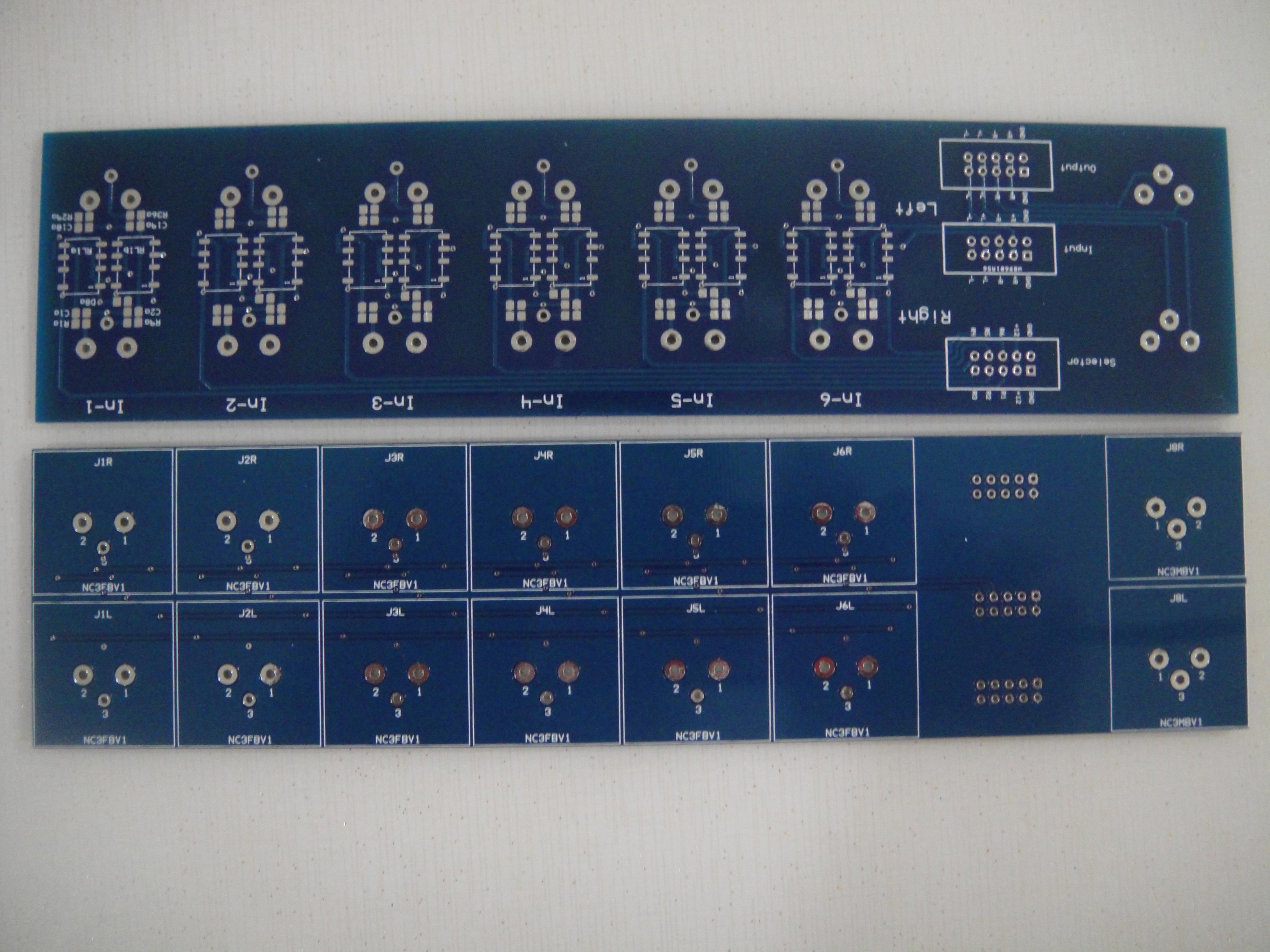

That's really a nice implementation for 6 inputs. I have build it as designed, as 2 inputs is enough for me.
But I agree, this little thing is so incredible it brings shame to a lot of so called hi-end boat anchors!

Thanks Jan. As I said I wasn't expect such performances.
I forget to mention... the 10K linear pot is installed on the front panel and is quite far away. I was afraid that the lenght of the cable can make some trouble/noise but the preampli is absolutely silent

are the round tubular resistors "melf" type?
Yes. They are the Vishay/Beyschlag MELF resistors as mentioned in the BOM
