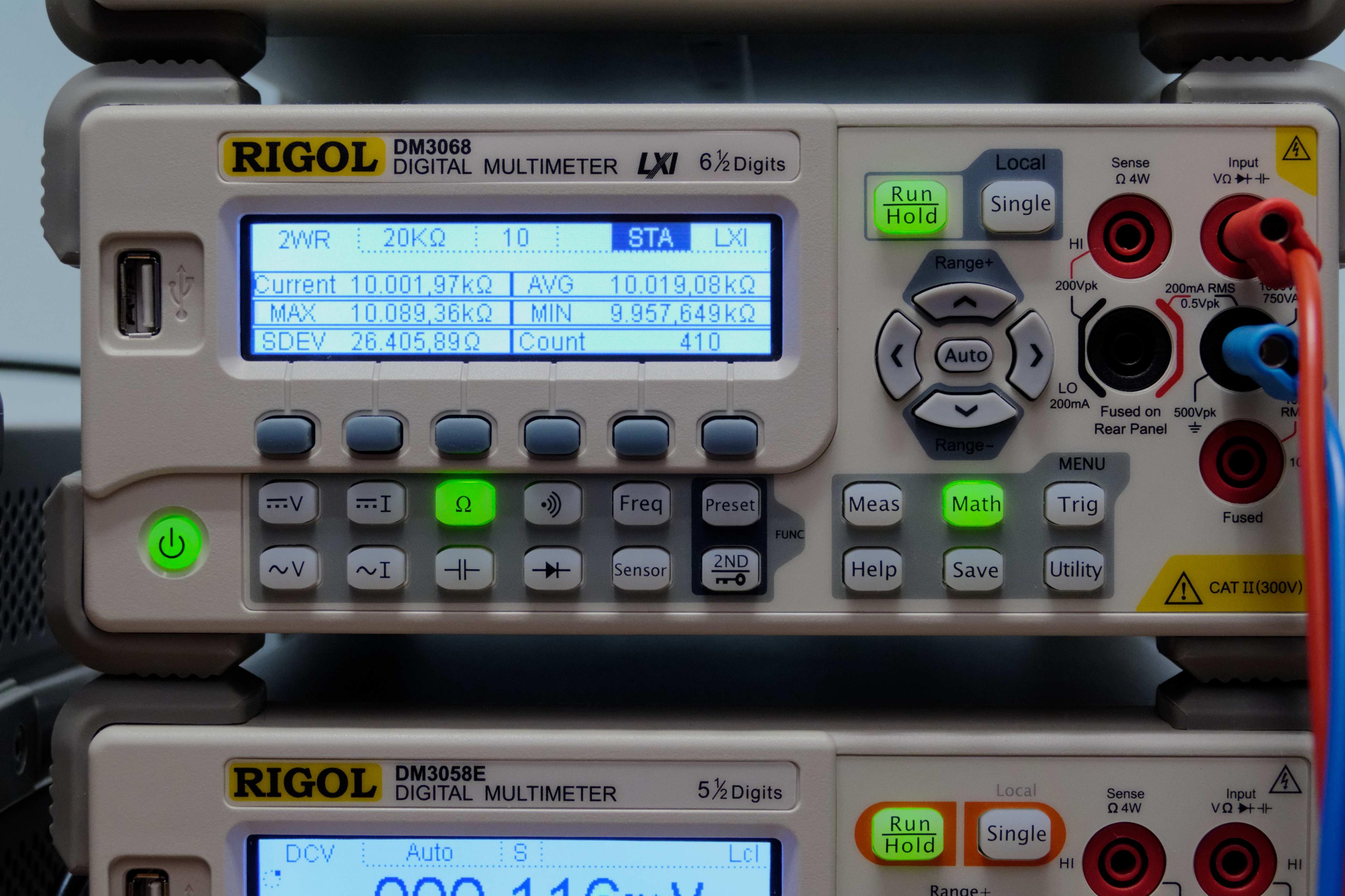

I started to do some measurements and tests on that "stereo" version I got.
Input resistance, which is supposed to be a "constant" 10kOhm, measured with some slight deviations over the complete range of 128 steps:
Max: 10.080 kOhm
Min: 9.957 kOhm
This is to be expected, because the resistor ladder consists of distinct values, which have to be matched to the steps.

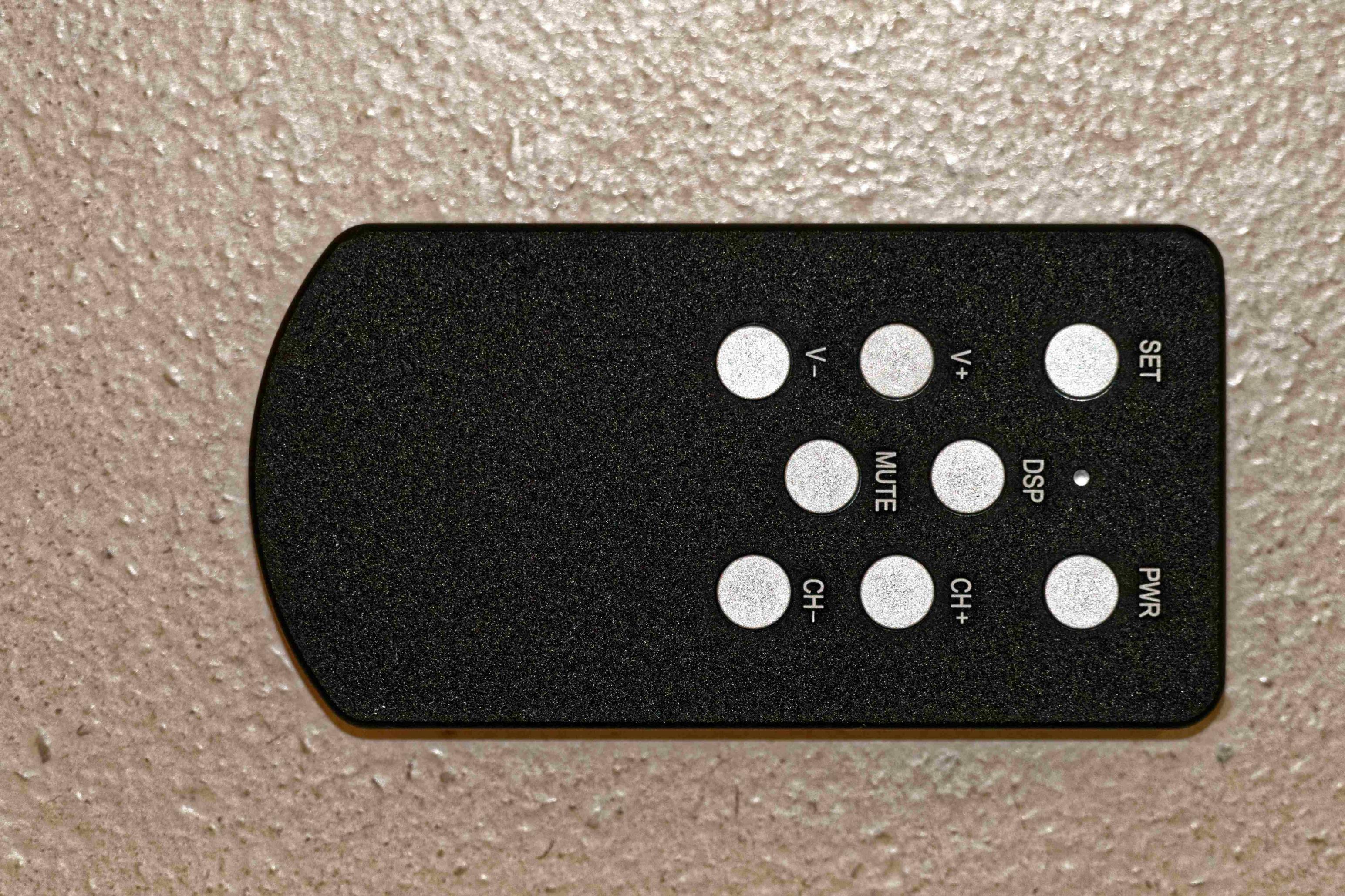

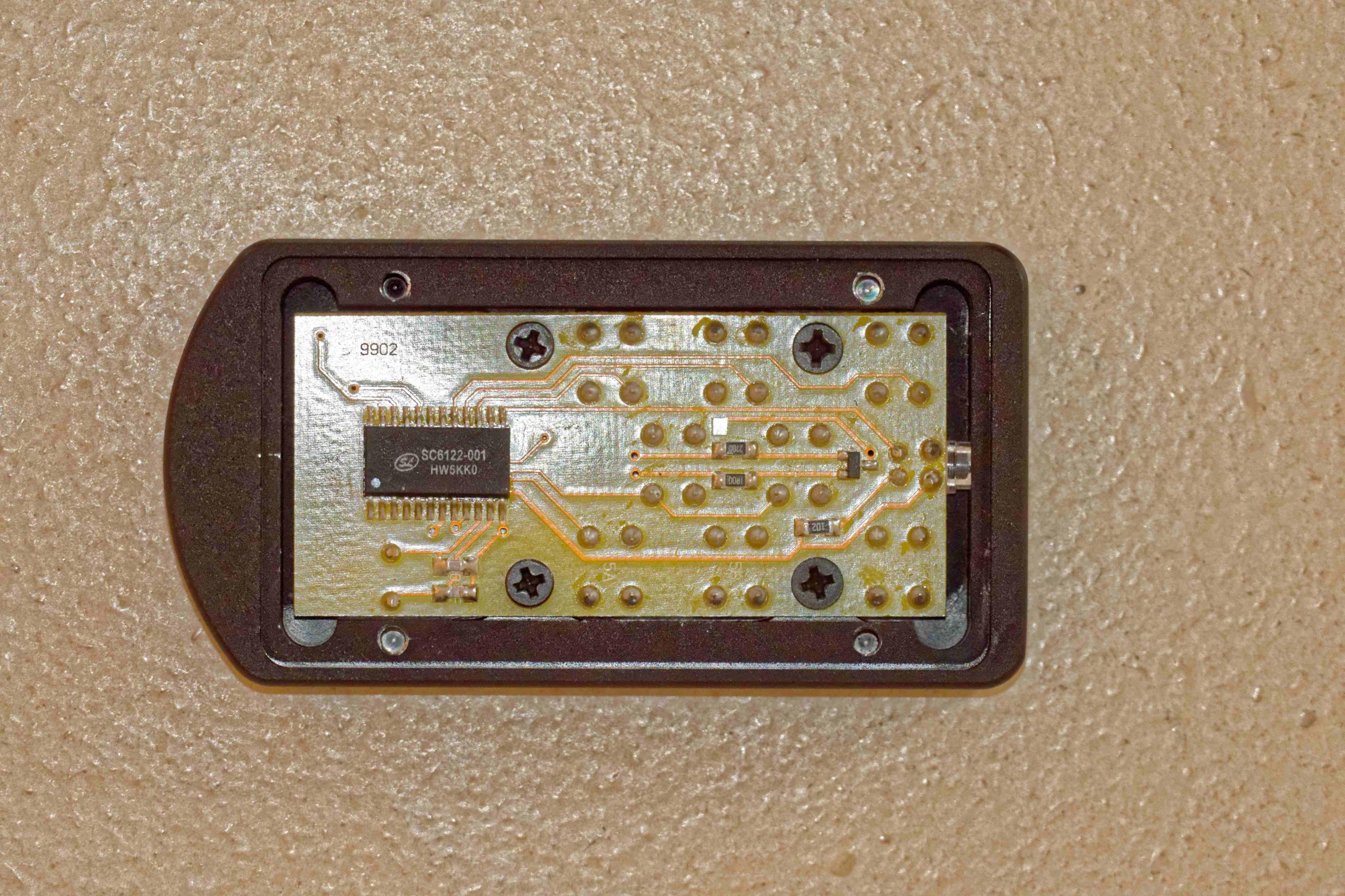

I opend up the IR-remote controller and inserted a battery (CR2032). Its really machined from a solid block of alumium incl. the buttons. Soldering (mostly SMT) was done by hand and OK, but the board hasn't been cleaned / washed thus some residue of solder flux was present, which I removed.

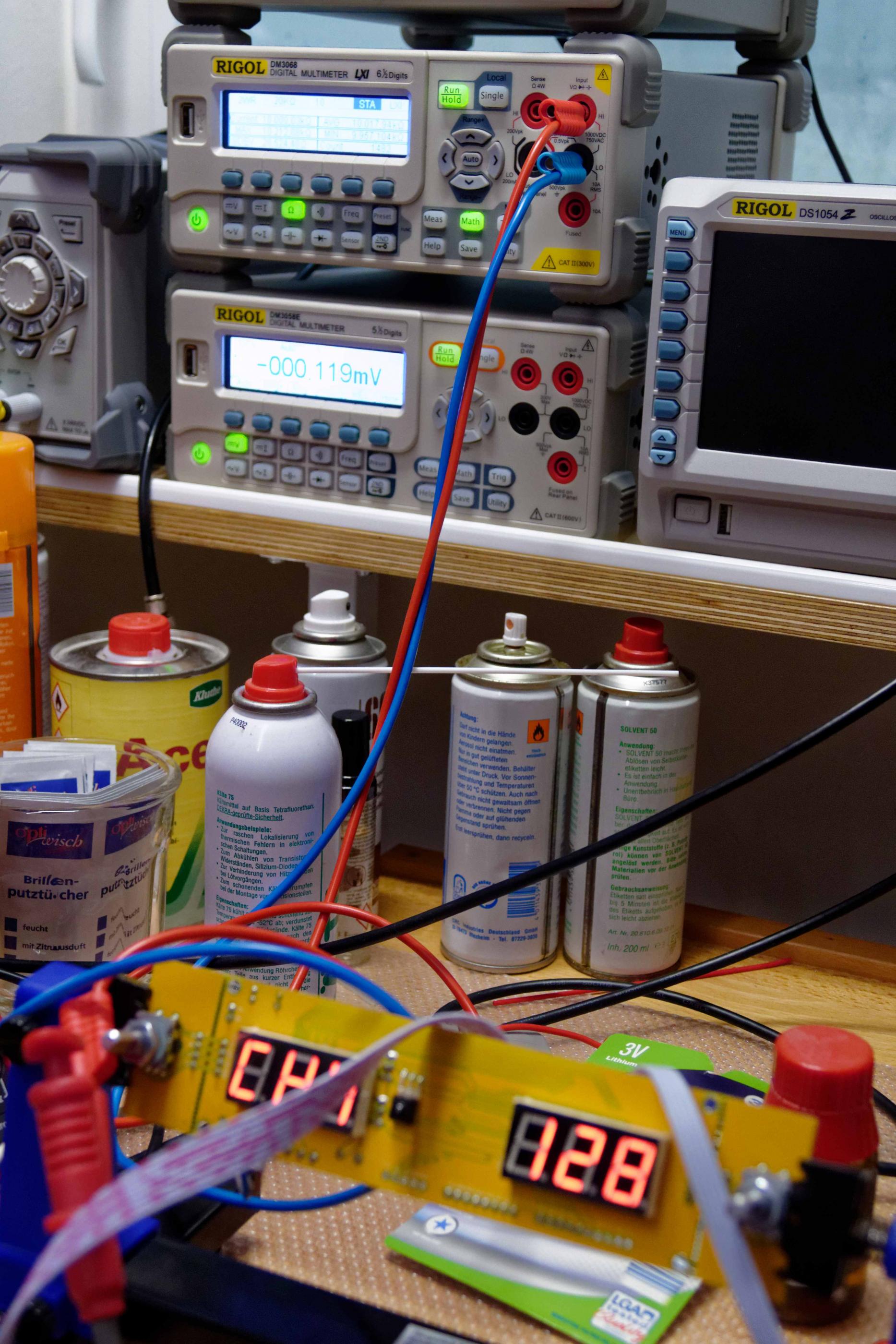

I connected the controller board (incl. relay board: attenuator and input) to my bench power supply (15.5VDC): power consumption is about 0.112 A. If all relays are active might be somewhat higher.T he stacked linear voltage regulators 12VD + 5VDC reached about 40°C (both) during continued operation.
I checked the functionality of all relays, attenuator and input board: OK.
The color of those large LEDs for input selection and attenuator steps is "red", which I did't like that much, but one can replace them as needed.
I checked the functionality of the IR-controller: input selection, volume attenuation, standby (pwr), mute, LED dimming (Disp, 3-5 steps) and setup (memory). Everything worked as expected. These functions are present (mostly) on the front panel too. Two encoders of the push and rotate type variety are used for that.
