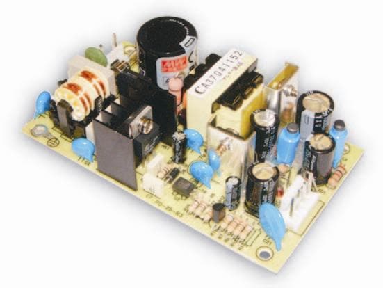

I even found an open frame type 15VDC / 1A, Meanwell RS15-15, which is even cheaper at EUR 8.80 plus shipping. Two of those would allow a +/- 15VDC symmetrical switching PSU of 1A output capacity...
http://cdn-reichelt.de/documents/datenblatt/D400/RS-15-SPEC.pdf
They are available from Mouser too... http://www.mouser.de/ProductDetail/Mean-Well/RS-15-15/?qs=%2fha2pyFaduhTgKandwNLmsBPFkvDXycwJ5WVIcxF%2f9zmuUVxUTrxOQ%3d%3d
And another open frame one, Meanwell PD-2515, which supplies both +15VDC and -15VDC at 0.8A each from one unit. Almost same price compared to two of those above.
They are available from Mouser too http://www.mouser.de/ProductDetail/Mean-Well/PD-2515/?qs=sGAEpiMZZMsPs3th5F8koEQpGtpkXN6kckxdQHLrinA%3d
This one seems to feature lower noise but somewhat less amperage.

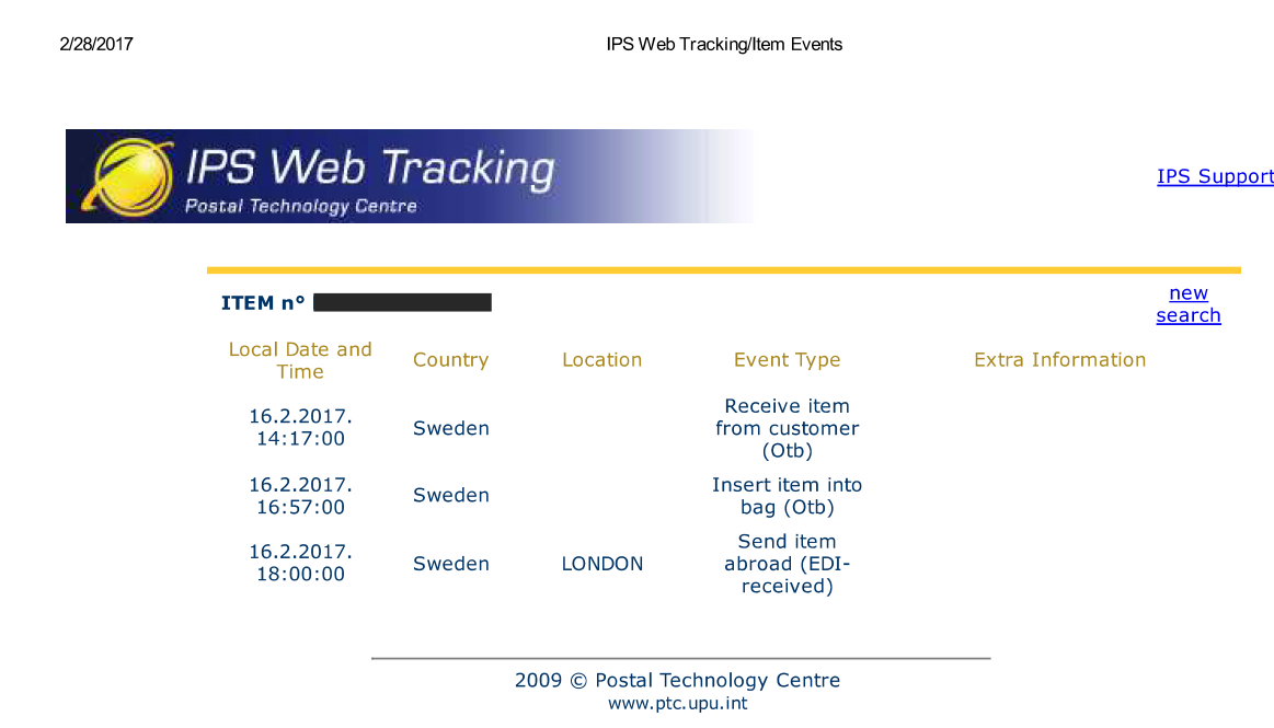

Hi Xavier,
It seems that my shipment is lost somewhere on the way from London to ???
I contacted a local mailing service and this was their (translated) response:
"Regarding your request, we want to inform you that the said consignment is not arrived in Croatia.
Therefore, please contact the sender, about the possibility of starting the inquiry process."
Therefore, I would be grateful if you could look at what happens to my parcel.

I ordered a couple of those Meanwell RS15-15 (15VDC / 1A) open frame PSUs as mentioned above, which have been delivered today.
I checked, if in- and output potential are isolated against each other and against PE, which they did. Therefore one could stack them for a symmetrical (+15.5VDC) - 0 - (-15.5VDC) power supply by just bridging one (+) to one (-) on the other PSUs output, using this as common GND. Adjustment range of the output voltage should be sufficient for fine tuning the supply voltage to the Hypex regulators.
The data in the datasheet from Meanwell are worst case specs, meaning that an average unit should be within specs with a safety margin: https://www.meanwell-web.com/en/download_datasheet.php?products_id=RS-15-15&type=2
To improve HF filtering on the input side of the PCB I am going to add some 0.1uF / 50VDC SMD (1206) ceramic capacitors across those 1000 uF / 25 VDC electrolyts whilst soldering them and feed the PCB power supply wires through an additional ferrite inductor. Judging by the block diagram from Meanwell the PSU supply side has an EMI filter installed already.
For an LDR type gain adjustement (replacing the linear pot) one could easily add another RS 15-XX PSU (i.e. 5VDC) of the same size side by side. They are really very compact in size: (LxWxH) 62.5 mm x 51 mm x 28 mm and shielded already.
Any comments ?
Any comments ?
I forgot to mention those 3A Schottky diodes across the output of each PSU for protection in case one of the PSUs fails...

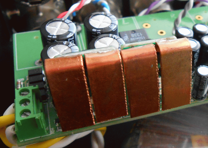

How hot are the Hypex Regulators getting during "normal" use. Do they need to be heat sinked (SMD transistor at top) ?

I soldered 4 copper strips to the two Hypex regulators.
Onto the soldered tab right at the top of each output device.

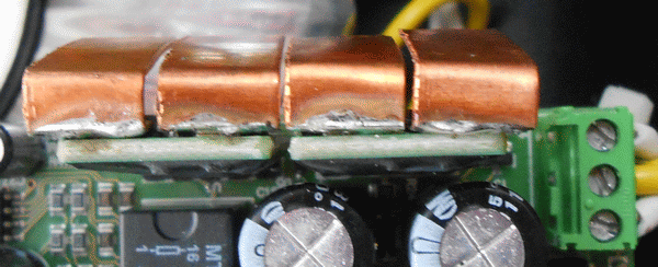

Two pics of the copper coolers added to the Hypex regulators.
Each strip is ~ 25mm by 8.5mm by 0.5mm thick. Bent into a J shape to miss the enclosure.
Soldering small copper straps to it conducts heat a lot better, but i don't like to solder to a finished module although I got some "big" soldering irons to handle the job. I fear damaging them... after I had a look at those regulators.
I am thinking now about a common small heatsink stripe affixed across the body of those two transistors, because they are electrically isolated.
How about that ?
the thermal resistance of the plastic package is likely to be too high to effect much cooling.
