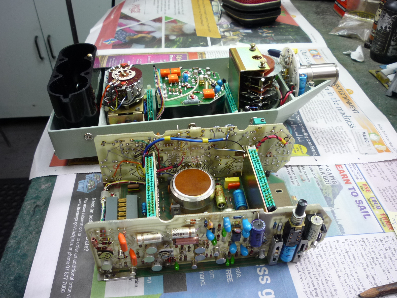

Hi Guys, new member and first time poster. Just hoping that there may be someone on here who is familiar with repairing these old B&K2209 analogue sound meters??
Background: I already own a calibrated B&K2209 sound meter that works well, but managed to pick up another meter fairly cheaply for parts earlier this year. (It's a fairly late model one in the serial number range above 699000, which i suspect is late 1970's, and this 2209 model was apparently discontinued by 1980 ??). After repairing the corroded battery terminals (seems to be a common problem) i tested the meter for basic function and surprisingly most of it seemed to work ok. The one significant problem though is that the peak hold function is not working properly - doing a basic 'hand clap' test near the meter the needle will deflect (right) up the scale and partially 'hold', but then starts slowly falling back to the left (towards zero). In order for the meter to meet specification, the needle must not fall more than 0.5db over 1 minute duration.
This was 7-8 months ago. I purchased the B&K2209 service manual online, and have had a look through that, and looked for other info online, including another thread about B&K2209 on this site from 2 years ago. I have checked out most of the old electrolytic capacitors. I ordered some replacement electrolytic capacitors as well as some polyester ones also (which showed obvious signs of cracking) where the capacitance readings were a little high. One of the electrolytics in particular was 50% low.
Anyway, things got really busy with my work so this (as a hobby/project) job got put on the back burner for 6 months. Finally got to have a look at it again in the last few days (due to Christmas break) and replaced some of the components i had ordered months ago. I have adjusted one of the potentiometers to get the correct 200V polarisation voltage for the pressure microphone. Then tested the meter for correct function. The problem with the peak hold (not 'holding') still exists.
I had assumed that it was maybe a bad cap not holding it's charge. But could it be something else like a bad diode leaking current back? Or something else, like the 'reset' switch for the peak hold function gone bad??

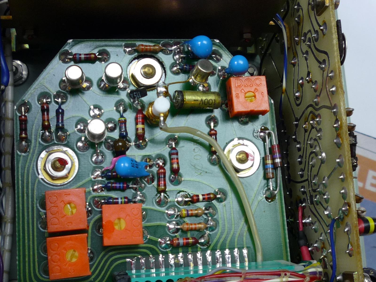

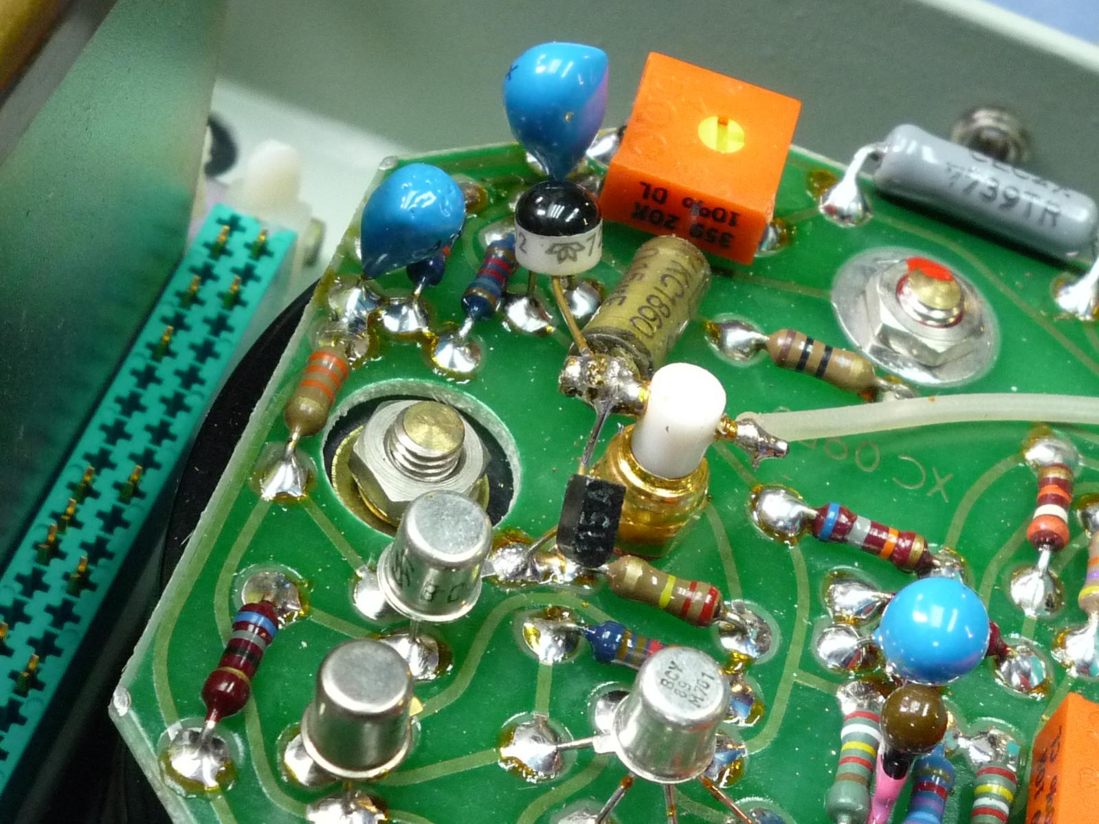

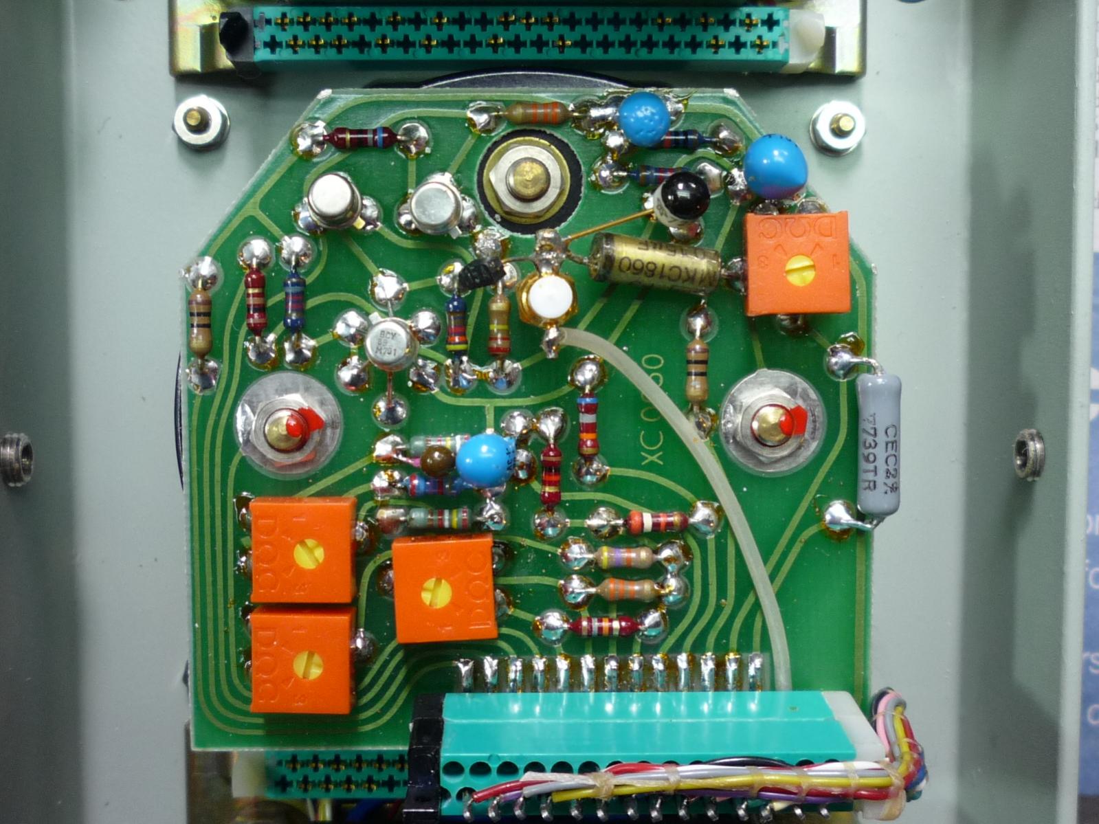

Thanks Mooly, there is one FET transistor that appears adjacent to the reset switch ('V604' FET N-channel E102) and there is a Polyester cap ('C604' 0.15uF/100V), and there looks like a diode above that as well.
Are the FET type transistors commonly prone to failure?
The guy that i got the service manual from has refused permission for me to post the circuit diagrams publicly. But if you are able to help me out then i could possibly email or PM a pic of the circuit in question directly to you?

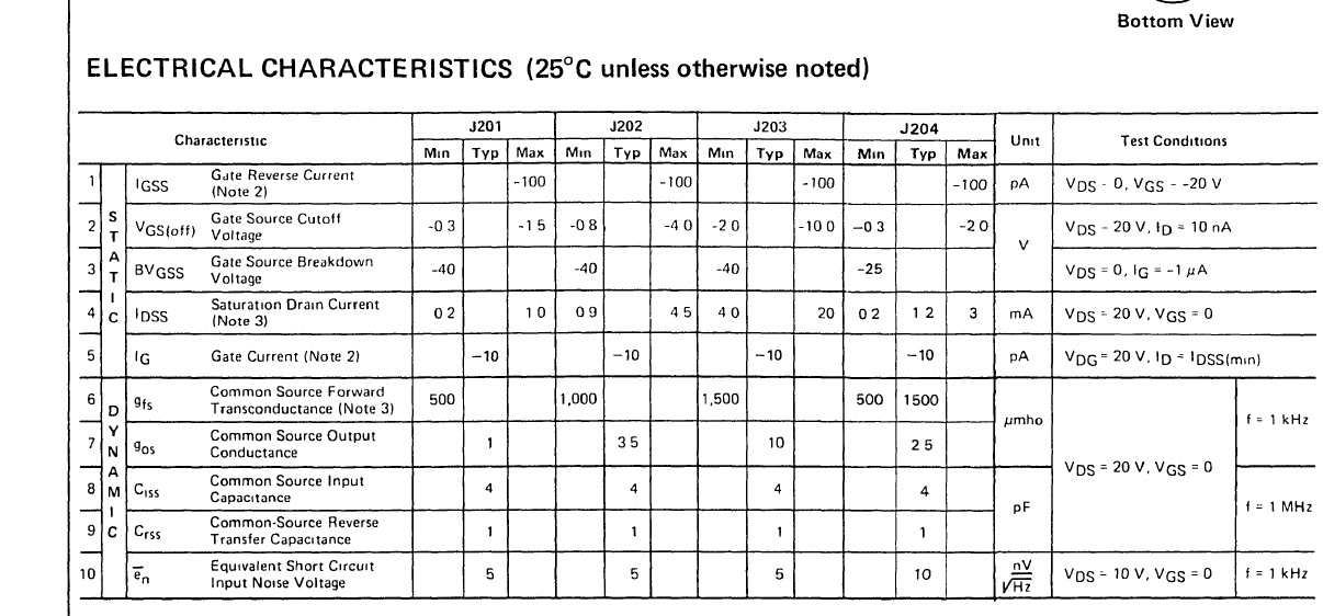

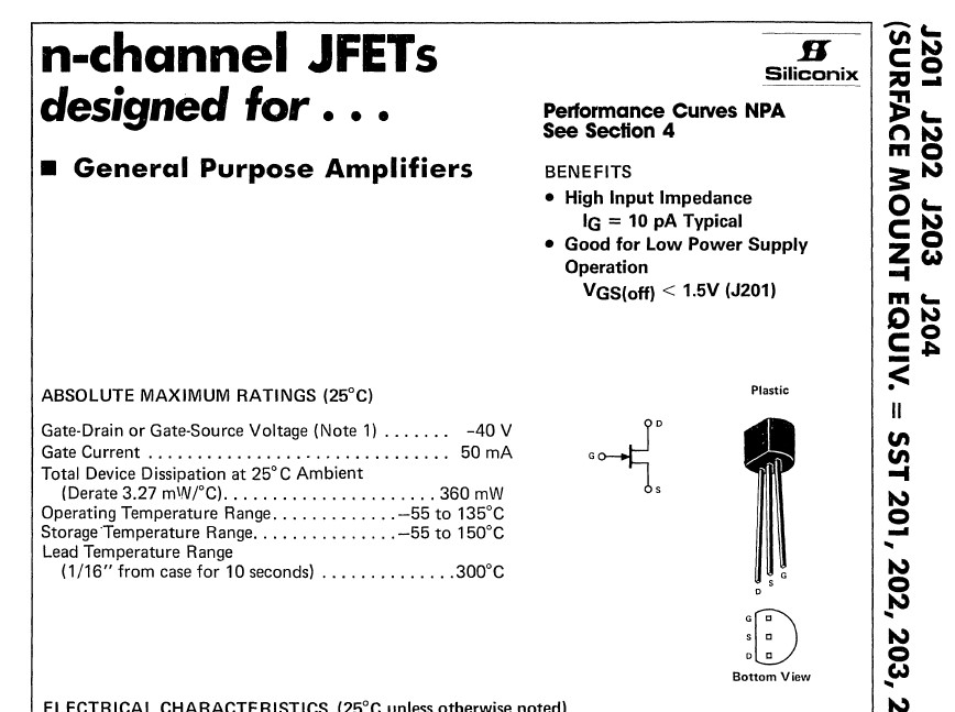

The E102 is a very old Siliconix device and according to the 1986 Siliconix data book is replaced by a J201 (and all these are long since obsolete).

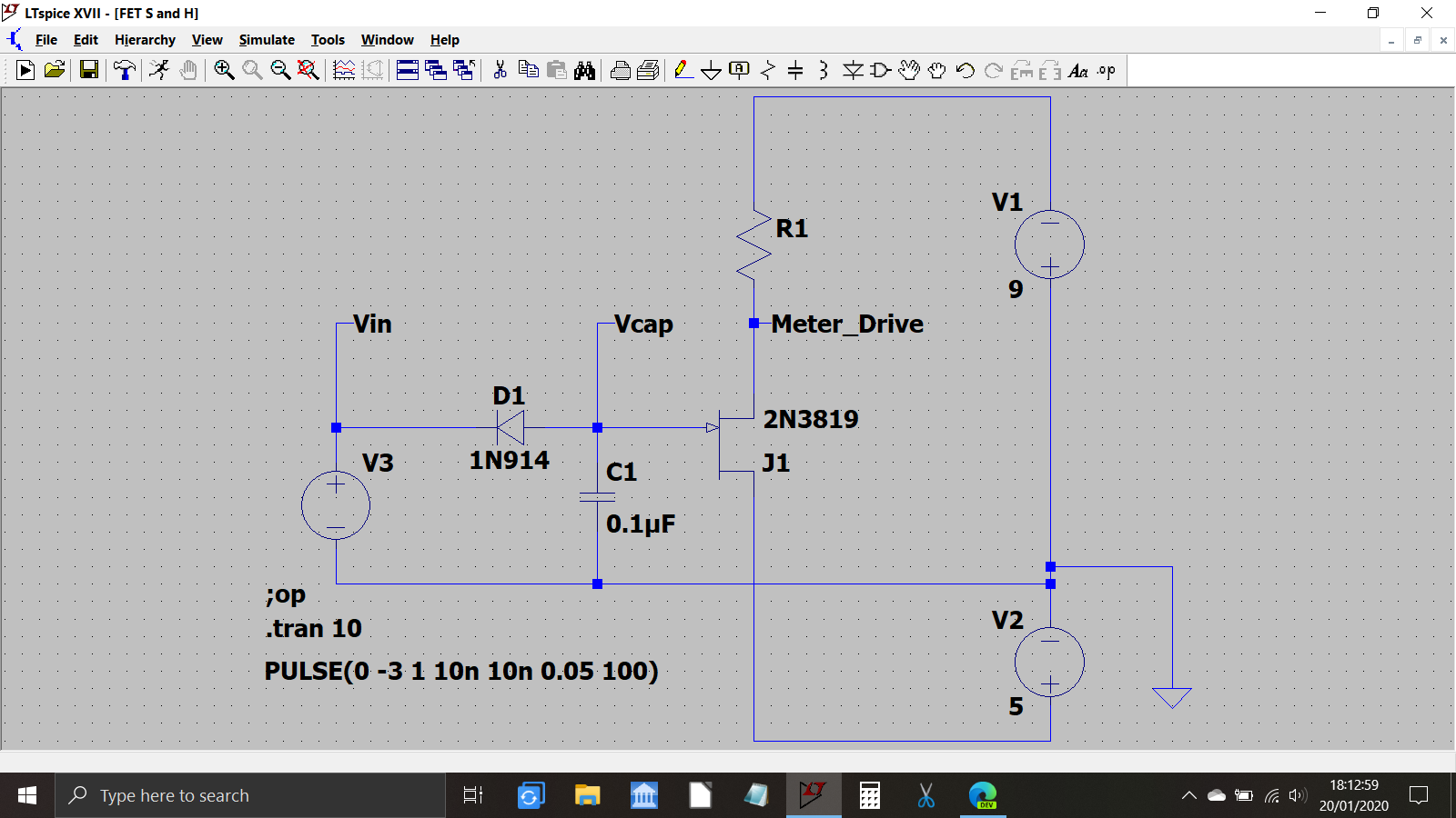

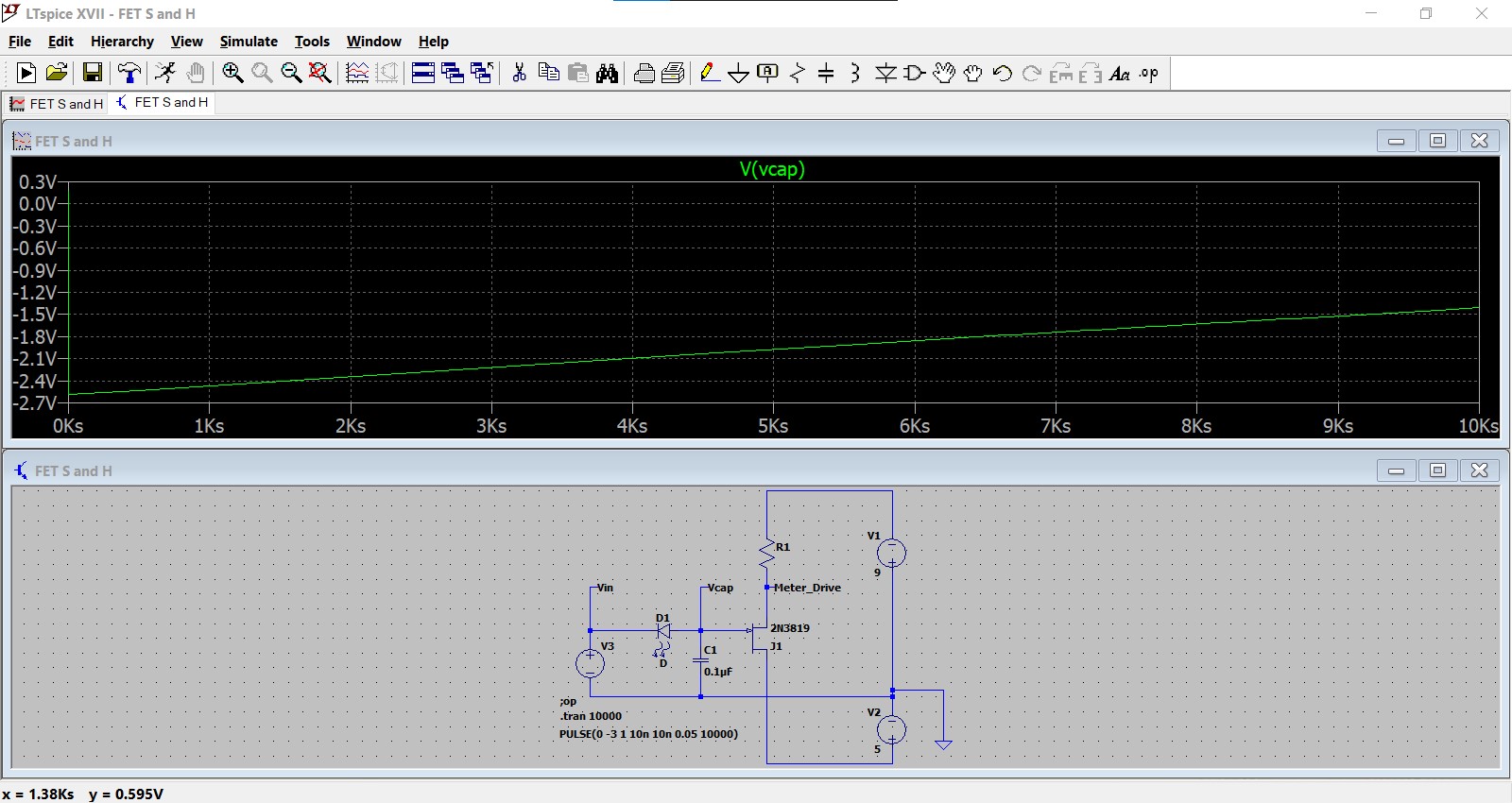

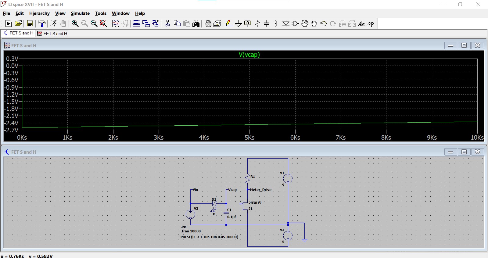

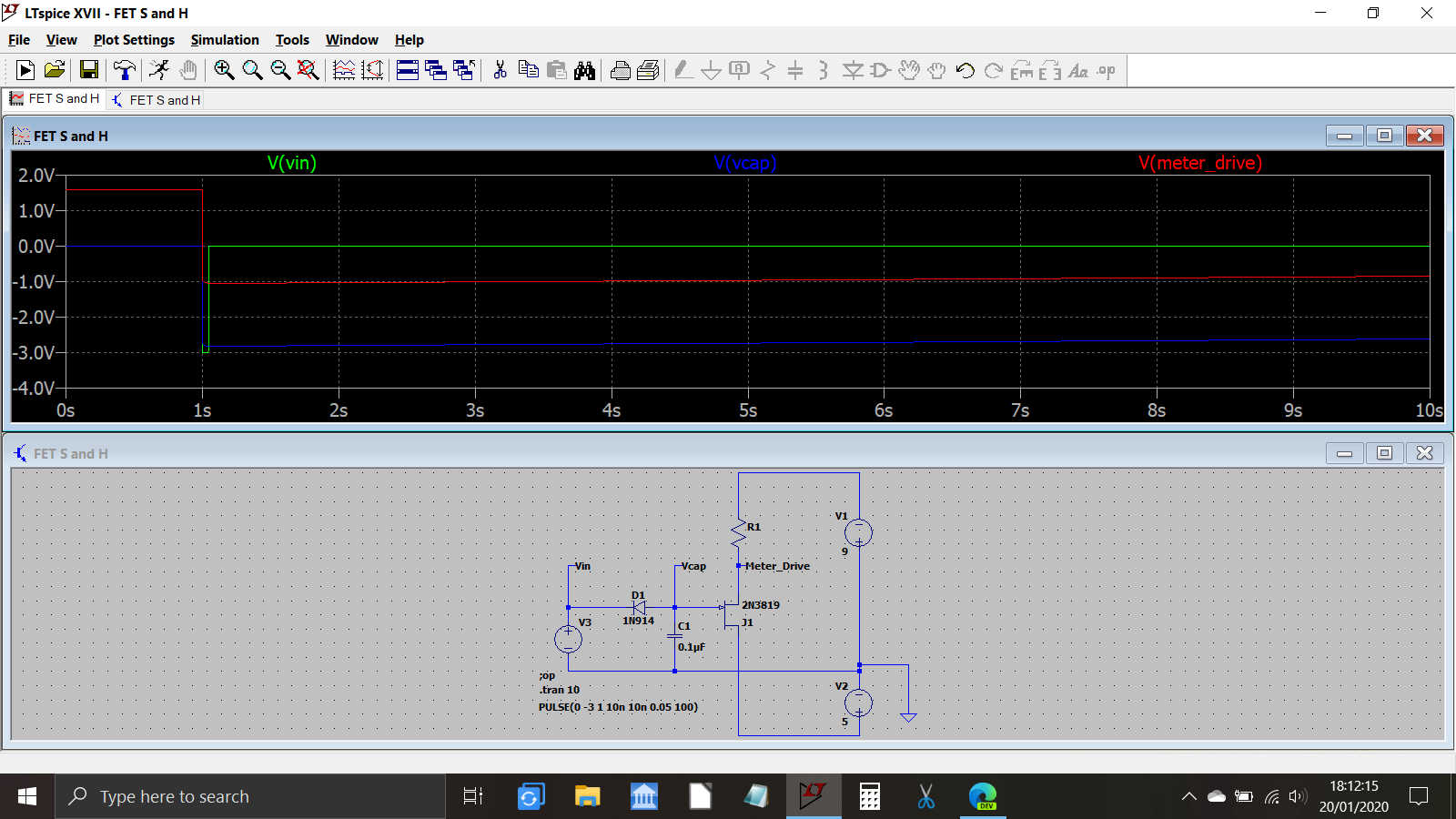

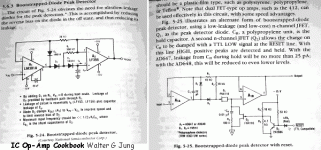

Just posting this in the hope it will clarify how the FET operates. The load on the FET (the meter) should not have any real impact on things.
Diagram #1 shows the basic circuit of an FET sample and hold.
Diagram #2 and 3 shows a 50 millisecond negative going pulse applied to the diode. That is the green trace labelled Vin.
The blue trace is the voltage on the cap. Having initially charged to the peak pulse voltage (less the diode forward volt drop) it is then slowly decreasing over time due to leakage of the diode. The diode simulation model includes this property although I don't know how accurate it is.
(I must admit I'm surprised how much a I1N4148/914 type diode in simulation at least has such an effect... must look at the real data sheets for these 🙂)
The red trace is the meter drive voltage. The FET has essentially no gate current and so how the voltage across the cap is maintained depends solely on four things:
1/ Is the cap leaky? No... you have proved this.
2/ Physical leakage due to contamination.
3/ Diode leakage.
4/ A faulty FET.

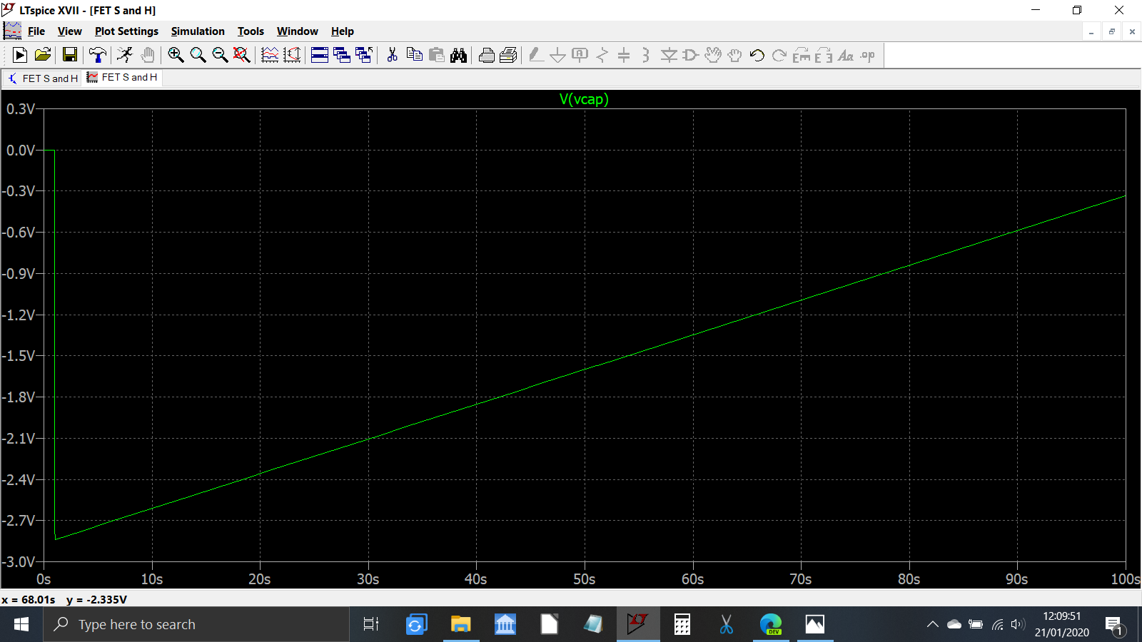

The last image shows the cap voltage over 100 seconds using the simulation models leakage current for the diode as the factor that pulls it down.
> decreasing over time due to leakage of the diode..... (I must admit I'm surprised how much a I1N4148/914 type diode...
Small-signal (computer) diodes are doped for good conduction in small size (speed, price).
It was common to find a JFET Gate-channel diode used as the passive peak switch. A JFET Gate does not need high conduction, and the only great feature of JFETs is small input current. JFET gates will reliably have lower leakage than any common diode
To meet a "0.5db over 1 minute" spec we need super low leakage in several parts, so probably more to it than your tutorial shows. The old app-books are coming apart, but I remember bootstrapping a diode-connected JFET so it had zero voltage in the hold mode.
(You've seen the audio switch with a diode driving a JFET gate? It looks like it can't work, the arrows are in opposition. In fact it works reliably because of diode leakage being greater than Gate leakage.)
Yes, I have seen the JFET switching you mention, I think NAD relied on leakage in one of their designs.
In the simulation I found that LED's had the best (lowest) leakage. This is with and then without the FET and running for 10,000 seconds.
I've no experience re leakage of LEDs, but I do know they can be photo-receptors as well as emitters. So if you try LEDs for low leakage, make sure they are completely blocked from ambient light to preclude any photocurrent leakage.

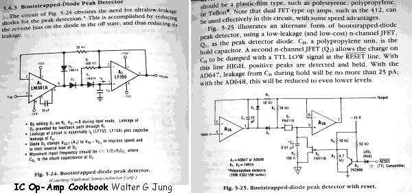

Bob Pease offered diode leakage advice in some of his columns. If memory serves (uncertain these days), 4148 diodes have gold doping to improve switching speed at the expense of leakage. He recommended using a transistor's base-collector as a low leakage diode. I believe he also mentioned using the gate-channel junction of a jfet. Sorry that I can't point to specific link.
Link to copyright material removed. If you can provide proof that it is not restricted, the link can be restored.
I suspect the diode is part of the original circuit so it's characteristics would already be accounted for. I have found in old General Radio sound level meters the lubricant used on the switch contacts becomes conductive from oxidation and causes the meters to fail. Using alcohol to clean out the switches and then lubricating it with modern chemicals fixes the meters.
Hi Guys, seeing as there has been a flurry of activity on this thread recently i felt i should give a quick update on progress to date.
I appreciate all the help and information that has been put forward, but must acknowledge the assistance of Mooly in particular who has been really helpful and PM'd me with some good info.
So we have eliminated the following possible faults:
1. The capacitor C604 seems to be good. (Polyester 0.15uF/100V)
2. There is no leakage across the reset switch (with the switch disconnected the needle drop still occurs).
3. Same with the 'diode' Q601 (a Si. trans NPN SF115A) that seems to be working ok.
4. The most likely cause remaining is the FET (shown on the parts list as an E102 N-channel), but on this particular unit they seem to have used a Teledyne 2N4302 (7234) 'Glob top' instead. (See pics attached).
So, at this stage i think i have managed to find a source in the UK for the old FET's, so i will order a few of those and hopefully in another week or two when they arrive (and i have time to look at the meter again) i will try a new FET and see how it goes, then report back.

Further update, just out of interest i managed to find (google) a PDF copy online of an older 2209 service manual (from serial # 496282 onward that was posted online by someone in Sweden i think?) so i think there should be no copyright issues with attaching a couple of pages on here. (plus they are from the early 1970's, and obsolete models, so i would think that any claims of ownership/copyright of info that is already in the public domain would be invalid.) As far as i can see the details seem to be the same as for the later models in the 670xxx range,
Also, the previous pics i posted of my faulty meter (serial # 699xxx) showed the FET as a teledyne glob top unit. I will attach here a pic from my other meter (functional and calibrated - serial # 670xxx) that shows the 'V604' FET as a metal-top original E102 7528 unit, which is what is listed on the parts/layout sheet. So i'm not sure, but it's possible that at some stage they changed over to using Teledyne 2N4302 FET's instead of the old E102 N-channel FET's ?
