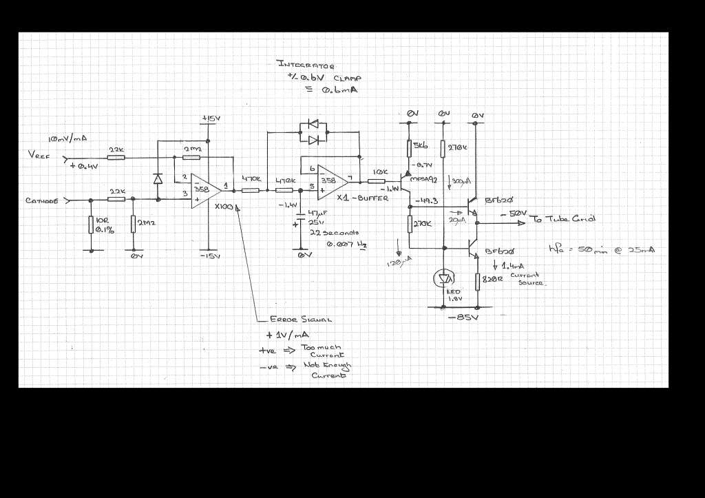

For simplicity I like the Menno/Guido scheme where signal is clipped in a very narrow window around the idle voltage. They do this with a diode clamped integrator which means that you need a enough gain after the integrator for a 0.6V max signal to achieve the full bias voltage output. I also like their bias output amp, why? because it is current source loaded which isolates the bias voltage output from any residual noise on the -ve rail.
Here is a part schemo - Mods Alert, please remove post if deemed inappropriate.
Ian

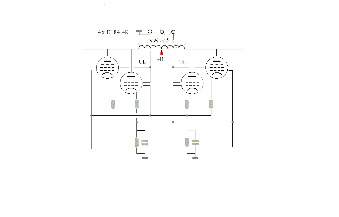

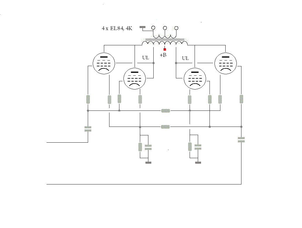

regarding paralel pushpull
maybe I'm completely wrong, but I suppose with the Blumlein you could use non matched tubes in paralel
wouldn't both of the two tubes in paralel try to 'allign' with the other two tubes .....not perfectly, but in a sense be 'auto-matched' 😕
