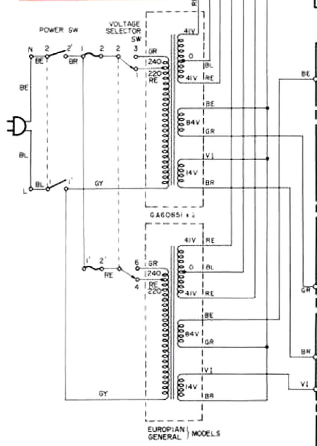

I took a quick look at the service manual and it looks like
those transformers may have 2 primary windings. So you
might just rewire it to get a 40v center tap transformer to
get you about 25v + & - . Oh when Nelson did his Burning
Amp talk about those fets 3 or 4 years ago he mentioned they
were almost imposable to find and over $500 each when you
could find them .

Thanks for the suggestion, if I could keep the transformers it would be great! 🙂I took a quick look at the service manual and it looks like
could find them .
When looking at the schematic and the amp it looks as it's only possible to choose between 220V and 240V (this is the seeting now) för primary side on each transformer.
But if I connect the two transformers primary windings in series instead of in parallell as it is now, all of the secondary voltages would drop to half? Giving ~20-0-20 as you pointed out.
