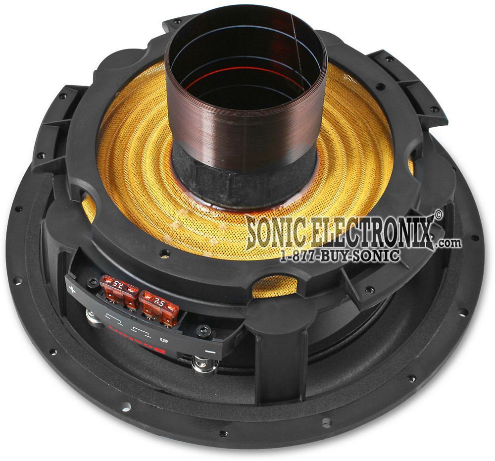

Yes continuity is good
possibly overdriven (900W RMS Amp, subwoofer 450W RMS and 900W Max) but the coil is dark when new too, as you can see on the joined pic, so I'm not sure about it
Tried to add some tin on the original solder, but the new tin doesn't go in the old one
Did you do as I suggested?Tried to add some tin on the original solder, but the new tin doesn't go in the old one
What do you mean by 'tin'? Use a tin and lead flux cored solder.
FE3T mentioned the possibility of the voice coil being aluminium and aluminium/copper joints are notoriously difficult to solder.
Do you know if the voice coil is copper or aluminium?
