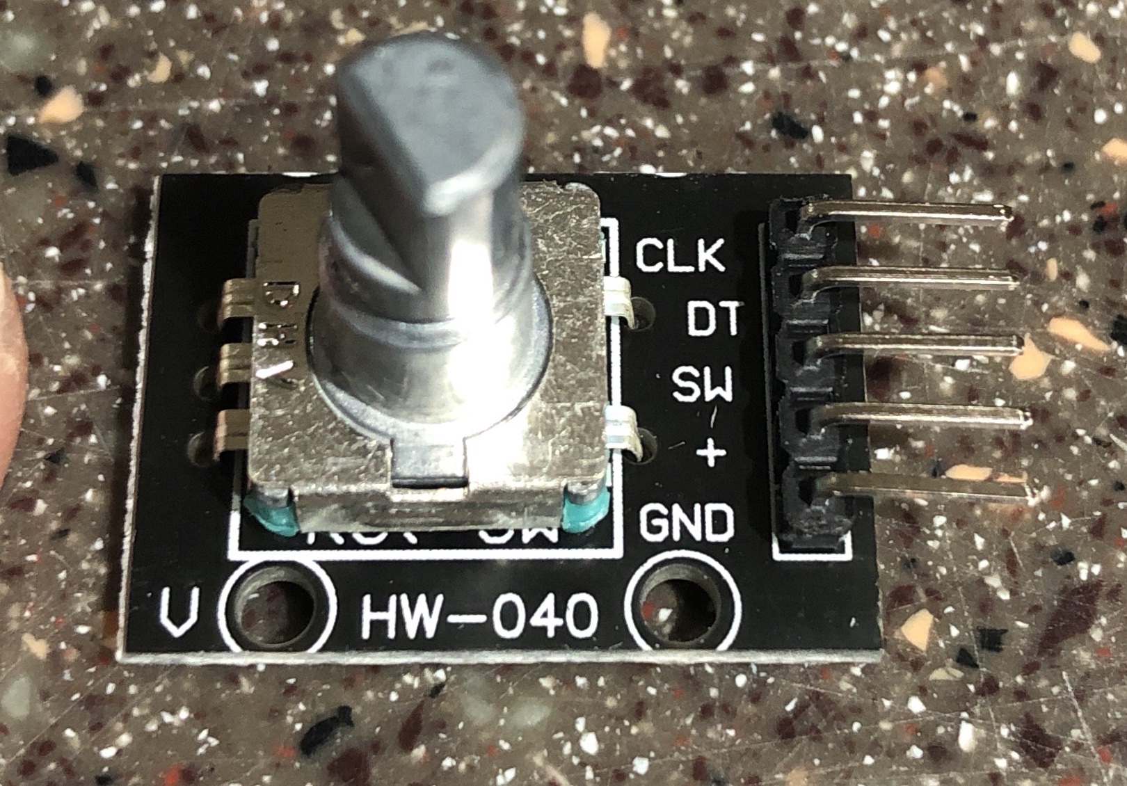

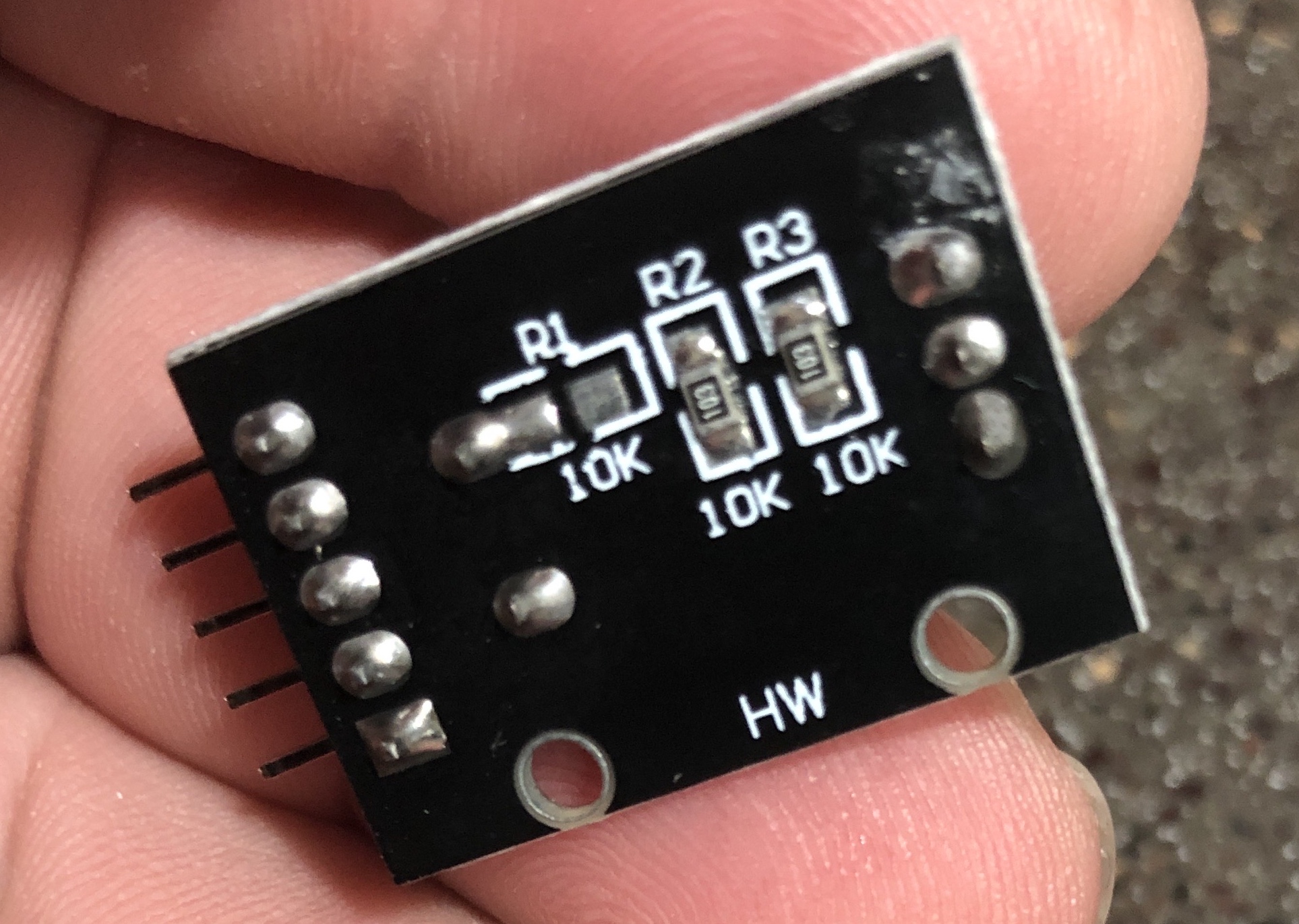

Here’s the one I found that I had ordered for one of my tube amps and never used II just removed it from the bag for these pics

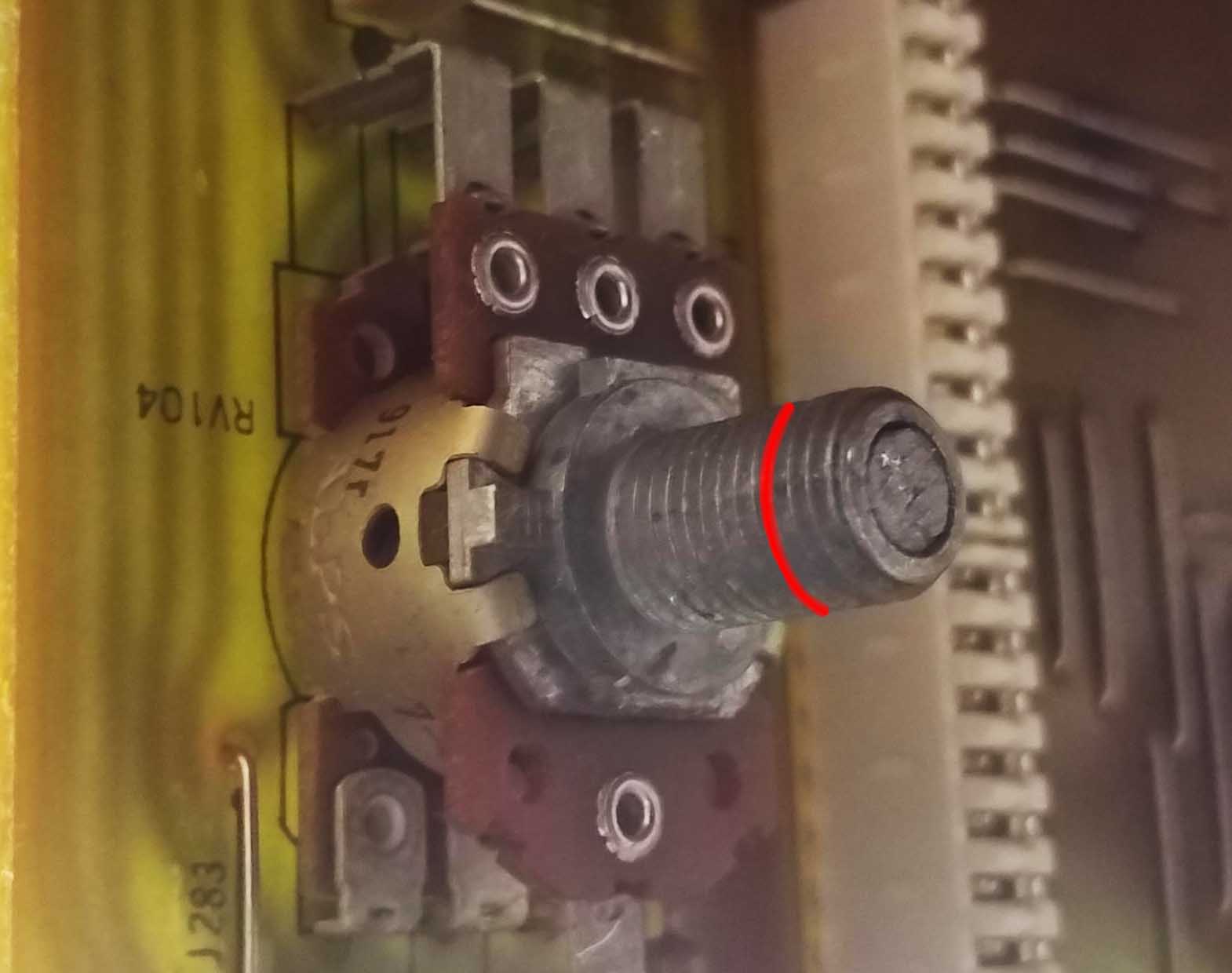

It would be a very difficult cut without removing the 8-leg pot from the PCB or some elaborate custom tooling. Also metal-dust in a pot is not a good idea.
I admit I don't have any good idea. In desperation I might try drilling a 1/8" hole in the stub, epoxying a 1/8" rod (without getting any slop on bushing!!), and drilling the busted-off piece or a replacement 1/8" and joining with 1/8"ID rubber fuel hose. But it is likely not going to be straight, and I don't know if everything will fit.
I HAVE lived with a busted-off stub on a pan-pot. There was enough fracture sticking out that I could put my thumb on the butt and turn it. It was an 8-ch mixer so I assigned some input which did not need pan to that channel.

OK, I would use a 100 kOhm Alps Blue and mount it on a bracket. There are no substitutes for this potentiometer model. You won't have the loudness stuff anymore. A member here sells remote controlled replacement potentiometers with MUSE attenuation. These probably can be made to fit too.

This does have the loudness built into it. Just push the knob in
