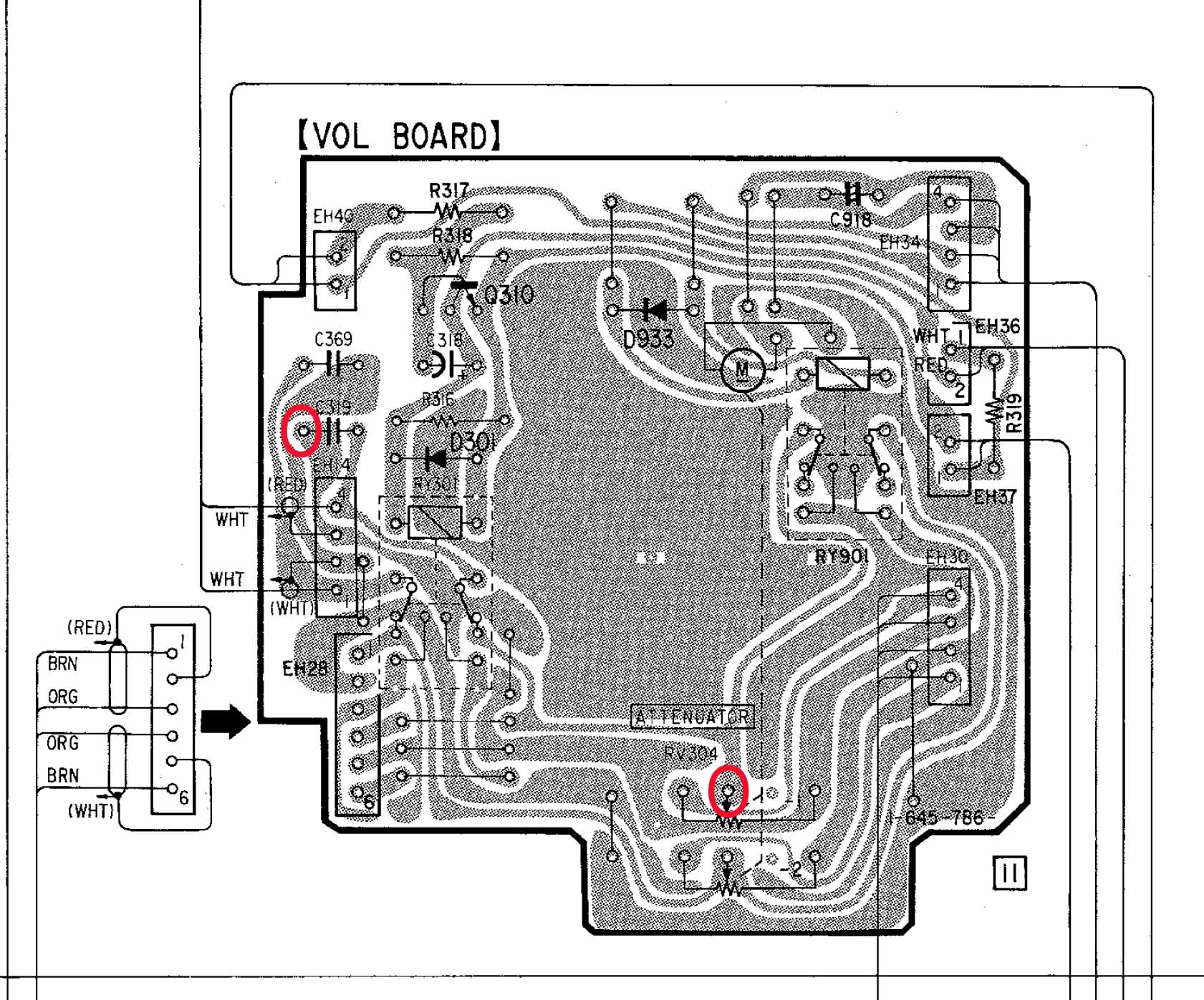

I think I got confused when measuring continuity on your blue line. I revised my original test points because I think I measured the wrong side of C 319.
Here is a picture of the volume board from the manual. I circled what I think is now the correct test points. My new measurement fluctuates between 6 and 7 ohms. That is if I'm measuring the correct side of the capacitor.
When I measure from C319 to the input grounds I get 504 k ohms. And when I measure from C319 to direct input and preamp output ground fluctuates between 2 and 3 ohms.
Those readings seem "OK" The middle pin of the volume control is actually the wiper but with the volume turned on minimum it should connect to ground, and from those readings it appears to be doing so.

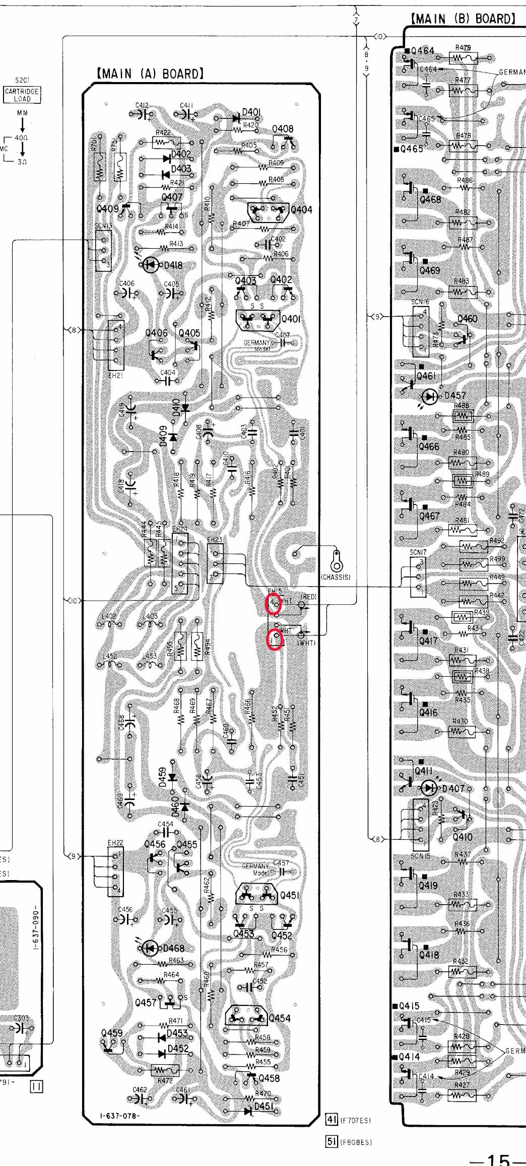

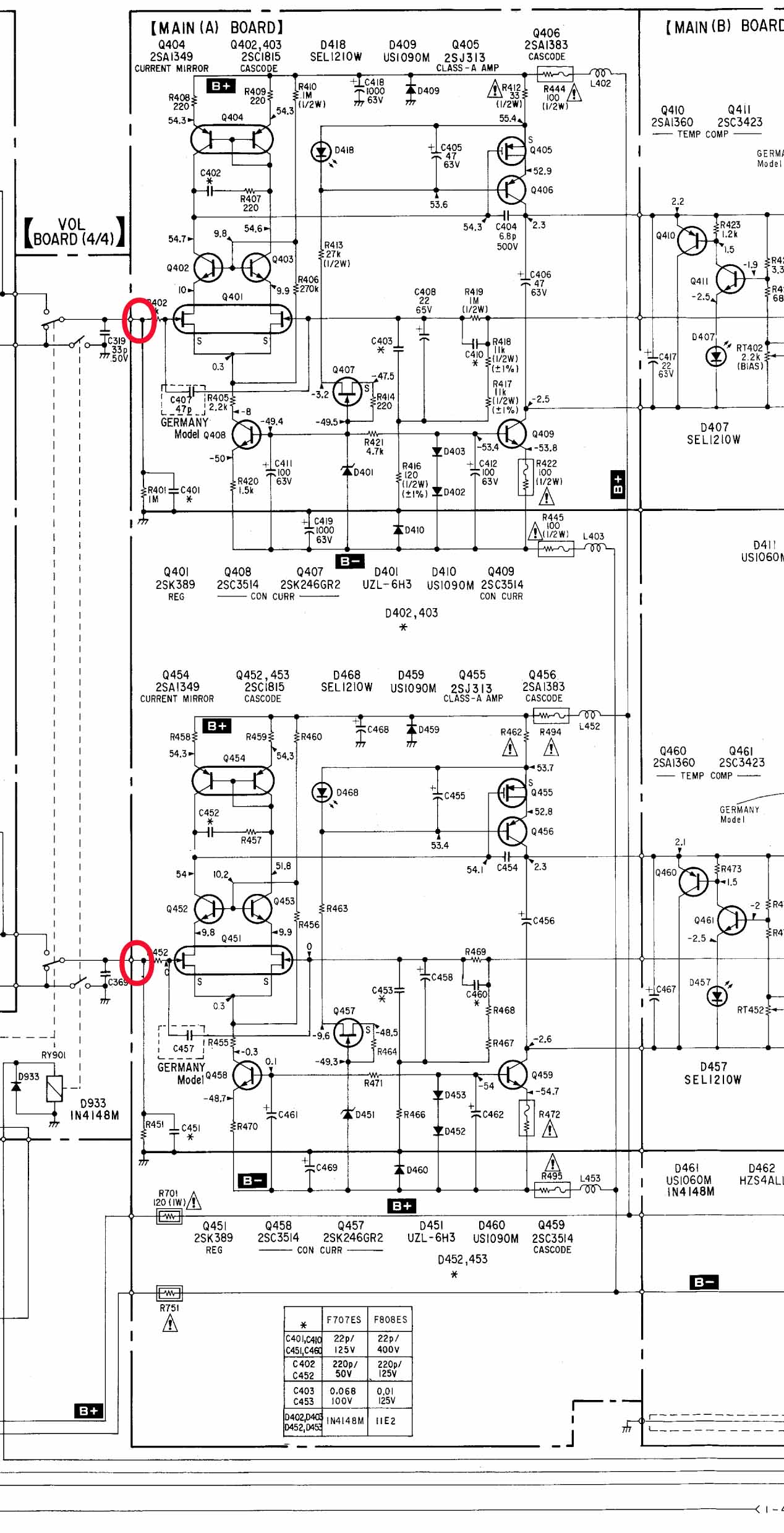

Does this look like the correct place to try power amp in from a preamp or variable output source?
I circled on schematic and circuit board layout where I think the power amp in is located? Am I correct? Can I just unplug jumper and use jumpers to connect from variable source?
Yes, you can separate the pre and power amps at that point. Be aware that the high gain of the power amp means that the replacement pot must be soldered in before powering up. Don't leave it floating. And use a bulb as I mentioned to protect the speakers and amp in case anything should go wrong.

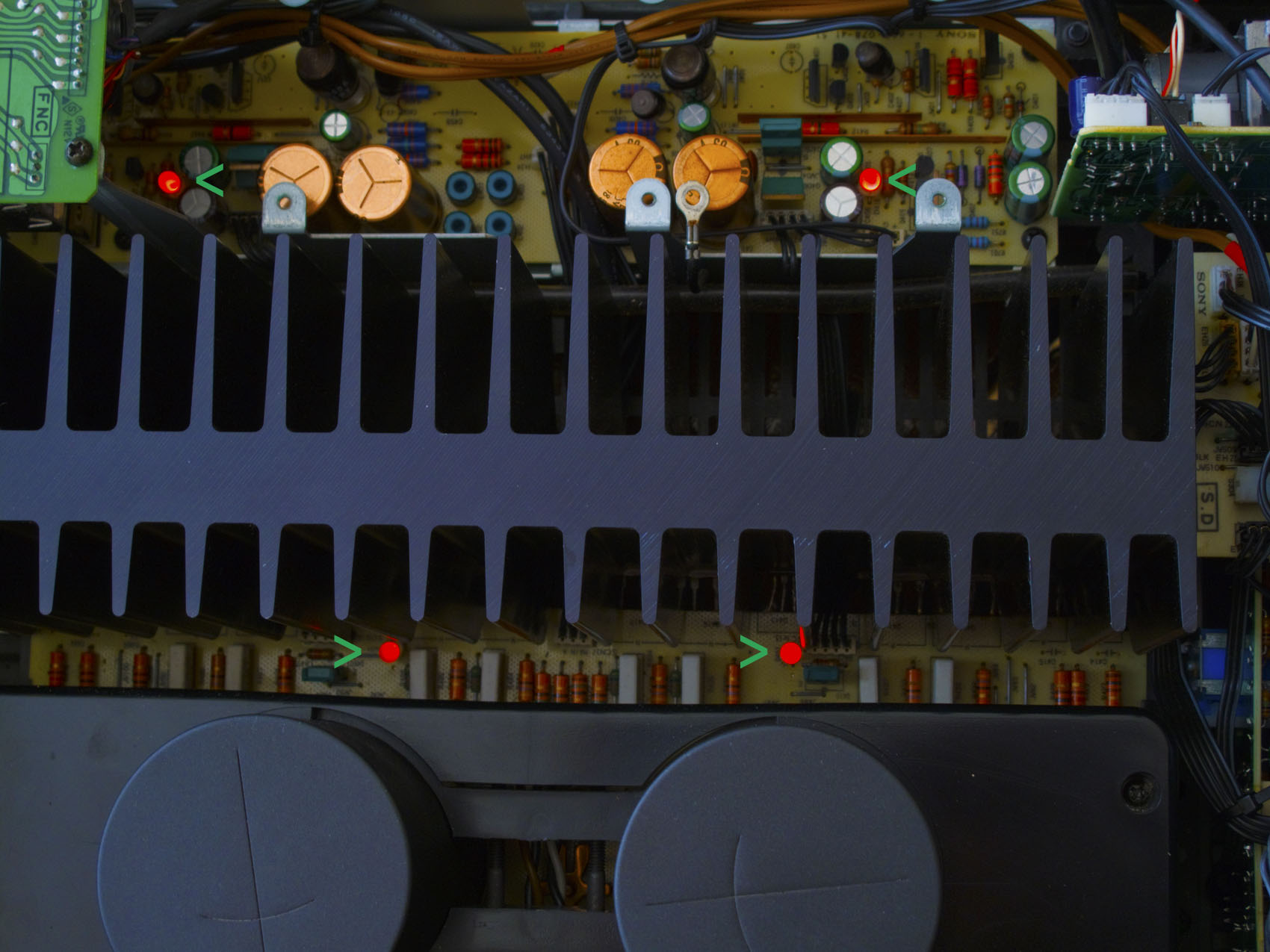

I hate to be a bother everyone again. I feel like I'm a bother, but I have another observation. I unplugged the jumper that goes from the "Volume board' to the 'Power A board' so I could use just the power amp section.
What happened was that one of the red LEDs on the 'power A board' went out and the amp wouldn't come out of protection. I turned amp off and on and this time the other led went off and it wouldn't come out of protection. I plugged the jumper back on and now both red leds on the 'power A board' are lit as well as the two red leds on the 'Power B board' like from when I purchased this amp in its broken state.
This is the way it was from the onset. I assumed that if the humming problem can be resolved that these four leds would turn off, or turn green. Here is a photo of them. The top board is 'power A board' and the bottom board below the heat sink is the 'power B board'. I put a green arrow pointing to them. What do you make of these LEDs?
Red LED's are often used as a source of generating a stable voltage. The voltage dropped across them is constant and that can used to set precise current flows in sensitive parts of the circuitry, current that is then insensitive to variations in overall supply voltage.
Two leds are used as a cascode reference voltage drop (D418, D468), and two are used as a voltage drop in the bias circuit (D407, D457). Both should always be on. They are not used as indicators.
If they are going out, there is a problem. D418/468 going out would likely lead to the unit getting stuck in protection as without this voltage the VAS stage (formed by Q405/Q406 and Q455/Q456) will not work.
The audio comes into the power amp by the connector labelled EH15 on the "Main A board" - that's the topmost board in your picture with the 4 gold capacitors on it. That should be the only one you disconnect.
It doesnt help that the schematic diagram completely omits the inter-board connections.

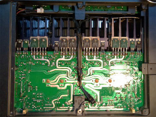

How do I go about testing mosfet power transistors? Here is a photos of the underside I pulled of the web.
I tried hooking a source direct to the power amp section at connection EH15. I small puff of smoke came from the heat sink. I immediately shut of the amp and discontinued testing with sources to the power amp portion.
Now the sound is quieter still, so I must have blown a few power transistors. The sound still has the loud AC buzz/humming.
If the FET's have failed then they will most likely have gone short circuit between drain and source. You can check with the amp off and using a meter on low ohms range but, as already mentioned, and with the greatest respect, I think this really is too complex and ambitious a project to cut your teeth on.
