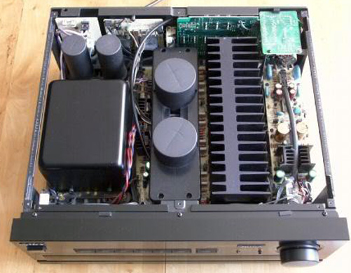

I see two pairs of large caps. Which should I check?
Here is a photo of inside from the web.

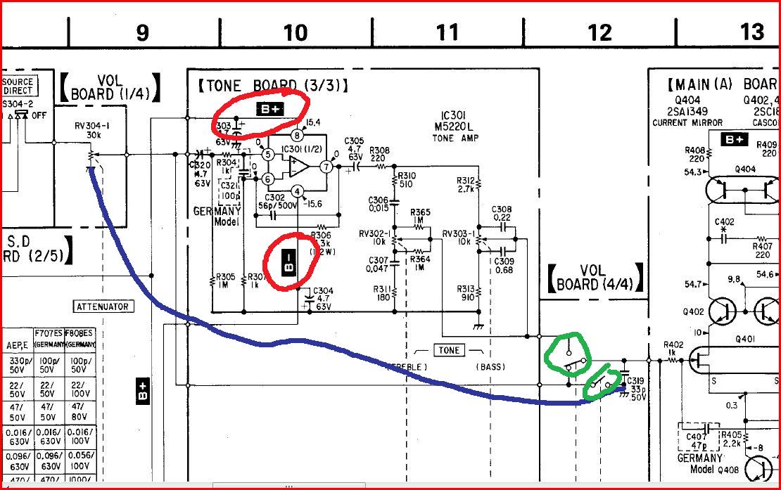

You are looking for perfect (zero ohms) conductivity between the signal input ground on the power amp initially back to the volume control and from the volume control back to the input sockets. The signal input to the power amp should also follow with zero resistance (assuming no series components) back to the wiper of the volume control control. The input to the volume control should then find its way back to the input sockets via any switching.

Check for continuity as per blue line. Check the plus and minus 15.6 volts is correct on the opamp. The relays (green) complicate things because I don't know what position they default to with no power applied. As drawn they are correct for a direct input.

Molly,
Do you want me to measure continuity at each end of your blue line for a short, as well as voltage being 15.6 volts?

1. + meter's lead to B+ & - meter's lead to ground
2. + meter's lead to ground & - meter's lead to B-
they should be identical...(maybe around 15V or so)
As Molly ask, yes you must check continuity on the blue line should be zero ohm (or zero volt).
If you check voltage on the blue line (15.6 volt on it) yo have broken ground connection between it. Check all traces & or cable on the blue line with meter set to "x1 ohmmeter" you should find unconnected one & that is the problem...
note : continuity test is with unconnected power
