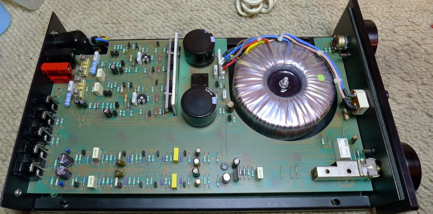

Hello! I just bought an Onix OA20/2, and I am having some issues. Switching between various inputs heeds various results. Hissing, buzzing, static, imbalances, no output from one or both speakers, it's ugly. Working on circuitry related problems is something I'm almost completely new to, so I was dumbfounded when the issue first came to my attention. It's been recommended that I replace the silver contacts on the input selector, which I'm inclined to do, but I'm faced with the problem that I don't know what that means. There are a couple of black cylindrical pieces which are both corroded, so my guess is that that may be contributing to the amp's dysfunctional state. Any advice is appreciated, thanks!
The 'black cylindrical pieces' sound like the two reservoir capacitors. Corroded ? or glue ? which manufacturers use.

I've identified the black cylinders as pots, whatever that means. I am undoubtedly under-qualified, but I'm also extremely stingy. I think that with proper instruction, I can do it. I hope someone out there will find it in their heart to hold my hand so that this can be achieved. I don't think anyone in their right mind would do that though, so yeah, I'm probably screwed.
Pot = potentiometer... the variable controls such as volume, balance etc. These can become crackly and noisy and while cleaning is an option, the best fix is to replace.
Before any of this though, you need to pin point where the problems are.
Edit... If it looks like this then the two large objects in the middle of the board are the main power supply reservoir capacitors. The volume control appears to be a normal carbon type component. The mains switch is of a type that can fail causing arcing/overheating which would certainly cause massive interference.

From the pictures I can find, and the description of the problem, I would say the input selector switch is dirty. On the picture Mooly posted, that is the component bottom right which the input select knob is connected to.
Get some contact cleaner and squirt some into the holes in the switch, then turn the selector knob back and forth a few times to distribute it. See if this clears up the problem.

You still have a problem to solve, whether or not Onix will offer advice. I'm inclined to agree with jaycee about the selector switch, because I had my fill of those flat cable and gear driven types of slide switches - long ago. The linkages in the mechanisms gradually wear or bend out of correct alignment between the knob setting and actual contact position. That also results in bad contacts and noisy operation but it can degenerate even further into difficult operation, perhaps a missing channel or the knob just becomes a wheel of random selection.
Often, a contact cleaner spray improves performance but not for long. At least trying it should tell you more about the problem and a logical fix. Just hope any necessary replacement parts are still actually available. Switch assemblies tend to be non-stocked items, even if common rotary types.
