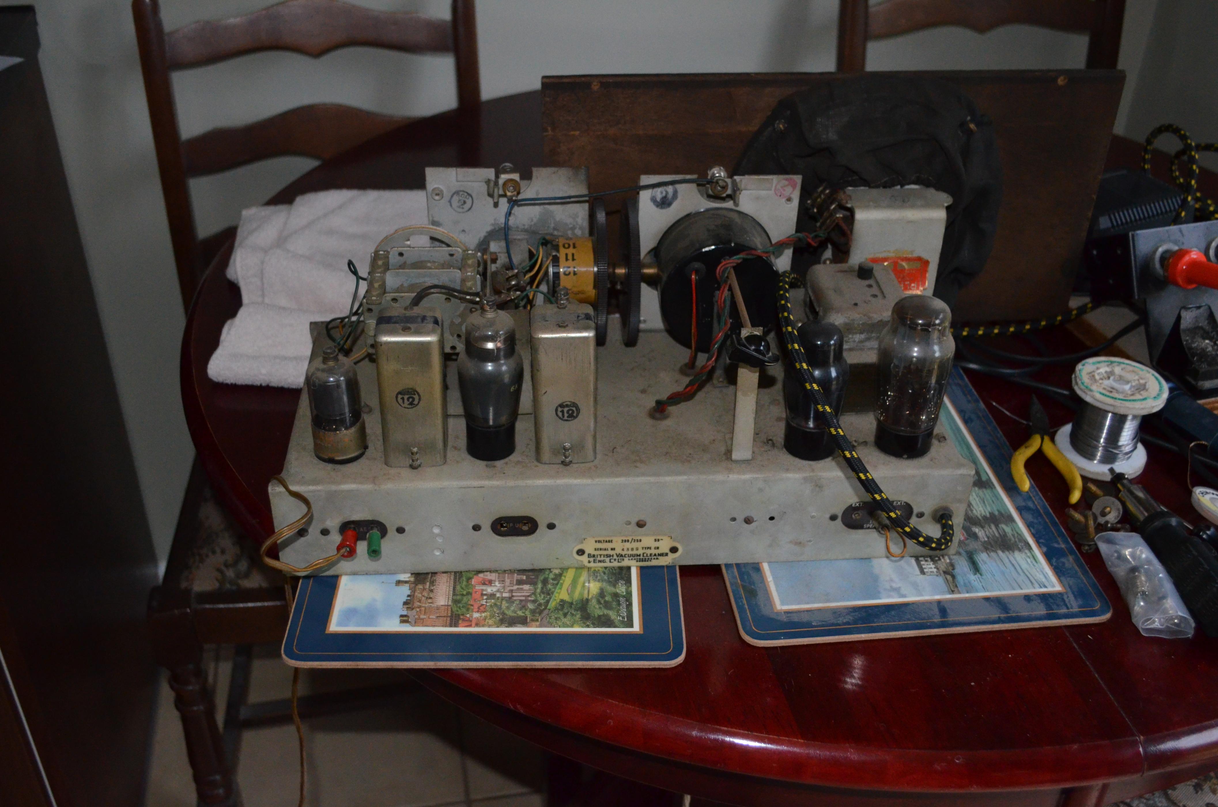

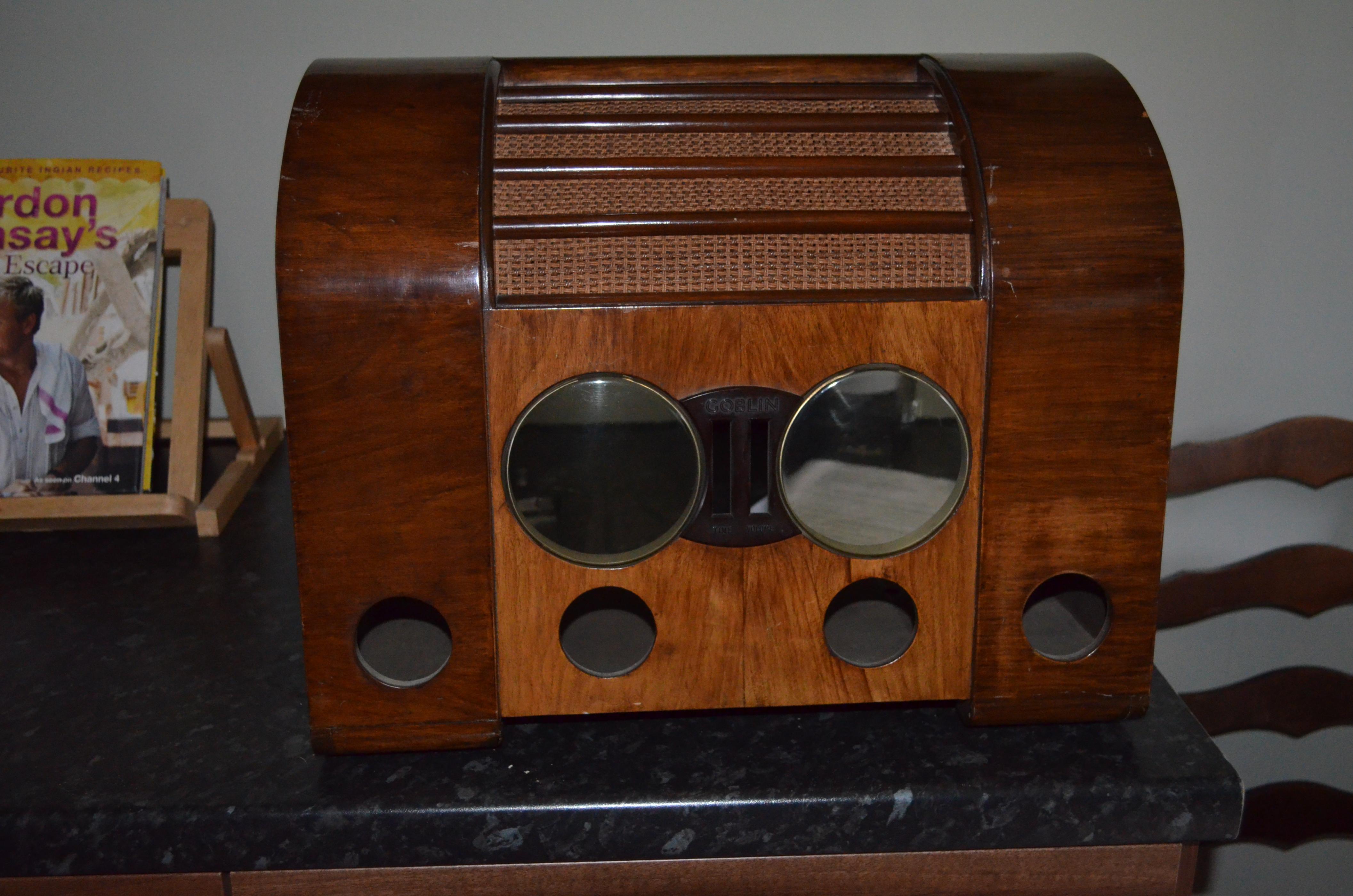

I've just landed this Goblin clock radio for restoration.

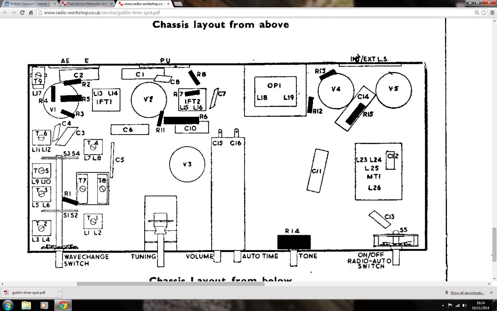

Anyone got any idea where to find a schematic for it ?
There are three PIO caps which look very wet and a cap that looks as though its been wrapped in bandaid. With no idea what value they should be I'm a bit lost.
Having difficulties with photos but this is the case.

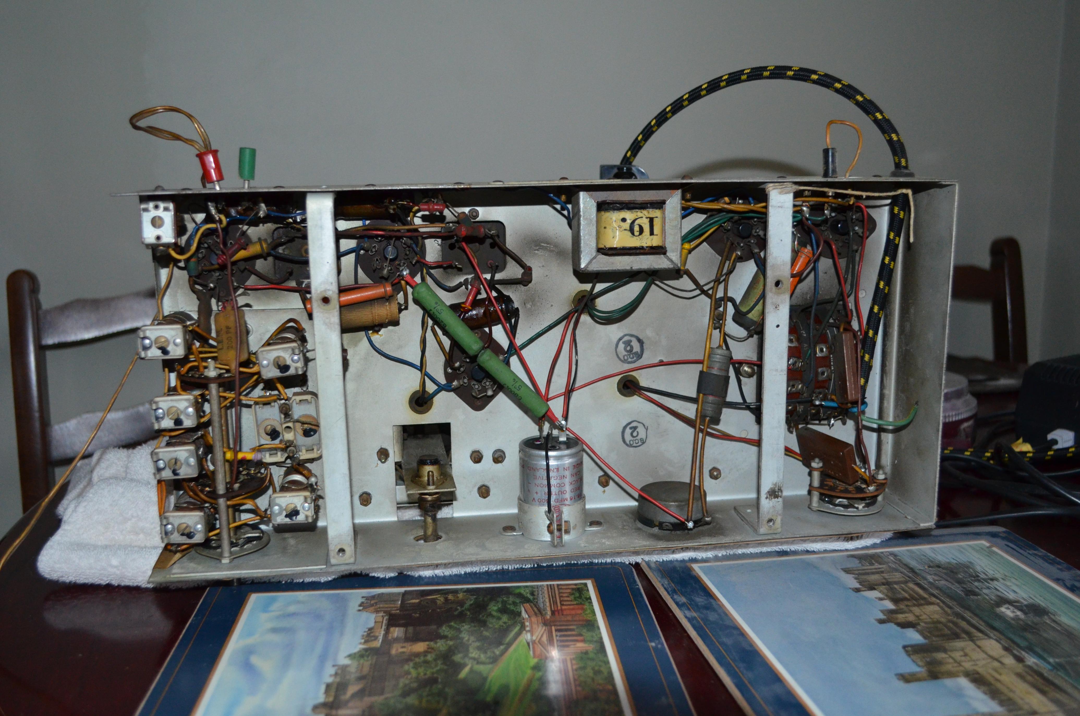

As I mentioned initially the immediate visual damage is three PIO caps, one funny looking WW1 badage and a broken Earth connection.
Promisingly the speaker hums quietly but with no signal content.

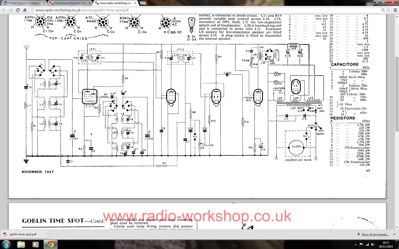

I can't see the Mains Earth connection on the cct diagram. Obviously it is required for safety but could that be why the tuner isn't working ?
Too dark and beer time to play with it now. I'll replace the caps and connect the mains earth in the morning.
I've figured out where the Earth core of the mains cable should be connected. It was connected to the shield connection on the mains transformer.
Unfortunately the aerial connectors on the rear panel are shot. I might just make a permanent connection to them rather than trying to substitute modern 4mm connectors.
I'm still in the dark as to how you can use the PU input. Surely any radio noise will break through.
Yes, it will break through. You tune to a quiet spot on the dial to minimise it.
It is designed for a crystal pickup, not a magnetic one. You should be able to connect an MP3 player (running on battery) to the PU input, the levels will be reasonably compatible and the low impedance of the headphone output of the player will effectively short out any noise from the radio section.
