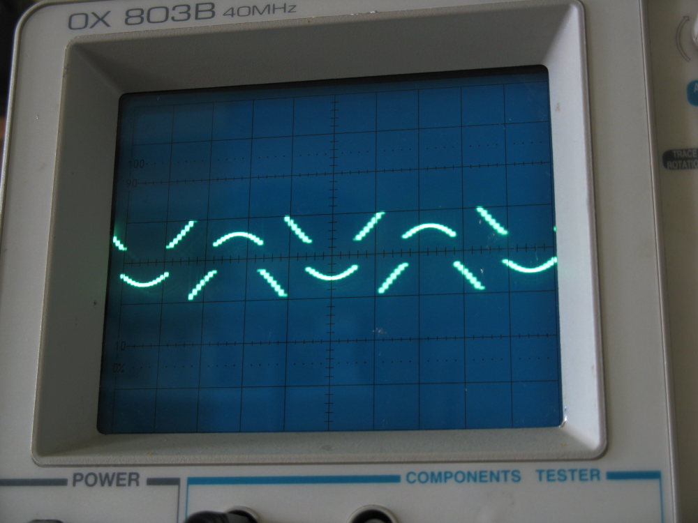

I assembled everything on a pcb one late night a few days ago but there is a problem. When I tried it out I got sound but it sounds HORRIBLE. Some kind of extreme distorsion. The DAC has 2 voltage output ranges but I am 100% sure I am using the 2.56V range. I have also connected a potentiometer between mu covox and amplifier just to make sure its not input distorsion in my amp.
I think the problem might be that the DAC does not have a symmetrical voltage output but wouldnt that be the case also with just resistors on the printer port??? Any good ideas where I should start?
What's wrong with this picture
Did some more measurements today and something is VERY weird. I tried to reverse all 8 bits bit that made it even worse :S Any ideas what I should do?

Solved the problem late last night. As it turns out I had connected the 7th bit to the input of the 8th bit, and the 8th bit was not connected at all. Discovered the problem with a software that allowed be to turn on and of every bit individually. Now it works great and plays music the way it should. Ahhhh how I miss the good old days.
