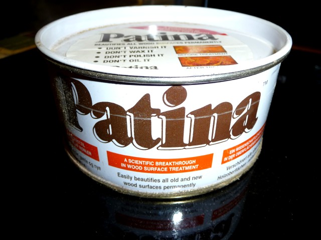

Hi
It sounds a little bit like Patina. I used this on a dining room table I made a few years ago. It has a gel like consistency, is really easy to apply and produces a semi gloss finish. I decided against using this product because it develops a slightly orange colour. Its a good product.
Richard

If the Patina product is as its name suggests then its target it to attain a patina finish, that is, antique. A deep luster only years of aging and polishing over that time will bring. Premature aging if you will.
Cabots Danish oil is just an oil product with a hardening compound added to give a more durable finish to the timber. It's wet whereas you say patina is gel-like, which also gives the impression its aim is a 'patina' finish.
