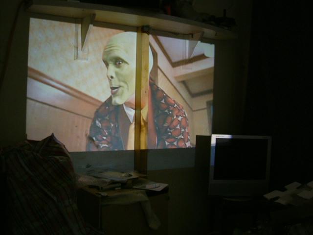

Hey guys its been a while.
I have put together a projector by using an old ohp and a seven inch lcd. The screen is white blackout cloth.
The problem i am having is there is a white haze over the picture blacks are grey etc.
Ive adjusted all the settings on the lcd itself no effect, so im starting to think its my screen. Is there a cheap fix to this????

Tilt the lcd and the projection lens,so you still have good focus,in the horizontal plane,one side or the other depenting on how the lcd is positioned .This should work.What happens is that the low quality lcd screen has no strong backlight etc and polarizing filters are placed in such an angle that do not block a lot of light,so the screen is brighter but with bad contrast,which in these type of lcd screens often happens.
Have a look at the drawing i uploaded,probably it will explain things better than my poor english.

1. Let the opposite side of the LCD panel (the side which face the backlight before you dismantled the lcd) face the projecting lens will solve the problem markedly, but you need to remove the reflecting mirror to get correct image on the screen.
2. Use a gray-colored screen. A gray-colored screen will raise the contrast markedly, and darken the black area of the picture. Or you can use a silver-colored material as your screen so you gain the contrast without losing brightness.
By using the combination of the above mentioned 2 modifications, I think more than 90% of the haze over the picture will disappear.
There are a lot of grey wallpaper,grey curtain in China store. The metallic grey like the color of the steel works very good. I am using a steel grey wallpaper, and I will never use any white screen or white wall anymore.
I think aluminum foil covered by tracing paper (the translucent paper) will be much better, but too bright for the light bulb you are using.
