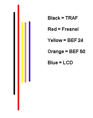

I am still not sure if this stuff is going to work or not. I started to play with the TRAF a bit today.. with mixed luck. It appears that it brightens the image a bit, but not that much. The BEF seems to make a difference but my eyes are tired from looking into the light too many times.
With the light turned on I layed a piece of TRAF behind the LCD, then I slowly slid BEF behind that and I could easily see the image getting brighter... by not covering the entire LCD I could see before and after results. However when I placed a fresnel between the TRAF and the LCD it appeared darker. Not sure how that works.
Once it gets darker outside and I my eyes readjust to normal light I am going to try some more things. Here is what I think SHOULD work... I'm not entirely sure though. My thoughts about this are simple. If the TRAF MUST be behind the frensel or it will cause the light that is supposed to be directed inward to be directed straight, eliminating the effectiveness of the lens. The BEF 24 and 50 are ordered in that way because the datasheet says that that will give the most brightness with the least viewing angle.. which is exactly what we want I think. I'm not sure though, have not tested it yet.

OK, I've pretty much confirmed that these film's are useless with the standard Metal Halide lamp set up. They are specifically designed to have a reflector directly behind them like in a typical lcd monitor or laptop screen. So without some sort of lightguide in my setup, they won't help at all. Oh well, they didn't cost me anything 🙂
