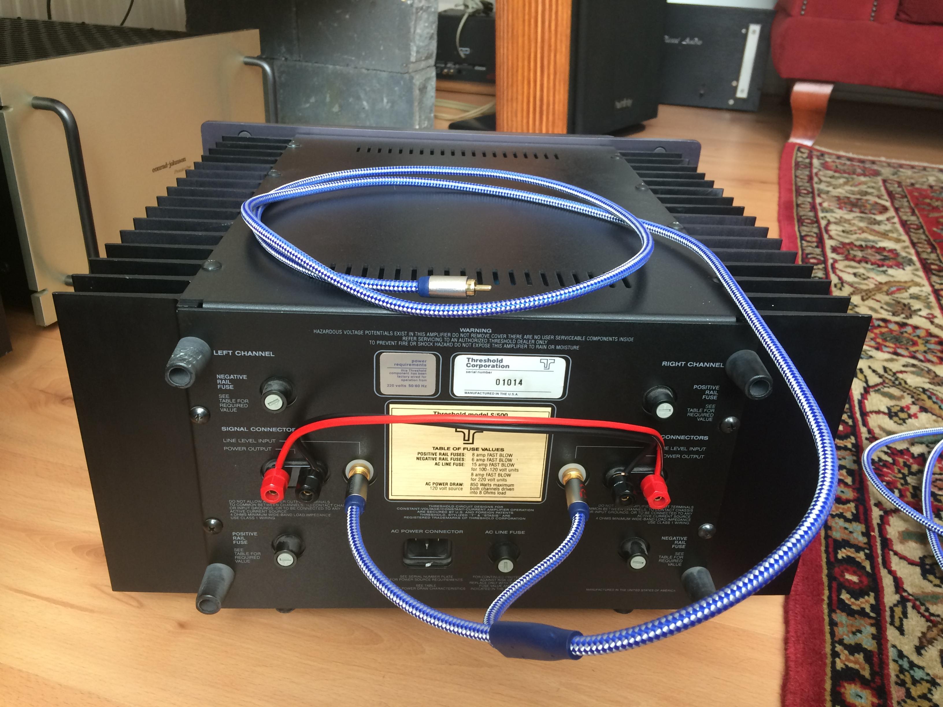

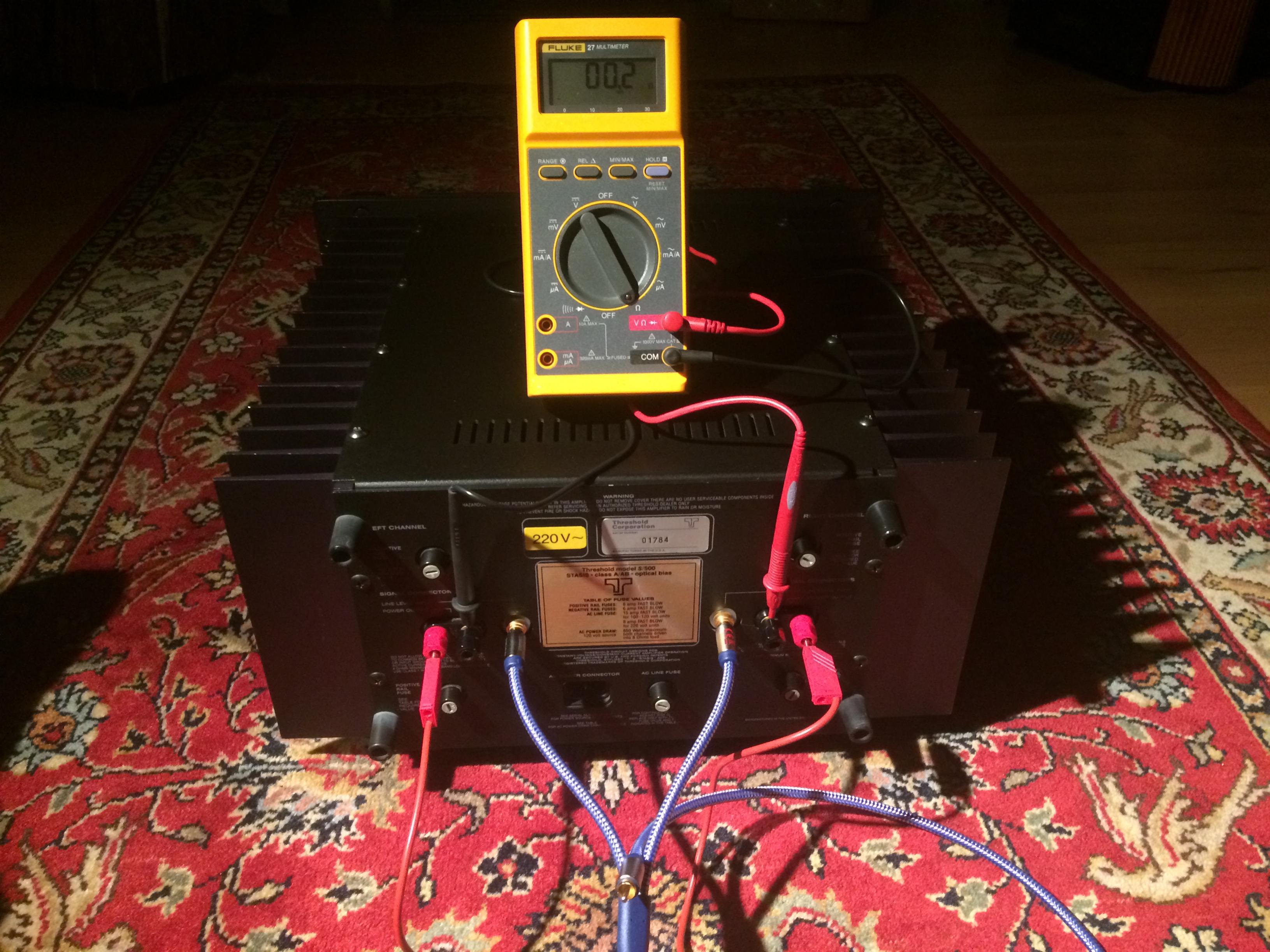

Just got two Y RCA cables and I wonder if this is the way how to configure the Threshold S/500 into a mono-block:
https://www.diyaudio.com/forums/attachment.php?attachmentid=983843&stc=1&d=1631827510

I see RCA Y cable clearly, and that's it
if red cable connecting two red binding posts is one wire/dead short, that's it
now just connect speaker to any side, red binding post is positive, black binding post is negative

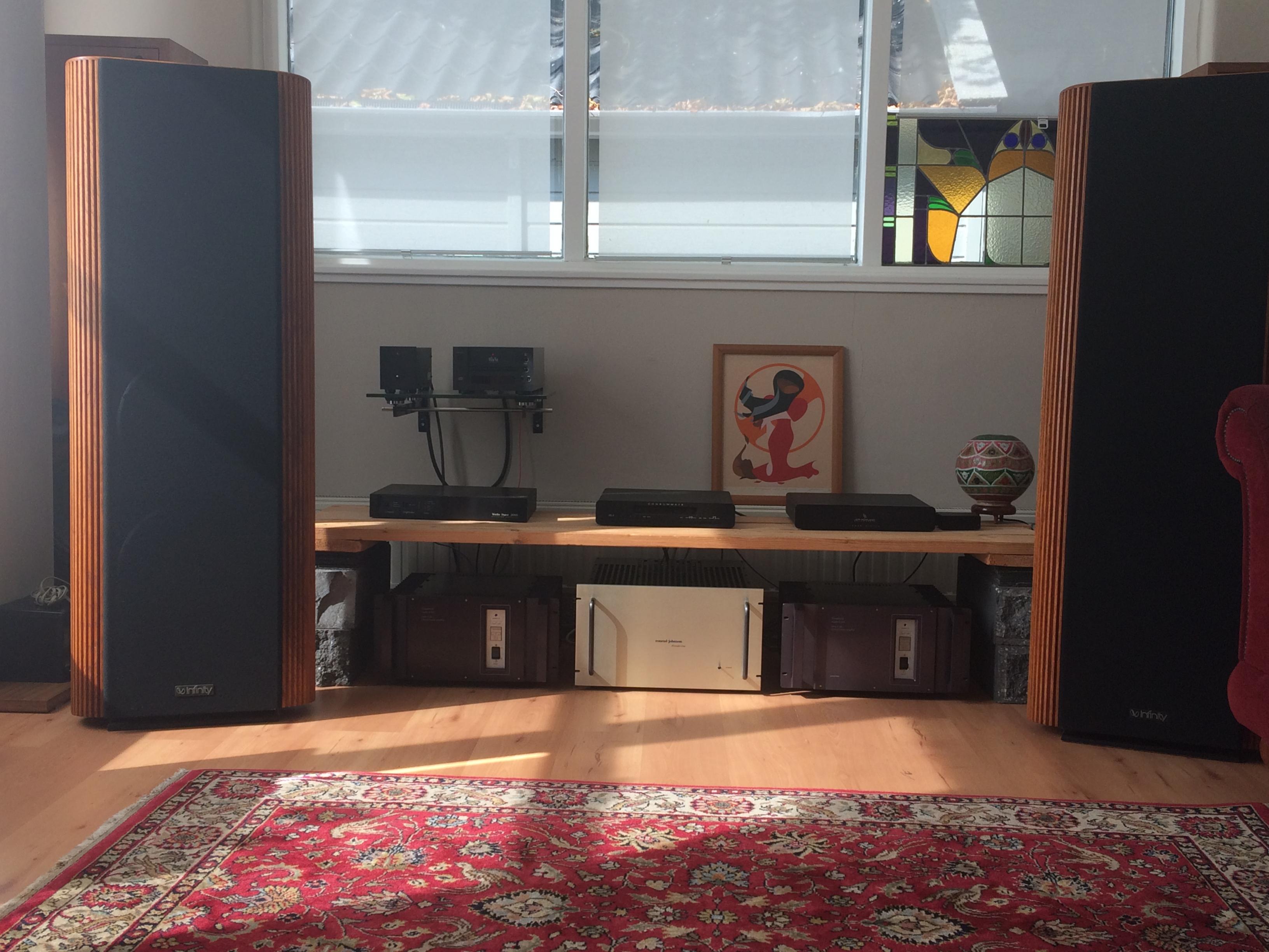

Done!
Was a bit afraid to turn the first S/500 on, but I have two mono blocks now thanks to you guys!
https://www.diyaudio.com/forums/attachment.php?attachmentid=983991&stc=1&d=1631881945
https://www.diyaudio.com/forums/attachment.php?attachmentid=983992&stc=1&d=1631881945
So it's still the same 250 Watts at 8 Ohms but now with more current into lower loads (Kappa 9A dual woofers in extended mode) and lower output impedance.
Maybe there are also negative points (twice the cost ;-)).
Thanks again for your great help converting my S/500's in a kind of SA/1's without the meters and 160 Watts Class A.

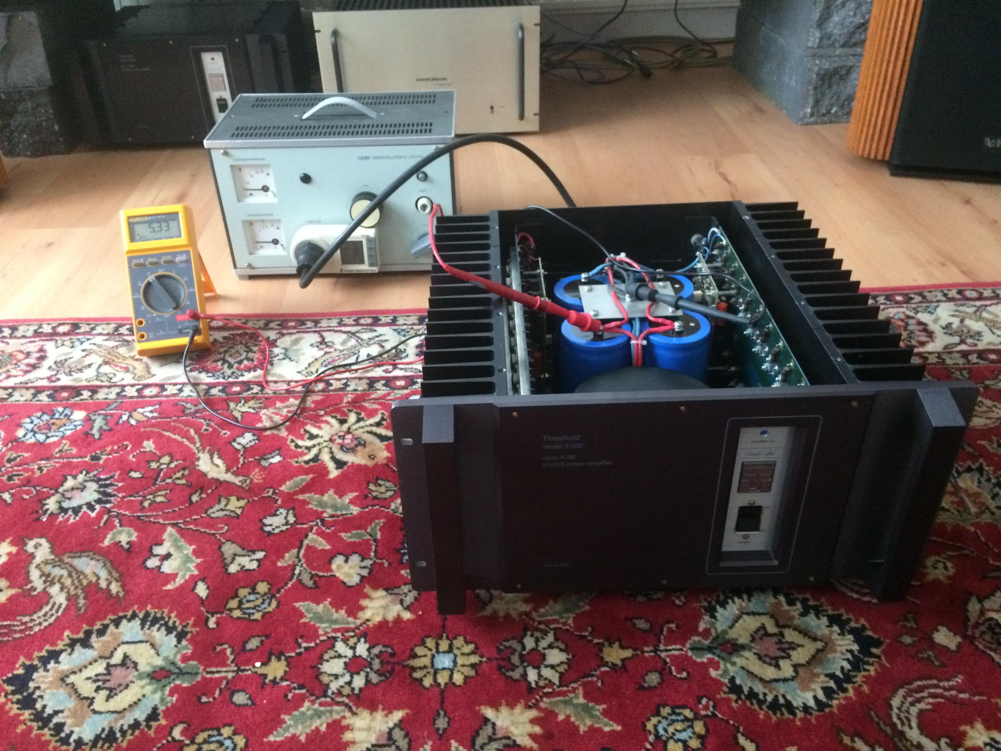

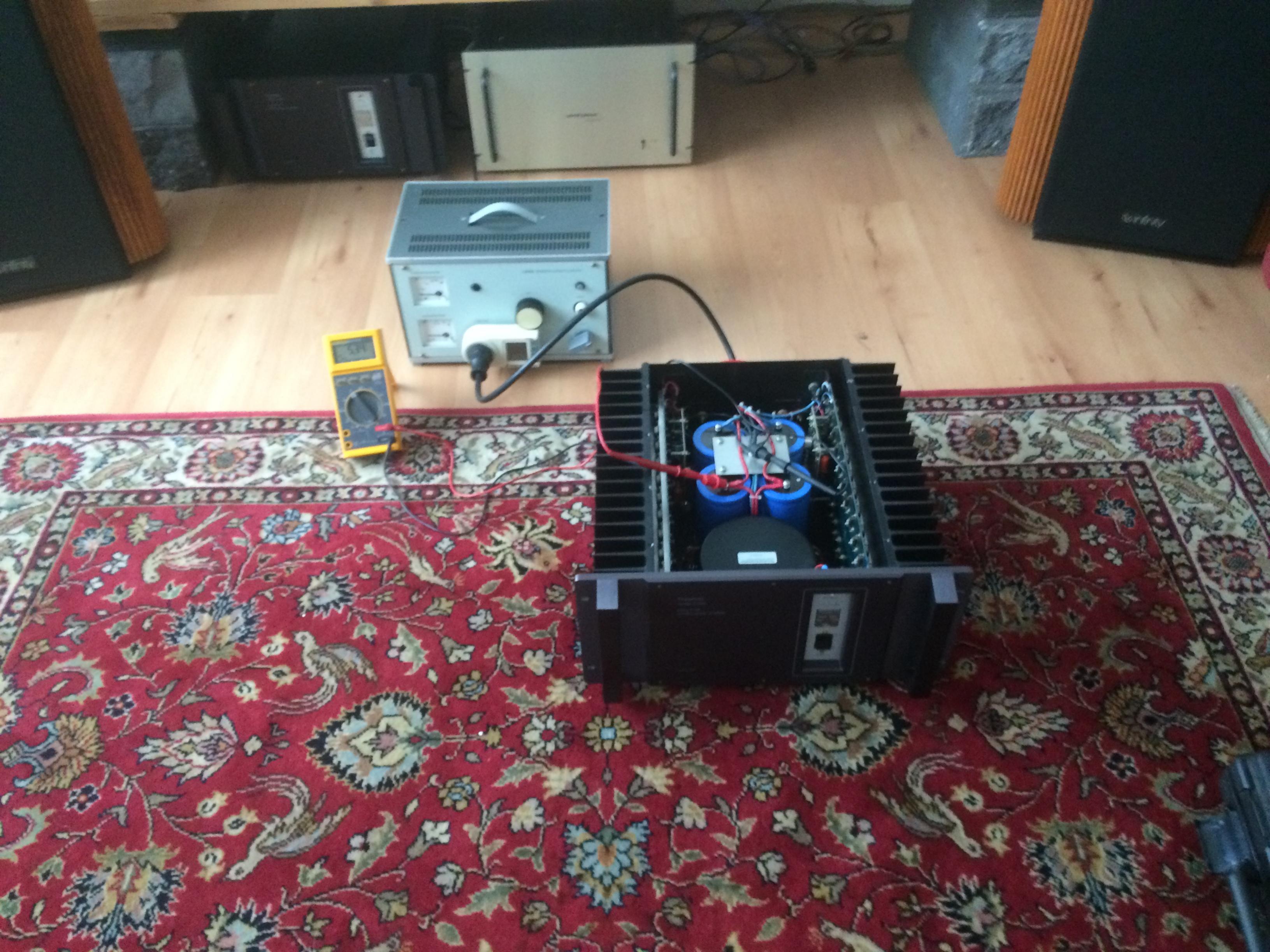

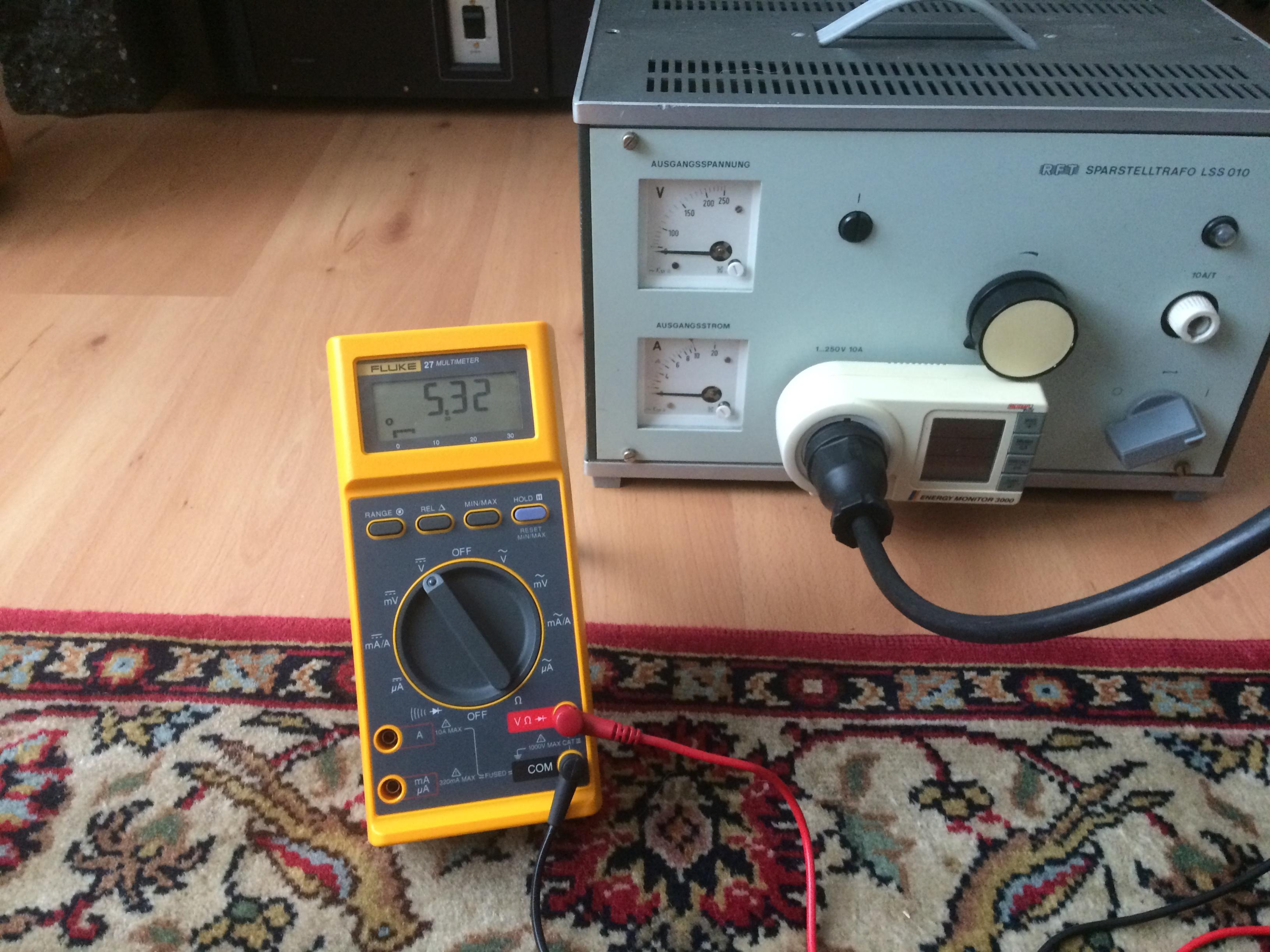

Reforming new powesupply capacitors
Should I decide to put in 4 new (one set is two years old on a shelf) powersupply caps per amplifier, could I reform those power caps to place them in the circuit of the Threshold and very slowly with the use of a Variac with a Volt- and Ampmeter inside reform the by turning the AC voltage up let say 5 Volt per 5 minutes? Thresholds have no softstart circuit and/or relays in their powersupply.
best to bring them to life prior to installing them in amp
when I have ( and I have ) caps laying in box for long time, I just connect them with 100K resistor in series to DC voltage source , voltage close or equal to their rating, and leave them for few days that way
after checking of voltage , I just short them with same resistor and leave for few days that way

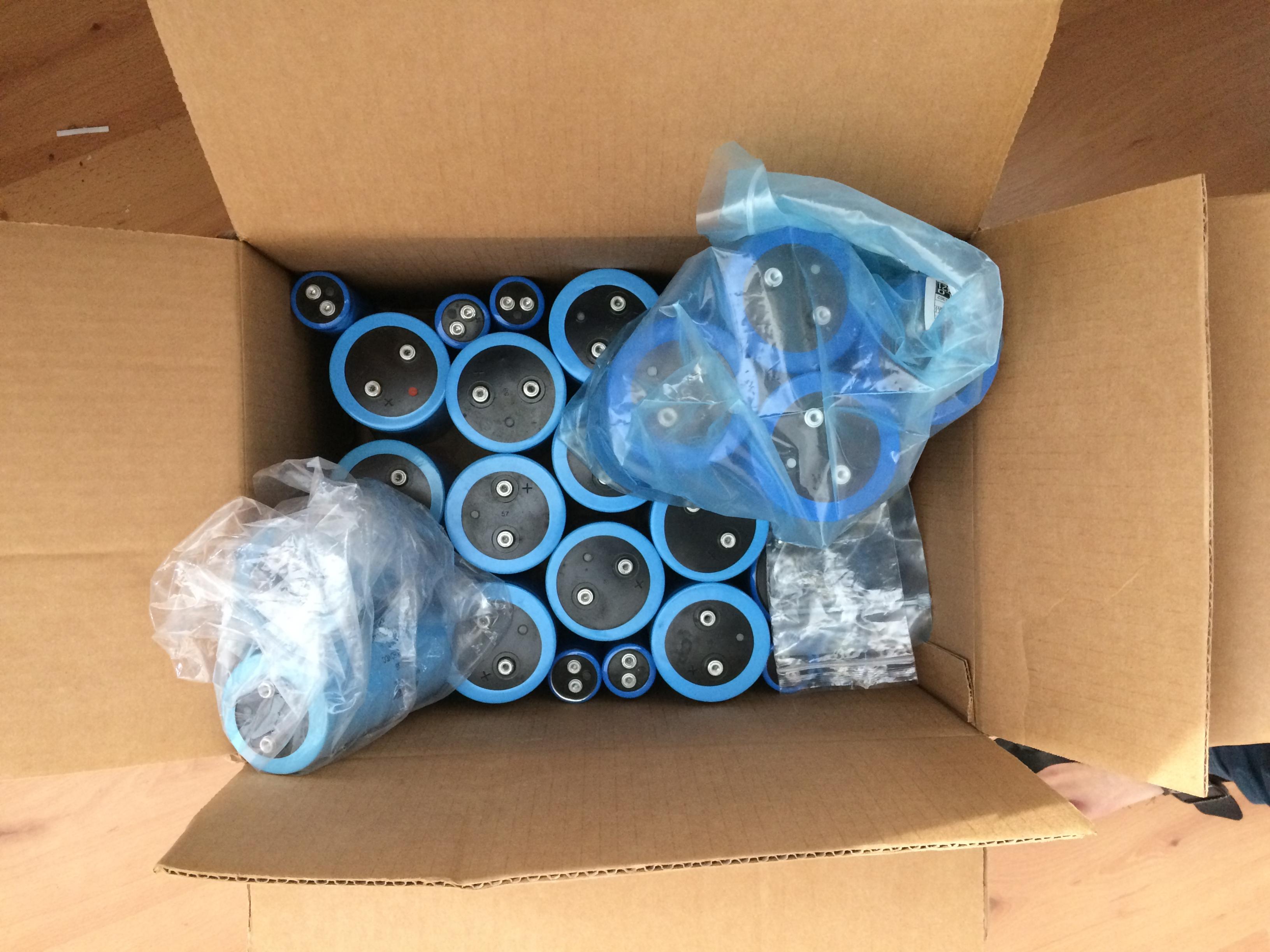

The only DC Voltage source I have are the power supplies of my amplifiers it self.
And they are not filtered yet after the diode bridges of course.
I bought four caps new from Mouser and I have four of the same caps on a shelf which I bought two years ago.
I have a Fluke Multimeter a PEAK ESR70 ESR meter a capacitance meter, a 20A Variac and a Tektronix scope and a box of big caps with the newest ones in a plastic bag on top:
https://www.diyaudio.com/forums/attachment.php?attachmentid=984484&stc=1&d=1632050234
Does the type of resistor (carbon, wirewound metalfilm) or wattage any difference?

current through 100K resistor is so small that wattage is irrelevant
for DC source, well, improvise ......
