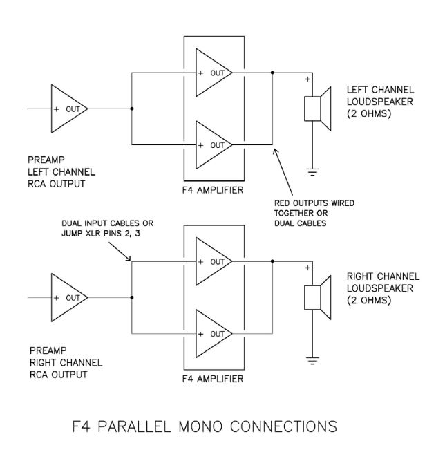

F4 Manual text about mono-parallel configuration:
Mono Parallel Operation
In mono parallel operation, you can achieve up to 100 watts output into a 2 ohm
load.
The amplifier is driven by a single-ended source, through the two RCA inputs
in parallel. The easiest way to do this is through a male RCA cable going into one of
the RCA inputs with a jumper between pins 2 and 3 of the XLR input connector, which
parallels the two inputs. This jumper is supplied with the amplifier.
(No XLR on my S/500)
If you look carefully at the connector you will see tiny labels next to the pin holes.
For parallel operation of the two channels as one, you must connect the outputs left
positive to right positive either at the connectors themselves or by “bi-wiring” the
loudspeaker with two sets of cables. Remember that the positive outputs have a red
band.
The black banded output connectors are already connected together to ground, so you
can make this connection externally or not as you please.

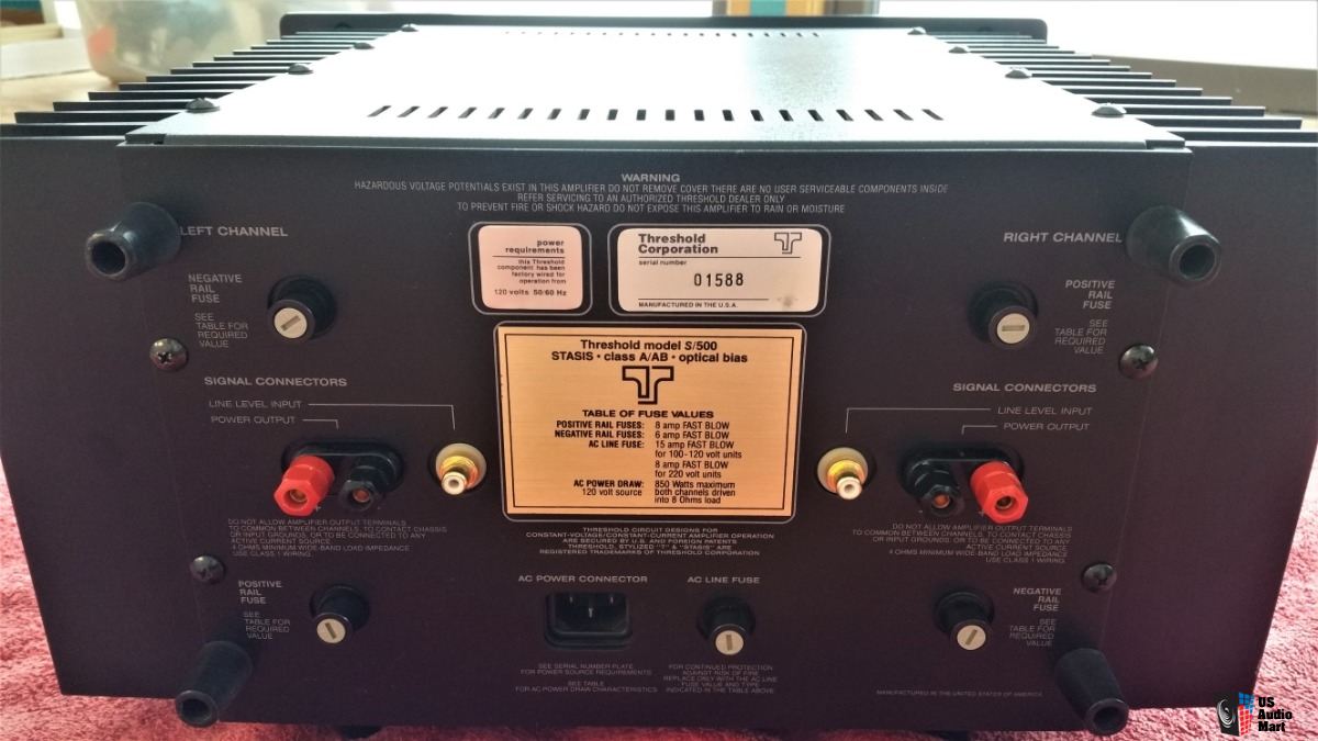

I'm very bad with schematics so I present the back of a Threshold S/500 and can you point me out how I should connect the pre-amp and the loudspeaker to get a mono-parallel configuration?
I'm sorry for my stupidity but that's how I am in this matter.
It's not mine but the same:

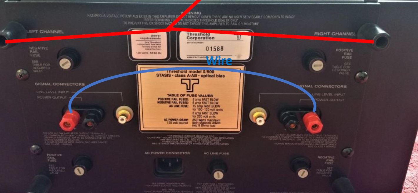

Y RCA to RCA cable
Y end to both RCA inputs on amp, sole RCA cable end to preamp RCA output
speaker neg to GND output on amp ( both GNDs are anyway connected - check with ohmmeter; if you don't have one, just put fat wire bridge between two Neg/Black outputs on amp)
fat wire bridge between two Pos/Red outputs on amp
speaker Pos to any of Pos?Red output on amp
that's mono parallel

Y RCA to RCA cable
Which inputs? RIGHT - RIGHT or RIGHT - LEFT?
Speaker black terminal to amplifier black terminal? I will check ground with MM
Okay that's clear

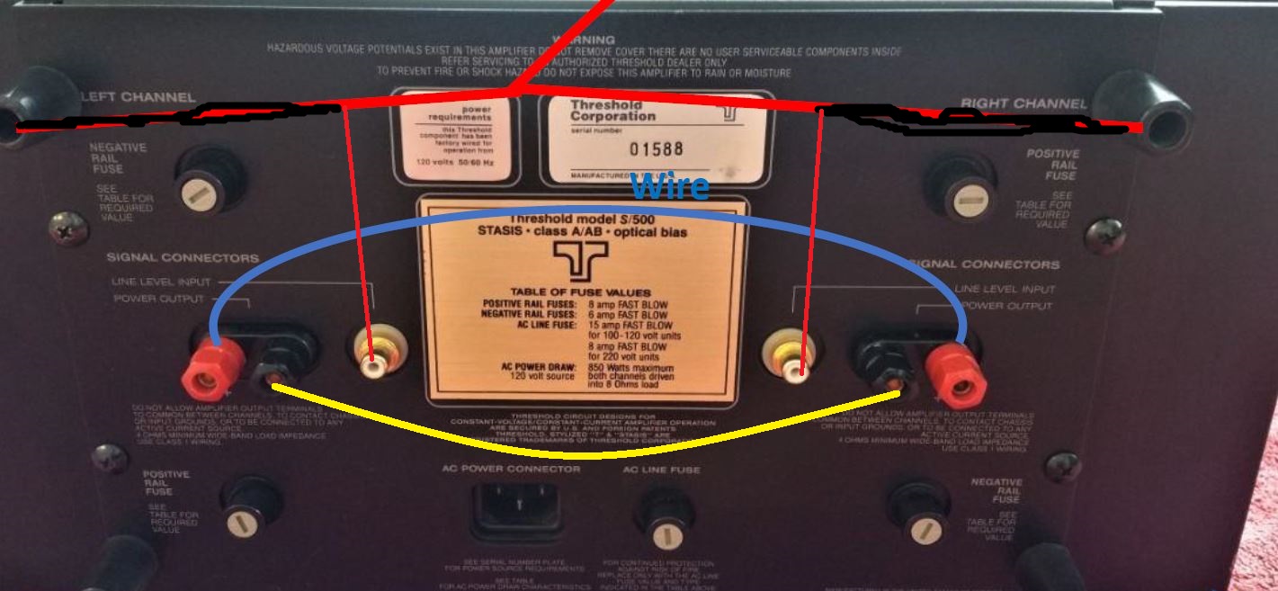

Like this. See attached for one amp.
L channel from pre => Y cable. Y goes to both left and right inputs on amp 1. Left Amp
R channel from pre => Y cable. Y goes to both left and right inputs on amp 2. Right Amp
Hook one speaker to each amp. Hook (+) speaker to either Red amp binding post and speaker (-) to either Black amp binding post.

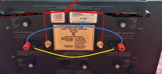

1. Speaker cone moves in and out based on the difference in the potential from the (+) to the (-) terminal. Generally, if the (+) terminal is more positive than the (-) terminal, then the cone moves outward... and the inverse is true for inward.
2. What I thought you were saying in post #1 was to hook the (+) and (-) of the speaker to both red binding posts. Perhaps I misinterpreted, but even so, it's a good illustration of why it won't make music.
See attached for a few things I had put together for my own understanding a few months ago along with an added pic of what I thought you were describing in post #1. Hope it helps with the technical understanding. Also fixed the wiring from the Y. 😀 😀
Cheers
A very kind person on the forum made it "click" for me one day, so I'll try to convey how they explained it to me.
