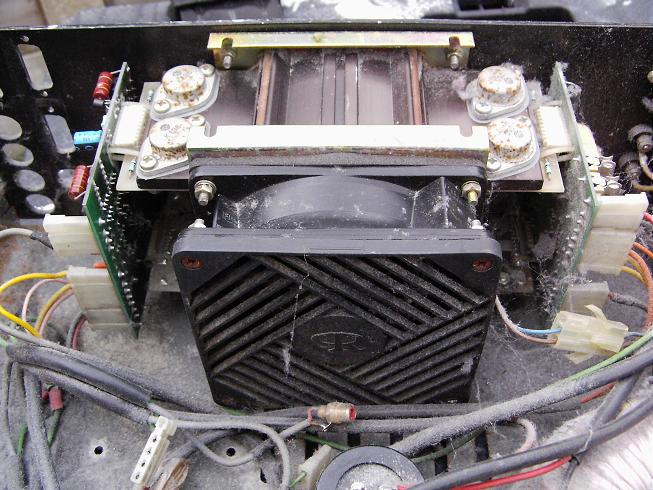

This describes a Hafler DH500, a commercial 400W/4R amplifier. It had a large fan-cooled tunnel, and still ran quite warm. Later they bumped it to four pair per channel (XL-600).
The XL-280 used three pair of the J50/K135 on a lower voltage to do 400W in bridge mode (time may be thermally limited to several minutes). About ±50V would be right for 400W/4R in bridge mode.

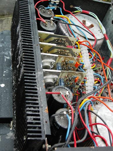

MikeHunt79 said:
VERY interested. Do you have any more info or pics? .
Hi.
This photo may give you an idea of heatsinking for the Maplin modules. The bridging units are on the RHS x2.
[This was the mid-range stereo amp for a disco]
Andy
Thanks for the pics... they are worth more than 100 words. 🙂 Do you know if either of these amps are 2 ohms stable? Or have any more info or specs? I'd basically like to do a 1 channel version of this amp, with 1 pair of modules, instead of a 2 channel one with 4 modules. I'm guessing it does around 300w per channel?
I've got heatsink around the same size as that, but the fins are twice as long, so I'm sure I shuold be fine heatwise. It's good to see what the professionals are using tho. 😉

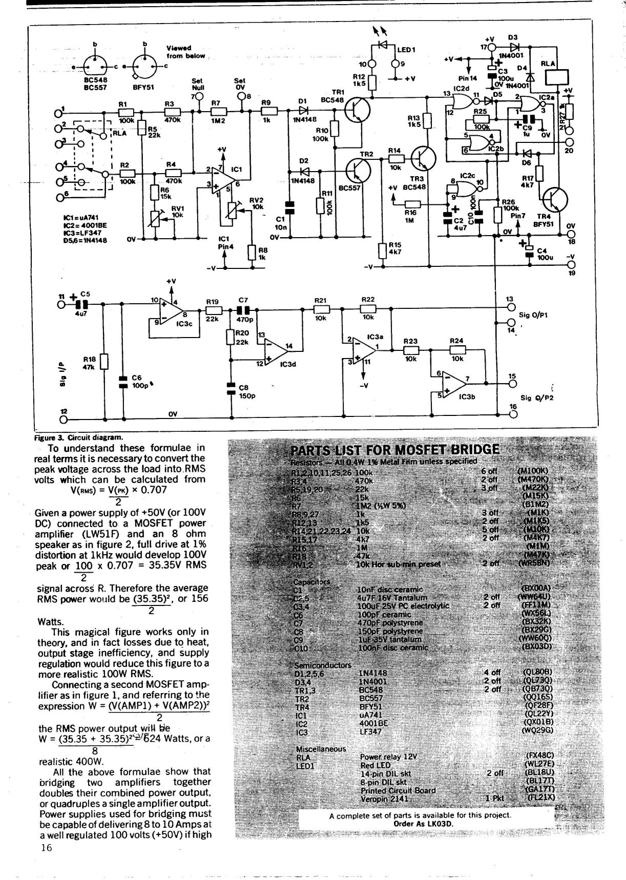

Thanks, Anthony. I'm aware of numerous balancing buffers that should do the task well (and transformers). I asked because I wondered how Dave Goodman (Maplin amp's designer) would've done it, i.e. whether it'd be a balanced buffer out of typical IC apps. data, or idiosyncratic.
Justin

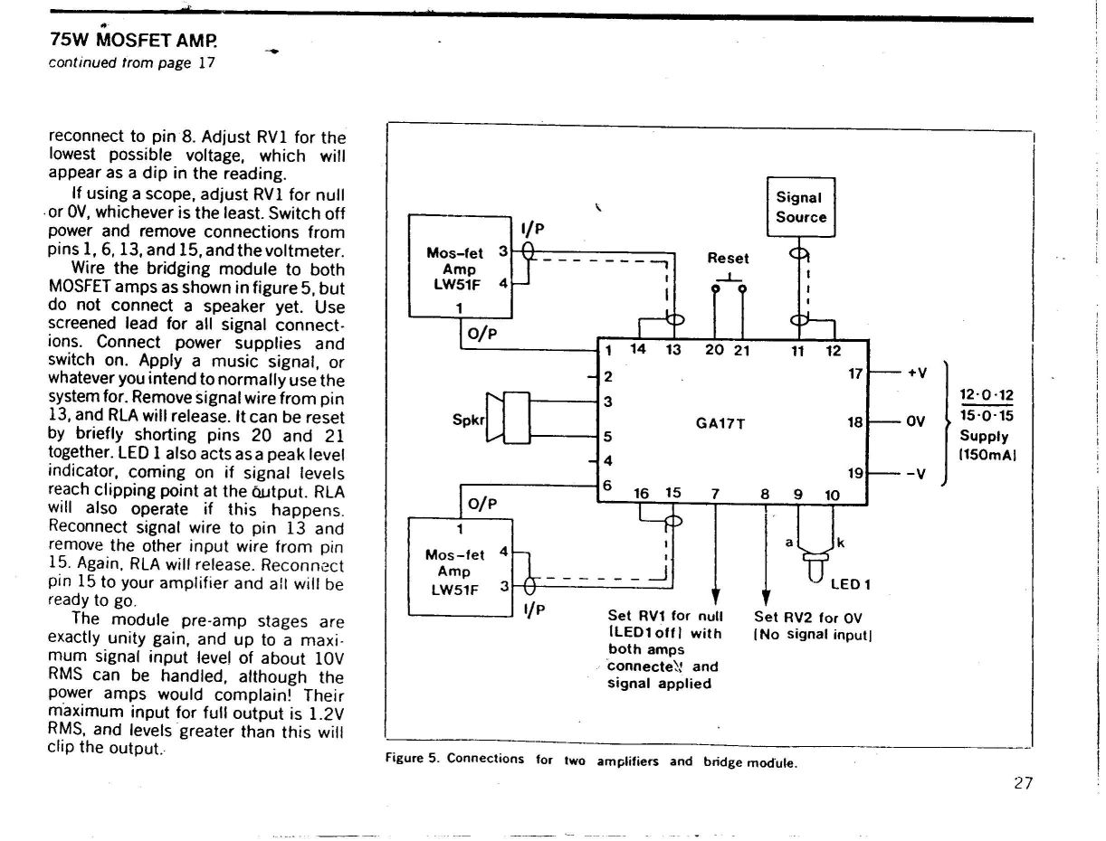

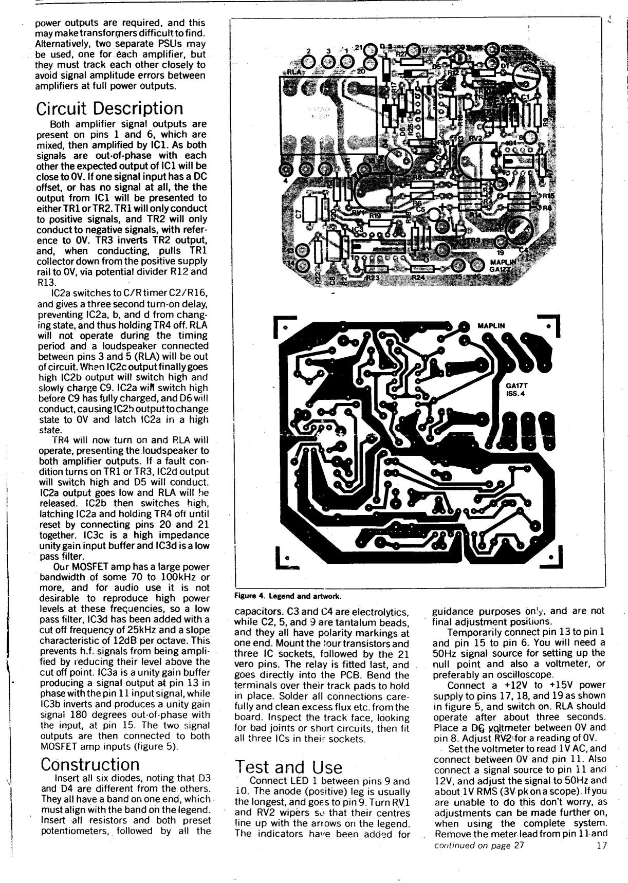

Thanks for the offer, Anthony, but save yourself the bother - another member gave me the documentation. See attachments.
Justin
