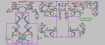

Hello all,
It seems that bridging Class-D amplifiers is on the list of several members here.
There are some posts where members have said that the amplifier works well as a mono channel but in bridge mode it does not work as well.
White papers on UCD also mention that there are no patents on the bridge topology as it is a complex subject.
I thought of an old fashioned approach that could sort things out...and if it does, will help in a lot of a applications.
What if we employ an HF transformer at the output stage and follow that with the LPF?
Transformer output will do two things: 1. Impedance matching 2. Isolation
Unlike linear amplifiers, the output transformer can be small in Class-D topology.
Not only will the isolated output ease bridging but the output voltage can be adjusted to give 100/70V line in applications that require it.
I am not an expert in power switching or magnetics and so would like to invite the members here to give an opinion. I hope that I have not missed anything obvious, if so, my apologies in advance.

One very obvious error in your thought. Class D is a rail to rail switching PWM amplifier. A transformer will only see the rail to rail frequency and level that doesn't vary. The PWM will not cause any difference in the flux of the core and therefore will not transform any audio frequency modulation. If you wish to bridge the output from two amplifiers, ensure the frequencies are 100% locked to avoid distortion.
The perfect opposite is true. The PWM definitely changes the flux, since flux is the integral of the voltage. Flux changes so much that a small core will saturate.

Well, actually the interference caused by cross-coupling 2 ClassD amps has 2 forms: when frequencies are different, then it's whistling, and if the frequencies are locked, then noise and/or harmonic distortion. This is the real challenge in bridging 2 ClassD amps. The interference should be kept very low even without synchronisation, this way THD will also remain low when synchronised.

Theoretically I could eliminate it completely if I have a bridge amplifier operating on single supply of say 142Vdc. I then land up with an amplifier that should be able to deliver around 1250W/ 8E
I did a class D circuit in LTspice that uses just one amplifier to drive two outputs that it has . It drives them 180° out-of-phase.

So for high power (say 1250W/ 4E) Class-D amp with linear split supply, the 50/60Hz transformer cost, bulk and its utilization factor become critical.
Using a single supply helps the power supply transformer but I then need a bridge amplifier.

I wonder if you have any plans to take up to design a full-bridge single supply amplifier.
Could you kindly share the LTSpice/ block schematic?
Here's what I came up with, based on the famous UcD circuit. It's food for thought maybe at least.
