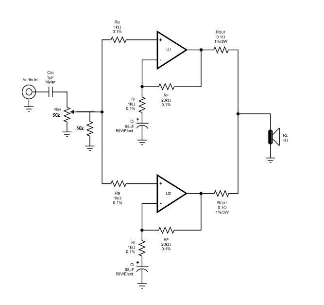

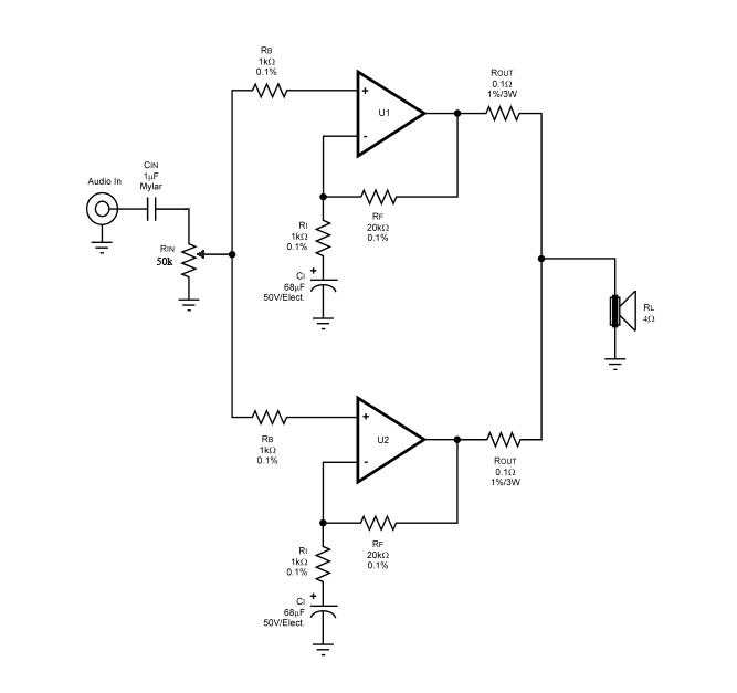

I have attatched some pics to show you the ways i would have configured it, please tell me which one is better?

both your posts show non-inverting topology.
Both show DC block on the NFB leg.
Both show DC coupling on the input.
The result is that the inputs of both amps see each others impedance and see the pot. The impedance of the pot varies with wiper position.
At the top, maximum volume, the amp input sees the source impedance in series with the DC blocking cap//potvalue//Zin (if fitted).
At the bottom, minimum volume, the amp sees the zero ohms (0r0) // all the others but they are effectively irrelevant.
At very near the middle, about -6db on volume, the amp input sees [potvalue/4]//Zin (if fitted).
The range of resistances seen by the non-inverting input of the amp is from 0r0 to 12k5 (for a 50k pot).
The inverting input sees 20k//1k+series cap.
The unbalanced resistances cause the input offset current to generate an input offset voltage, which also appears at the output as a DC output offset.
As you adjust the volume pot the output offset varies.
The way to cure this is to DC block the input after the pot. The amp then sees Zin//other amp input impedance.
The amp as shown has no RF filter on it's input. That 1k0 is crying out for you to fit a single pole RC filter there on each amp. You can choose anywhere between 220pF and 1.5nF and adjust until you hear the correct amount of treble for your ears and speakers.
Now that you have the filter in place, you will find that it's effect varies as the source impedance (not resistance) increases from zero. At zero volume or maximum volume, the filter is 1k0+C,
at -6db volume the filter is 12k5+1k0 =13k5+C. It has moved down the frequency range by a factor of 13.5 times. This is effectively a variable treble cut filter controlled by the passive pre pot position.
Select a pot <<20% of Zin to ameliorate the variable effect. For Zin~=50k I would try a 2k pot. This presents a maximum source impedance of 500ohms. The RF filter now varies from 1k0 to 1k5 +C. Much better.
Now, can your source drive 2k properly and still produce good quality sound?
