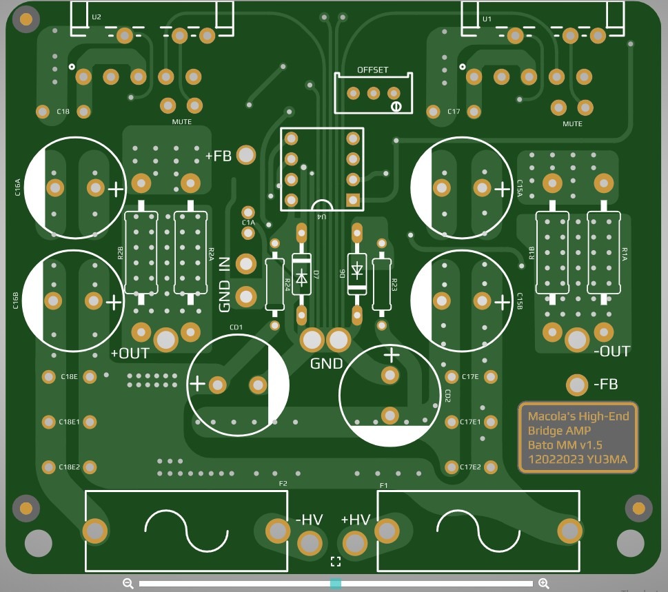

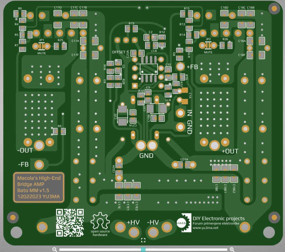

For those who looking for new version v1.5 it will be on git soon! I'm just finished new layout. Added some trought hole options including dip-8 socket, now you can solder TH, smd, or booth condensators, soic-8 opamp or dip-8, Scan qr code for link

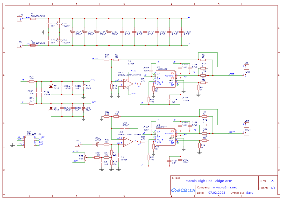

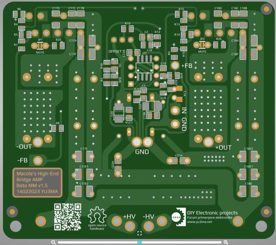

Seems Yu3ma is busy and not updated their github page but here is version 1.5 carefully designed, some components is trought hole and/or smd, your choice, for example opamp dip vs soic, your choice which one you going to solder, enjoy!
