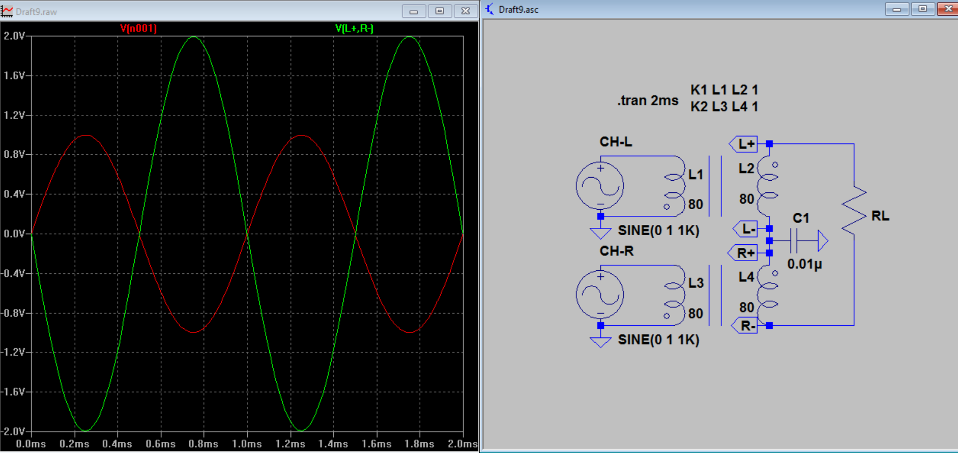

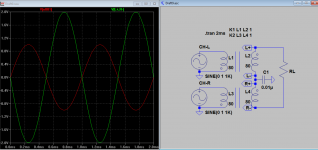

Like Jan said normally all you need is to invert the input signal of one of the channel. This can be done if you have a pre-amp with phase inverting output switch, so that Rch out will be (+) and Lch will be (-), you connect the speaker one to Rch+, the other to Lch+. Make sure that your amp is bridgeable.
But if you have floating output, you can have same effect like you say in "series", so that the output of one channel is reversed. Lch and Rch must have must have the same input signal (no inverting required then).

I know that it works in series because I've done it with the SE84. Will it work with any tube amp that I build as long as I feed it the same signal into both channels, and make sure that I build it with the outputs not grounded (floating)?
For technical point, it should work, but from safety point, better to ground the center point of output taps. Do you have gNFB disable also?

What tizman is actually asking is whether you can wire floating OT secondaries in series or parallel.
In series, no big deal; in parallel they must be exactly the same, and signal also exactly the same, although matching is not as critical as in SS amps, because a non NFB tube amp behaves like a constant current (or high internal impedance) source..

The proposed method of taking separate mono amps with floating secondaries and connecting them in series for more output will work as desired. The only thing that will interfere with this mode of operation is negative feedback.
If the individual amps have feedback paths coming from the secondary of the output transformer that tie directly to a stage further upstream, this requires a ground reference on the secondary to operate. The ground references between the two amps could fight each other, causing all manner of wrench in the works. To eliminate this possibility, negative feedback must be taken from the primary winding.
