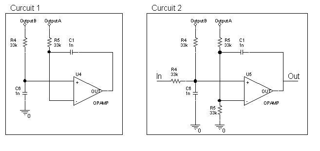

ehh..?
I'm sorry but I don't get it. Please see the attached picture.
Circuit 1 is a standard diff. int. but it cannot be used here without some modification. Curcuit 2 is my first idea, but I cant figure out if this is the right way to go?
The "OutputA" and "OutputB" are the feedback's from each side of the bridge before the LPF's.
If anyone could recommend literature about this topic I would be glad.
Regards
TroelsM
EDIT: I can't see the pic.. only a red cross? Can you see it?
Circuit 1 and 2
Regards
Troels
EDIT: The problem was a cookie I had blocked in IE. Which is it?

Re: Re: Re: Bridge with two self-osc ClassD amps?

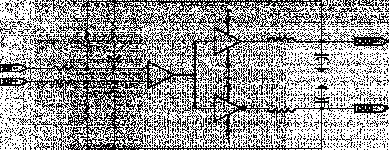

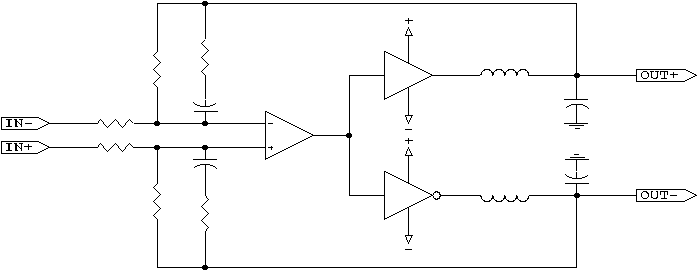

Is it possible to implement this BridgeUCD with the modulator (first triangle) only +/-5V fast comparator, while the input is only (+), (-) input is grounded? The grounded (-) input and the output feedback resistor will make a voltage divider that push the comparator more than +/-5V?

Then you will get the input voltage as a common-mode component on the output. You should drive this arrangement from two complementary ground-centered signals instead. The voltage requirements on comparator inputs will depend on the amount of carrier residuals involved.
You need a ground reference, preferably at the same RF potential as the ground planes, the case and the input and output wiring (otherwise you will have trouble as I had).
If by "triangle" you mean the comparator, you can use a +/-5V part if you adjust component values so that the carrier residual plus the input signal does not exceed +/-5V at the inputs.
The other part of your question is related to full bridge centering and differential inputs and is a bit harder to reply. Try imagining that the amplifier is linear and use your brain and op-amp theory a bit. In the circuit that you posted the common-mode input voltage becomes actually the center reference voltage for the outputs, and the differential input voltage becomes the output amplitude with respect to the center. If you want to reference the comparator to any other voltage, you have to provide a common-mode reference for output centering and ensure that the input voltage has no common-mode component...
BTW: You don't need to synchronize self-oscillating amplifiers, crosstalk does not follow the rules of clocked modulators, in my experience it appears as an increased noise floor when playing loud.
Hi, Phase_Accurate, EVA,
I should say making a "full bridge UCD" instead of "bridging 2 unit of UCD" 😀
The comparator I intend to use is LM360. They have complementary output, so I tought, why don't use both the outputs for full bridge UCD. This is where it started.
The first problem is this device is only +/-5V. With a normal (half bridge) UCD, this is not a problem at all, if we make inverting UCD, we ground the +input, so no problem using +/-5V device here. The -input will cannot go far from 0V.
But will full bridge like that, there's no insurance that +/-5V will be enough, because (+) and (-) input voltages cannot be predicted. (as long as it is assured that (+) and (-) input voltages always the same magnitude+180deg difference, there's no problem)
From UCDBP.pdf, I got that picture above. It's a theoritical diagram about how to make full bridge UCD with 1 main comparator.
This scheme is very interesting for me. It's similiar to SuSy, where any one sided disturbance will be disappear from loudspeaker's POV. It's different than bridging 2 modules.
I don't know how far more difficult this will be, than making half bridge UCD. Hypex don't make one commercial out of this is one clue (I assume the 400 or 700W version could be made with this scheme, yet they force to use mosfet >100V instead).
This is not a balanced input, it needs symmetrical input voltages to produce a centered output. However , you don't seem to understand that even when the input and ouput signals cancel the common-mode input voltage to the comparator, as in inverting arrangements, you still have to deal with carrier residual which has some amplitude too (the more the better noise margin). See the oscilloscope capture that I published in the other thread.
Isn't the differential voltages between (+) and (-) inputs are supposed tobe very little?
How can you control that with IC (8 pin comparator)?

No, the AC voltage between comparator inputs is a fraction of the carrier residual that appears at the output, 50% or so. This is what causes it to oscillate and work as a modulator.
