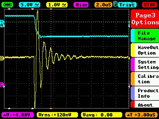

Warning: I bought the cheapest "oscilloscope" in the world ($16) and tried it with a transformer + Quasimodo. No worky. Its bandwidth (claimed 200 kHz) was too low and its triggering was too stupid, to properly display the transformer ringing. However I did also try the phony baloney experiment of increasing the DeviceUnderTest's inductance by a factor of ten thousand times, which reduced the oscillation frequency by sqrt(10000) = 100 times. Then: whoop dee doo, the little toy scope was able to display the waveforms. Here is my report.
If anyone is contemplating purchasing their first oscilloscope, just to use with Quasimodo, please don't buy anything with less than 5 to 10 MHz bandwidth. Me, I bought a battery powered, self contained (non-USB) scope just this week, and I paid $135 for 2 channels & 20 MHz bandwidth. This will be my fourth scope; my others have 300 & 400 MHz bandwidth, but they're not battery powered / handheld.

I used this one:
https://www.sainsmart.com/dev-boards/fpga-cpld/sainsmart-dso-note-ii-oscilloscope.html
Only 1MHz analog but has 2 channels for $80.
